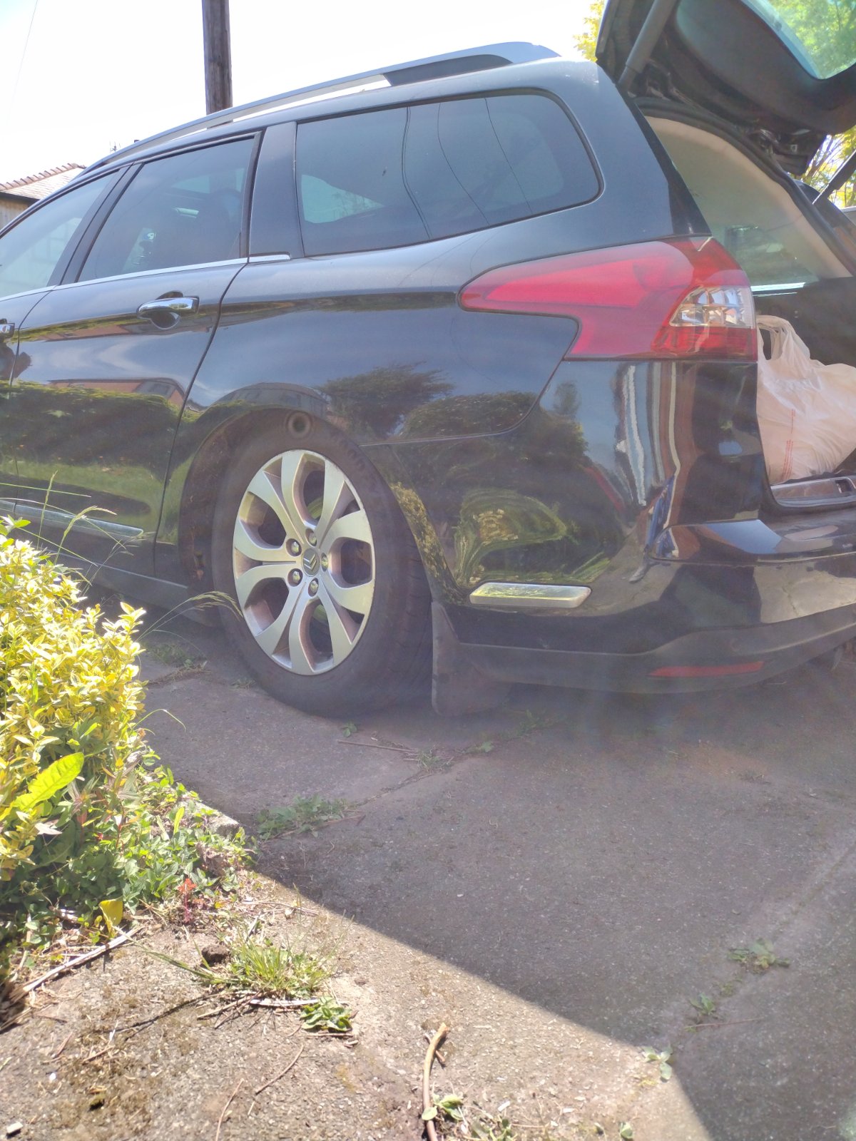

Gosh! Thank goodness for proper Citroen suspension
- Posts: 5311
- Joined: 25 Apr 2022, 09:03
- x 2343
Think I'll pause the car washing for the moment then!
