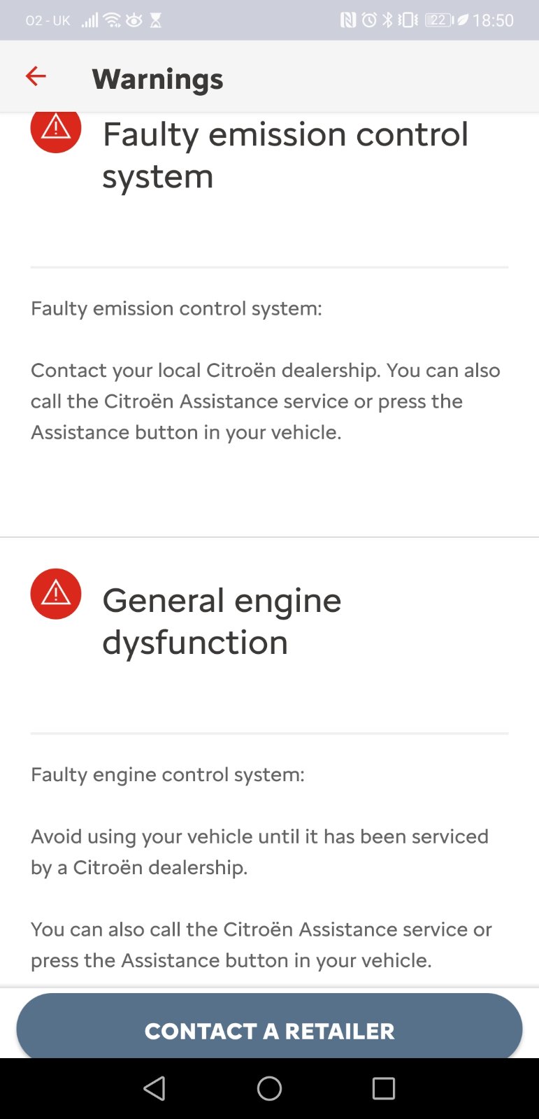

This morning car wasn't wanting to go in to eco mode at first, although the mpg seems a fair bit improved over the usual average. Maybe a 15% increase. However the dreaded 700 mile countdown has reared its ugly head on my dash.
Should the empty /refill option in diagbox reset the countdown in this instance?
