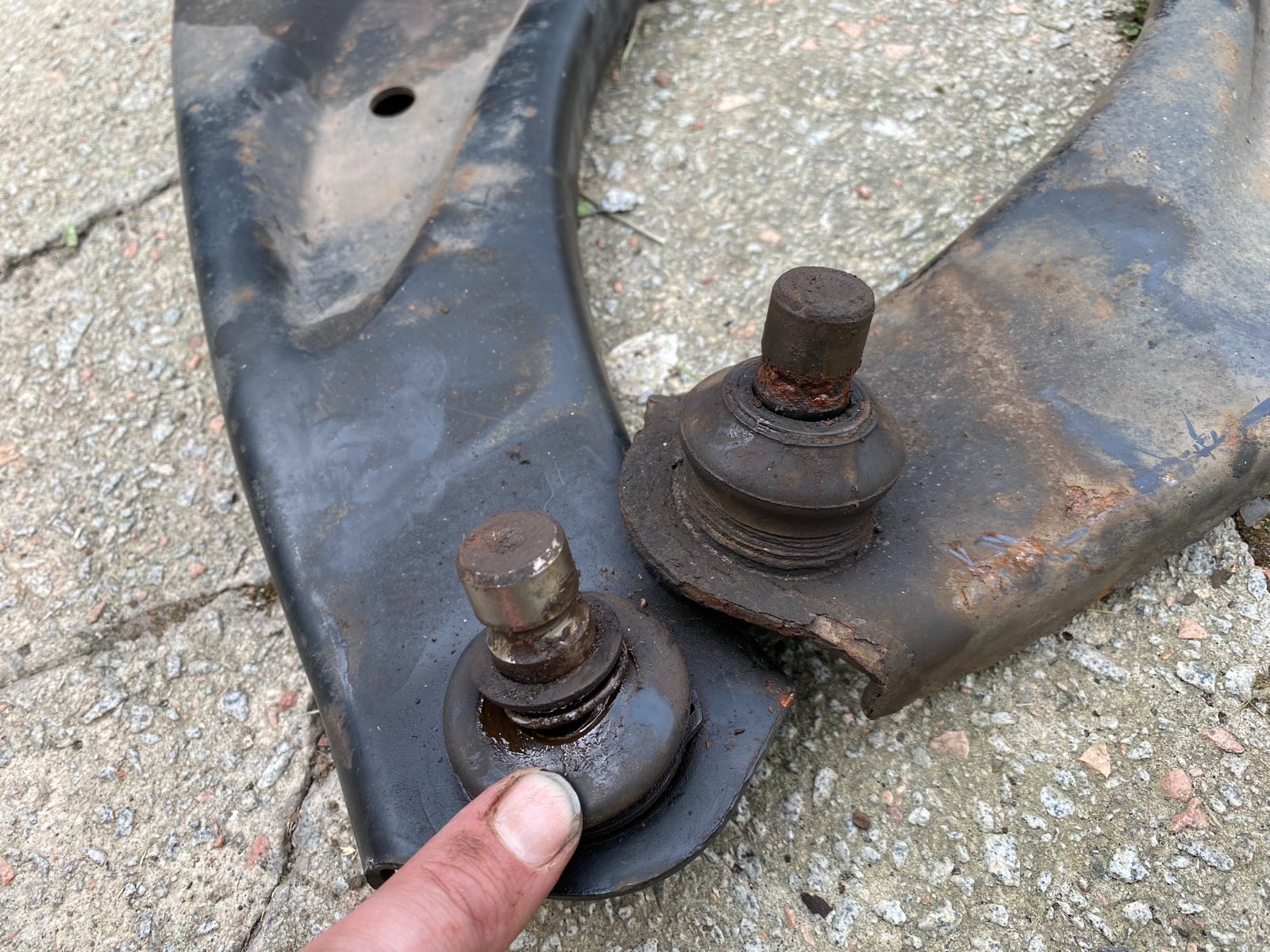

Out in the sun today replacing both lower front suspension arms on the Leaf.
Some of you will remember I already replaced the left hand arm a little over a year ago with a Delphi one, only for Nissan to point out back in February the ball joint has failed - well they were right...
The rubber boot for the ball joint has completely torn away around the top and the joint was full of water... seen on the left hand side here:
How would that have happened ? Is it possible I tore it slightly when fitting it, or is the rubber boot just of poor quality ? I notice it is a lot "flatter" boot than the original factory type (right hand in the picture) with not much ability to stretch.
Meanwhile the right hand arm - which was the original factory arm has something wrong with the rubber boot as well - it seems like there is a bit missing as there is no wire clip at the top or groove for one to sit in ? There is a gap between the boot and the pin that you can easily poke a small screw driver down so clearly not water tight either.
The rubber bushes (which Nissan said were failing) weren't as bad as I expected, although it is true they have somewhat delaminated, but the real cause of the creaking noises will have been a water damaged ball joint.
This time I bought slightly more expensive TRW arms and I have to say the ball joint boots fitted are of better quality and design than either the Nissan original ones or the Delphi one. The boot is a decent size allowing it to move quite a bit without risk of tearing, the rubber is thicker than the Delphi one, and it's a good clamped seal at the top unlike the Nissan one. The rubber bushes also look to be a bit sturdier on the TRW arms.
I was also extremely careful with the boots and did not remove the protective plastic covers until I was doing the final insertion of the pins into the hub and made sure the hub couldn't catch the boots - just in case I did damage the last one. Fingers crossed that this is a long lasting fix this time!
I ran out of time and energy to check the wheel alignment today - that will have to wait for next weekend, however I did notice an interesting change. Previously I had to hold the wheel a couple of degrees to the right to go straight ahead and I had assumed that was the track rod ends that needed adjusting...
However after replacing both arms the car now goes straight with the wheel held perfectly straight.
And it feels "tighter" and more stable at speed - not surprising when I just replaced two faulty ball joints that had quite a bit of slack, I suppose.
In fact the feel of driving the car is quite markedly better with the two new arms, it's surprising what an effect it has.
