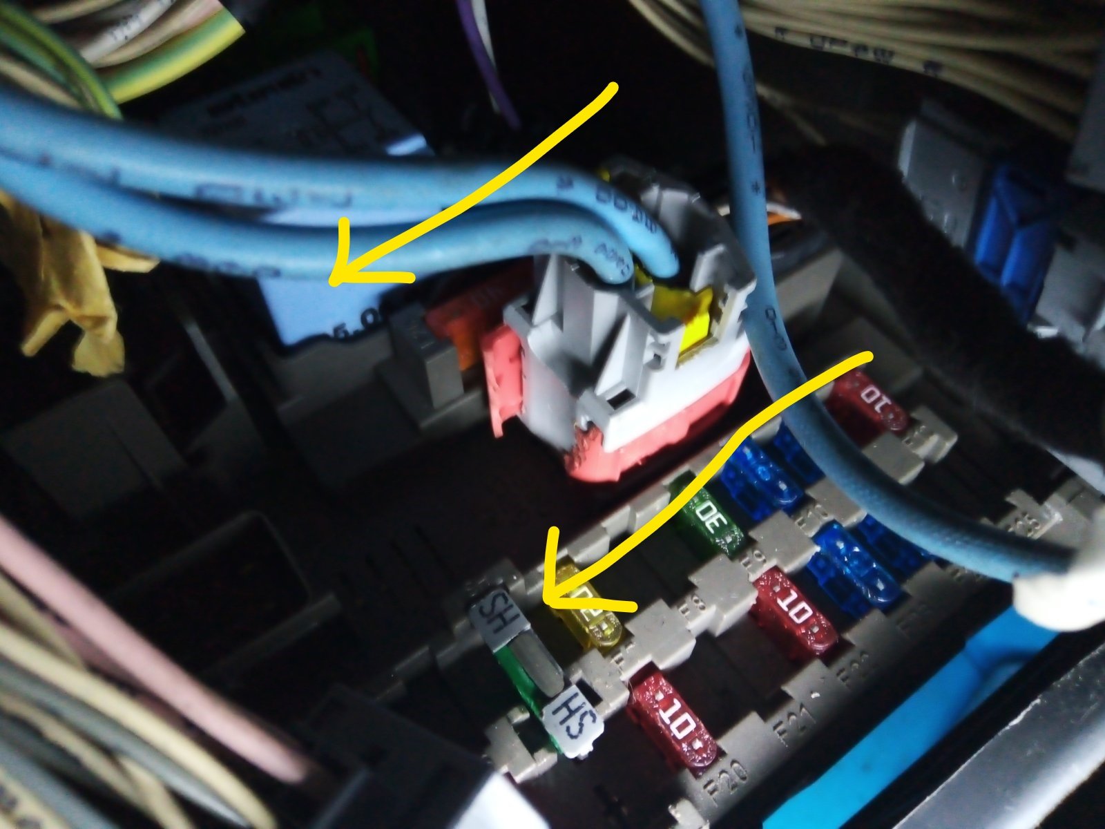

how do I release this connector?

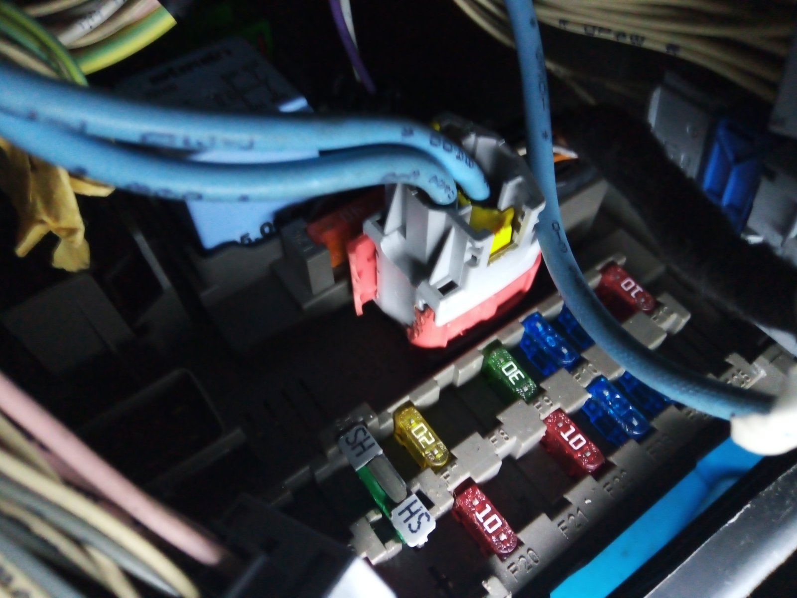

I've made a right balls up of this.. could someone tell me which way I'm supposed to slide the red bits..
I broke it..

Yes they can easily break if you go too hard on them. It slides in the direction of the arrows, the problem is you need to try to slide both bits at the same time to allow the connector to come off squarely.
