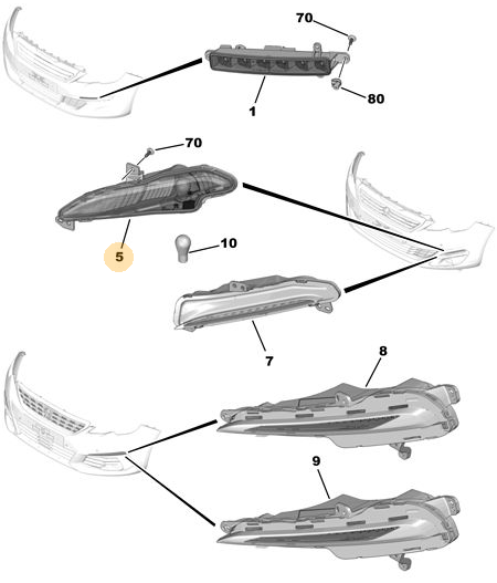

Re: 308 indicator bulbs 2014
Ok, so this is a 308 (T9) fitted with assembly (5):

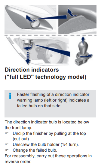

According to the handbook this is how they are changed:
Ceenine
Posts: 229
Joined: 17 Nov 2014, 20:21
x 17
Unread post by Ceenine »
Marc, that is amazing. I wish I could buy you a beer, …many actually.
I don’t need that extra packet of Band-Aid’s for my knuckles after all.
Don
x 6956
No worries - the bumper off is listed for the previous model (T7).
