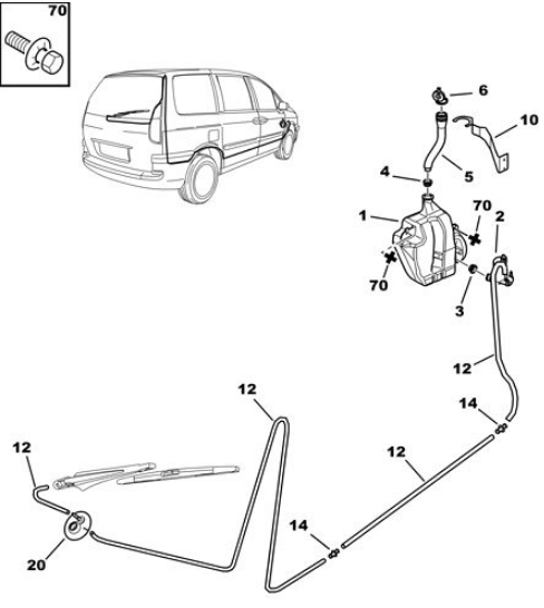

Morning all, I know I have been lurking, but that's because I'm a happy car owner!! (Touch wood!!)
I noticed a really strong smell of washer fluid when I went to clean the rear window of the car and thought there was a leak internally, however it appears the hose has split somewhere behind the front axle area of the underside of the car.
Is anyone able to direct me to blow out drawing of where it runs, so I can see if I can get my dad bod underneath and repair/replace the hose.
I assume I can just cut/splice the broken section?
Thanks 🙏

Which vehicle are we talking about Mark? If the 308, I'll need the VIN so I can pop up a diagram for you. I have the VIN for the 807.

Sorry Marc, the 807 👍

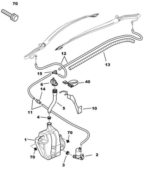

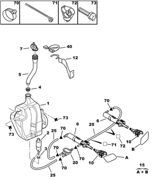

Here you go. Washer pipe is commonly available, as are fittings if you need to replace a section of pipe.

Thank you so much Marc, I'll get under the car this weekend and see if I can find the break and repair 👍
