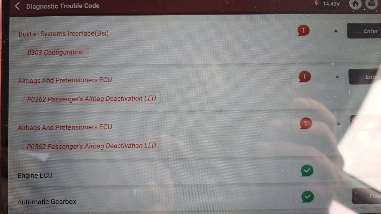

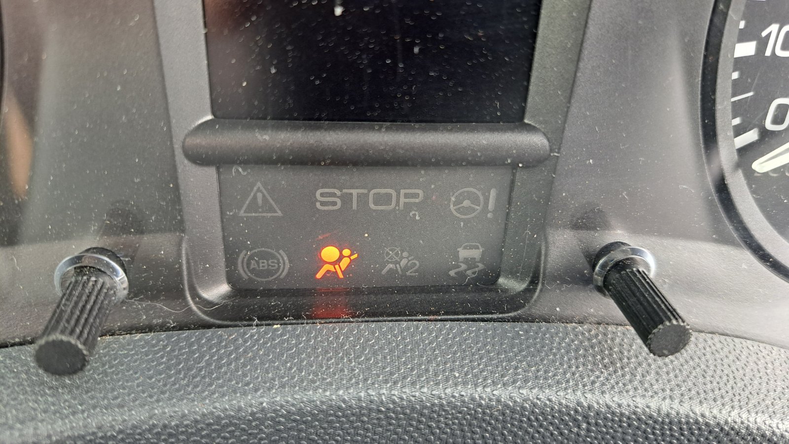

P0362 passengers air bag deactivation led
Hasn't got a passengers air bag
Expert 2.0d 2015 air bag led
- x 6957

Re: Expert 2.0d 2015 air bag led
Ok, so just confirmed you don't have a passenger airbag, nor side airbags on this configuration ( SHORT GLAZED VAN H1 TYPE 10).
The fault would suggest that the BSI is incorrectly configured or has been changed, as it's expecting a passenger airbag and it's not detecting one. The system self-checks when the vehicle ignition is switched on. So it looks like somebody has changed one or more settings in the BSI from the look of things. That warning lamp is usually lit when the passenger airbag is deactivated with the key or switch (as with a car when you are have fixed a child seat in the passenger seat), but we know you don't have one.
So I would be checking the BSI configuration to see what the airbag settings are showing.
I did have a look and the passengers air bag settings say it's disabled
Ok, so in this case, that warning lamp means
So looks like it will need further investigation before your MOT is due. Maybe quicker to get a dealer to look at it.If this warning lamp comes on in the instrument panel, accompanied by an audible signal and a message in the screen, contact a PEUGEOT dealer or a qualified workshop to have the system checked. The
airbags may no longer be deployed in the event of a serious impact.
