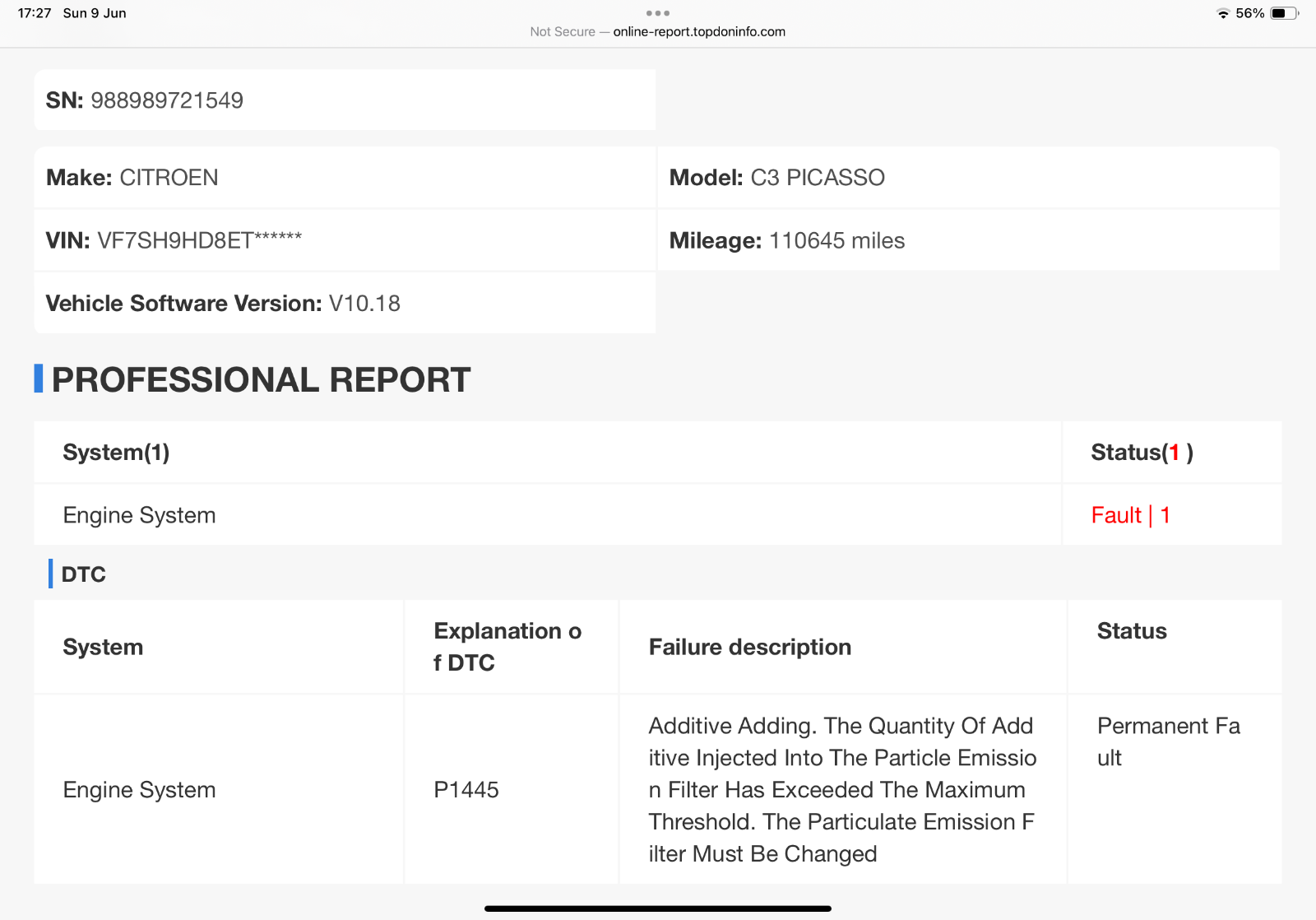

Hi All,
Ran a scan on the Dogmobile and got a new fault of P1445 on my Topdon ArtiDiag800BT as below:
Pretty sure this is a calculated DTC based on a countdown where the value has reached zero as per this YT video from O’Rileys Autos:
I managed to clear it through the maintenance and service functions on the Topdon after confirming the live data showed that the DPF differential pressure was <5mBar at tickover and didn’t go above 50mBar at around 3000 rpm.
So if you get this fault, hopefully this may help you.

It is a calculated value and is undertaken by the engine ECU, which records the dosing amounts of additive injected into the fuel tank over time. Because the additive contains a Cerine compound which cannot be burned off during regeneration, along with carbon and engine debris / ash, it calculates the amount of cerine that has been deposited. When it thinks the the pre-configured amount in grammes has been reached, it will flag the warning that the particle filter is at end of life.
At this stage the filter should be deep cleaned or replaced, then when the engine ECU has been told of the replacement, it will start all over again. So as your vehicle is at 110k miles, it will be getting pretty close to this point and that's likely why it has flagged the warning up.
As the DPF starts regenerating more quickly at lesser mileages, this may be because it is getting blocked more quickly. The differential pressure sensors monitor this as a safety check, but just be aware the that at 70% blockage, it becomes more difficult to regenerate, until it can no longer do so. You'll then get limp home mode activated at some point and further faults.
