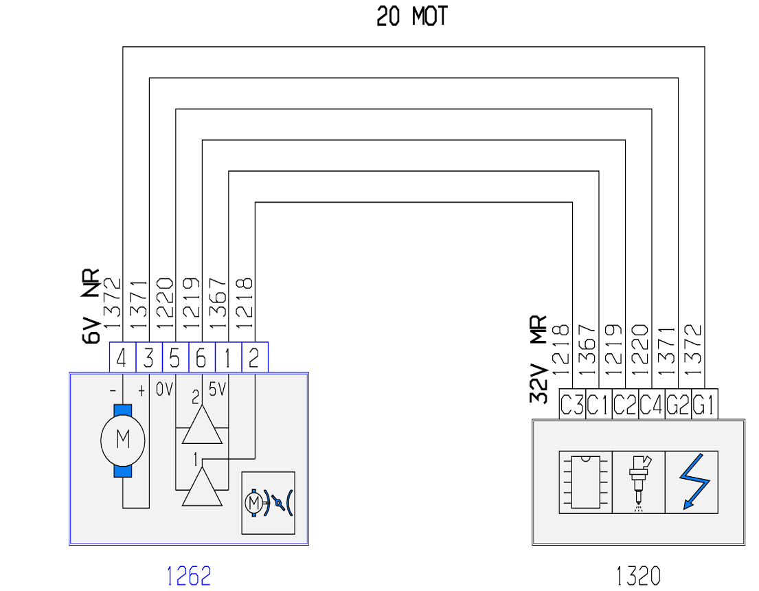

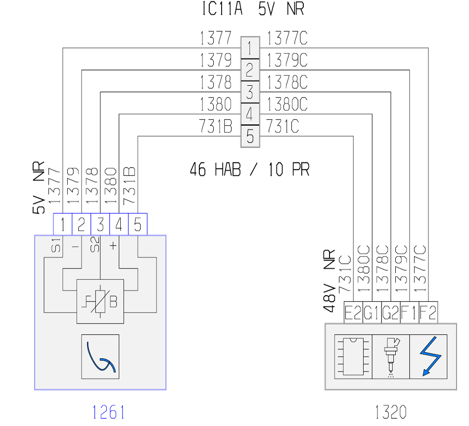

Ok, so here is the main injection diagram, followed by teh Accelerator posistion sensor and the motorised throttle.
There are 2 tracks on the accelerator position sensor and they are compared with each other to ensure the data is correct. As per your fault codes there is a discrepancy between the two readings. This usually means a new accelerator pedal as the sensor unit is inside. However in this case the part (1601V8) is no longer available from Peugeot. So you will have to look for a second hand one.
1261: accelerator pedal position sensor /
1262: motorised throttle
Your Fault Codes:
P0221: Motorised butterfly signal track 1 and 2 not coherent fault
P0121: Motorised butterfly signal fault, non coherence of signals 1 and 2
Details of the component wiring and location:
Motorised Throttle
Location Wiring:
1372: Throttle motor command by -
1371: Throttle motor command by +
1220: throttle potentiometer supply 5V
1219: throttle potentiometer position signal 2
1367: motorised butterfly potentiometer earth
1218: throttle potentiometer position signal 1
Accelerator Position Sensor
Location Wiring
1377: Accelerator pedal 1 position info
1379: accelerator pedal position earth
1378: Accelerator pedal 2 position info
1380: + 5 volt accelerator pedal position indicator power supply
731B: accelerator pedal point of resistance / signal
