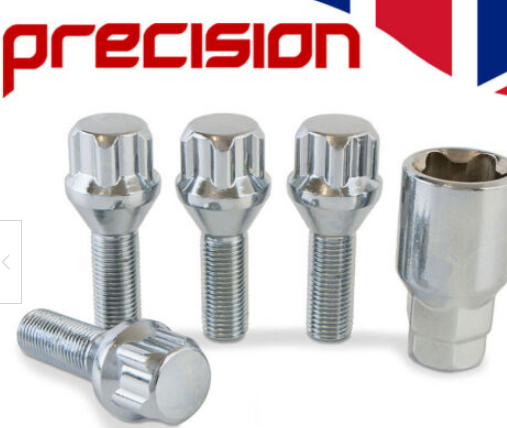

Precision do locking wheel nuts sets for alloys - I replaced my Citroen locking ones with a set of these for £24 delivered. If you still want to have a set, these are a limpet type design, so they don't have any pins to rust or break. The limpet design fits over the unique head of the bolt so there's no shearing off.
They can be had for Citroen from £13:
Here for a C4 for example:
https://www.ebay.co.uk/itm/121609701751 ... R5qyj4PuYQ
I was really pleased with them and would highly recommend them as a replacement if you wish to retain your wheels.

Just note those tapered seat bolts suit aftermarket wheels, the OEM alloys need the flat washer bolt type.
(Standard bolts for me, can't be doing with the lockers, too problematic. Concede I've not tried Marc's limpets though. (Look a bit vulnerable to "hammer a cheap socket on the top!)

Yes, should of mentioned - make sure you get the correct type for alloys - I just used the above as an example.

I find Irwin reverse-flute sockets, the ones designed to remove bolts with damaged heads and rounded nuts, work amazingly well on some varieties of locking wheel studs... Those 'Limpets' would be a dead cert to undo when faced with an Irwin...
Good as a deterrent to the causal tea-leaf though...
