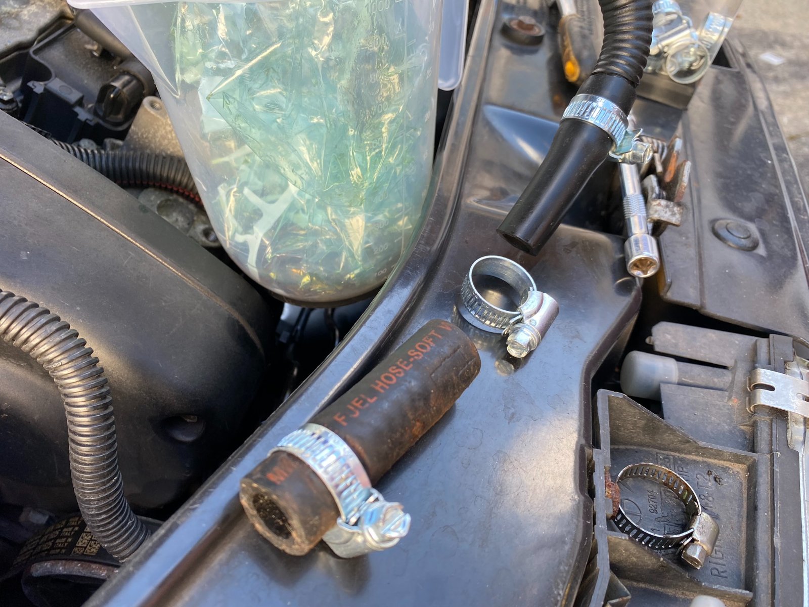

The V6 pump is unique and differs from all other Xantia's, I guess the spigot diameter is different too. HDi will use the "standard" Xantia pump.
My old piece of pipe was definitely 12mm ID as I measured it last night and it used to be a very tight fit on the spigot of the plastic hose which crosses the engine, no chance anything smaller than 12mm would fit.
The spigot on the pump is slightly smaller than the spigot at the end of the plastic feed pipe, (by about 0.5 - 1mm I think) the original moulded Citroen hose section has a different hole diameter at each end which is why a single diameter pipe which is big enough to fit the plastic feed pipe struggles to seal well on the slightly smaller pump spigot, especially when it's a really stiff, thick walled hose that doesn't have much give when you clamp it.
So I'm hoping the thinner wall more flexible pipe has a bit more stretch and give in it so it can stretch slightly on the plastic feed spigot (perhaps with a hair drier to persuade it) and at the same time clamp down better on the pump spigot.
I just know that I'm not getting a good long lasting air tight seal with the current stiff wall pipe. Fingers crossed.

So the 12mm nitrile hose arrived yesterday and was duly fitted and I can say that it's absolutely perfect for the job, both in terms of inner diameter and flexibility. =D>
You can see in the picture below that it easily stretches a bit to fit over the slightly larger diameter spigot on the plastic hose:
In the foreground is one of the previous pieces of hose I've used before which is just too thick and stiff to seal well.
The car got a bit of use yesterday and the ride did not revert to being crashy at all. One thing I did notice though, which has been that way for maybe 6 months is the front ride height is quite obviously too high - how it changed by itself I don't know, I can only assume that the clamp was not quite tight enough.
