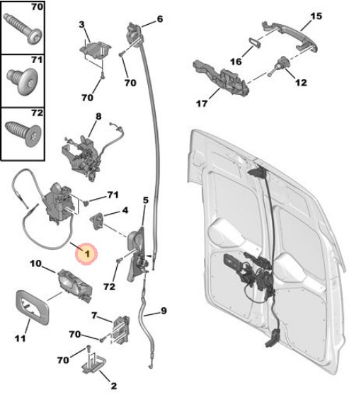

I see what's happened Marc. when you posted on my other thread I didn't realise you'd posted the side door and didn't correct it. The image I posted is of the rear doors, not the side doors. :D
x 6959
I think it's an issue of communication and what exact part is required. In my previous post above and on the other thread, I did list it as "(1) Side Door Lock" These vans have front doors, rear sliding doors and rear access / tailgate doors. The diagrams are for your specific vehicle.
Here is the one for rear access door:
Assuming it is item (1), then this is only in the right door.
(1) Hinged Rear Door Lock, part: 9138S3, £194.99
If it's anything else, let me know, but hopefully you have what you need now. :wink:

However, one last try. My Left door from inside or Right door from outside has an extra Latch at the top likened to that shown in your image on the other door. This equates to a difference in part 8. as seen in my initial image.
While part 1. may be universal in either H2 or H1 I would like to be certain before proceeding.

This is the image I have on Peugeot Service box but it is different than what I have on the van as I have the extra latch at the top....can you make sense f what I'm referencing?
In this diagram you can clearly see a cable coming in from the bottom but I don't have that in my photo. My photo also shows 2 cables entering too left where the diag. Only has one.

I'm going to chime in early and suggest this might be universal to either system and the yellow cable, bottom of my image above, swivels at the other end where it connects to the locking mech.

Ok, so I know where the confusion is now:
Diag ADiag B
Item (8) in Diag A is called the Door Opening Control Plate (Part: 6138V2). In Diag B, this is actually shown as item 14.
Item (1) in Diag A is the Hinged Rear Door Lock and is shown as item 15 in Diag B.
As for the cables, these are deceiving and I've showed these in green and red.
So part (8) Diag A, or (14) in Diag B has only one cable that I have shown by a Red line. This corresponds exactly to the parts diagram.
It is item (1) in Diag A or (15) in Dag B that has 2 cables that connect to (1) where I have shown with green lines.
So if you look at Diag B at the bottom green line, I suspect the cable missing is in fact from item (15) where it goes from the lower green line arrow head and behind the connector at 'g' up to the mechanism. In other words the cable in red I have circled (in the diagram below) has come away or snapped, and is missing. But it should be part of item (1) the hinged lock.

Then I'm at a loss - as (1) looks a little fatter than the image in the other picture (15), but this may be because of angles.
This is the cable missing or disconnected that I've circled in red .......
..... that I think is this cable shown from the diagram once connected correctly and missing or disconnected in your picture.

Ah it's not disconnected Marc it's just attached from the other side. Behind the frame.
