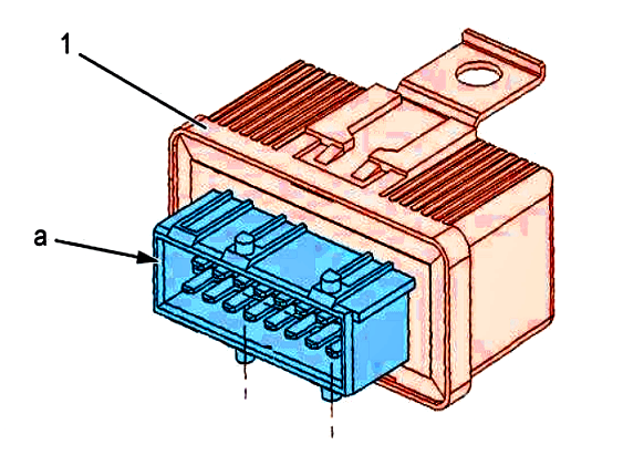

There's also a locking control unit on this vehicle which handles the locking (although still controlled by the BSI), so it may be possible this has gone faulty, but if you've checked the basic things, then will need a diagnostic to check for faults before replacing:
(1) door locking unit.
"a" Connector.
The door locking unit contains 4 relays which handle the following functions (according to model):
Also on this vehicle the resynchronisation is carried out by pressing any button on the remote control twice (this operation may be necessary after replacing the remote control battery).
"a" Connector.
- Relay 1: Front doors locking/unlocking relay
- Relay 2: Common relay
- Relay 3: Deadlocking relay
- Relay 4: Rear doors locking/unlocking relay
