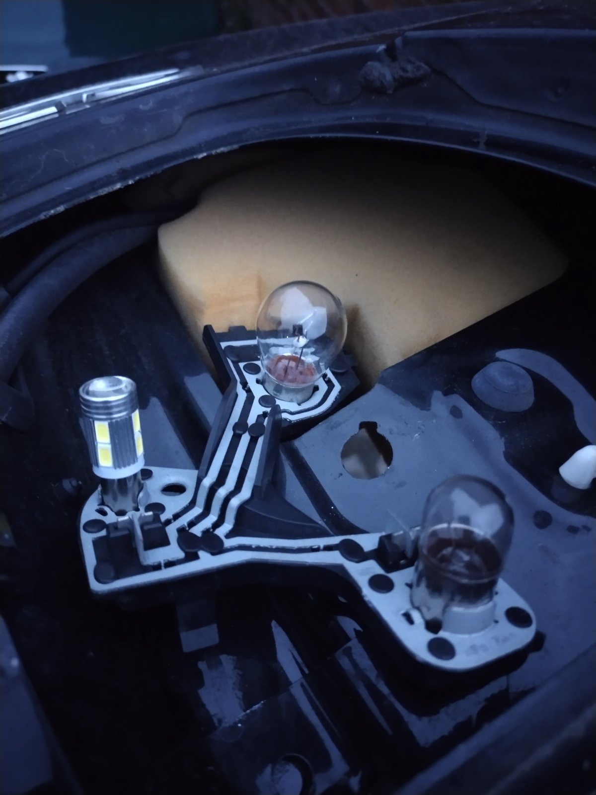

LED H21W off eBay arrived Thursday afternoon, so put them in last night
No after picture as day light failing me. Doesn't look a great deal different, but to be honest I was most worried about it melting itself with the normal bulbs!

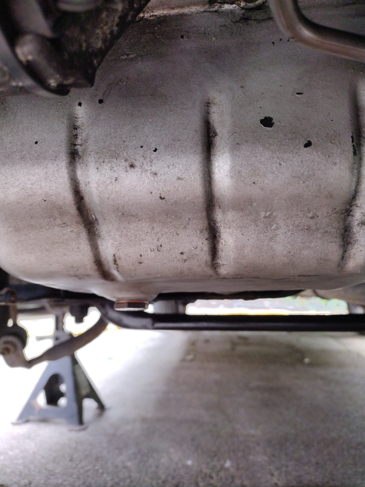

Can you spot what is unusual about this particular DV6 sump?

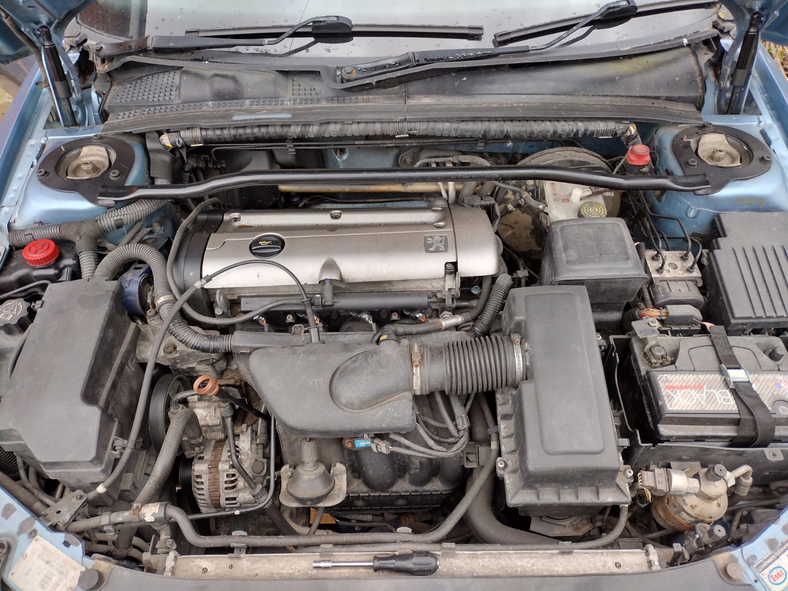

Decided to make a start on the Coupe engine removal task. Up in the air and on axle stands, undertray off, oil drained. Quite dark, surprisingly. Will have to see how long it's been in there (not that long, from memory) think have it written down somewhere.
Air filter housing, inlet elbow, battery and box all off and out the way...
... Then the rain Alex told me we weren't getting promptly arrived. The joys of working outside! Oh, and before all that (and after the 206 oil change done) I swapped the tired bonnet gas struts for some new cheap ones from Autodoc - massive improvement and fear of it crashing down onto my head eliminated!

Self modified ? It came like that ? Or you bought a modified sump ?
- Posts: 5364
- Joined: 25 Apr 2022, 09:03
- x 2367
Original sump, modified by me:bobins wrote: 01 Apr 2023, 20:59 Self modified ? It came like that ? Or you bought a modified sump ?![]()
A good fit and not too sharp edged socket (in my case 19mm impact socket) on the inside.
Offcut of 6x2" timber with a depression drilled/ chiselled out in the centre. A few 2" nails to give alignment with the sump.
Put socket - sump - wood under the business end of my friendly MOT garage's hydraulic press = Bob's your uncle.
I bought a second hand sump so made the job a straight swap (the modification done months before I was due an oil change)
So then did the original sump same treatment and swapped it again on a C4 i had at the time.
The third sump I used a normal socket rather than the impact type and instead of a nice neat result it punched a hole through instead! Glorified hole punch I suppose and rather effective as such!
So last sump was a write off and went for scrap. Total cost about £15-£20 for the first second hand sump I think and two cars improved - so count that as a win.
Someone has measured the volume left behind on the standard design - I did too but I can't recall the figure confidently - I have in my head it was 700 ml, but don't hold me to that amount. Certainly a large quantity.
There's a video on YouTube of someone who drains the (standard) sump, attached some sort of pneumatic puller into the drain plug threads, pulls the hole down without sump removal. Then when they unscrew the fancy gismo a second large stream of oil is then released! Will see if I can find it.
