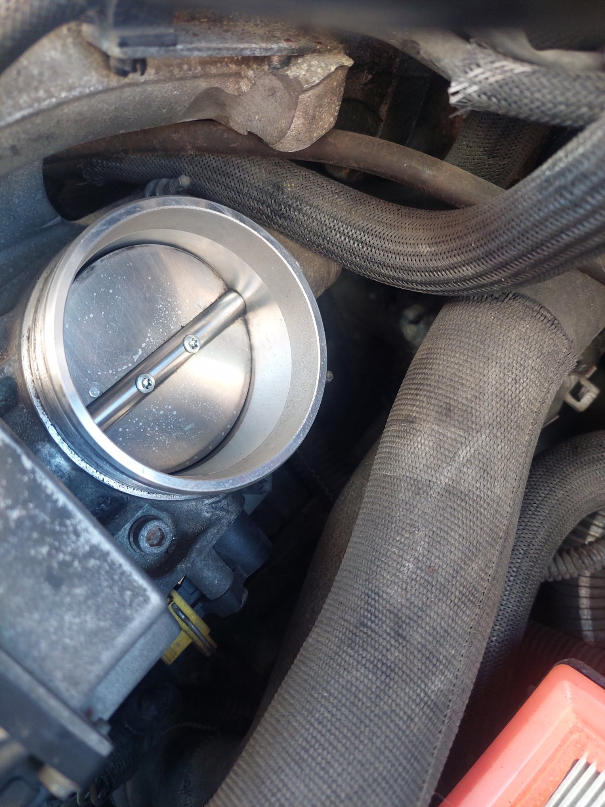

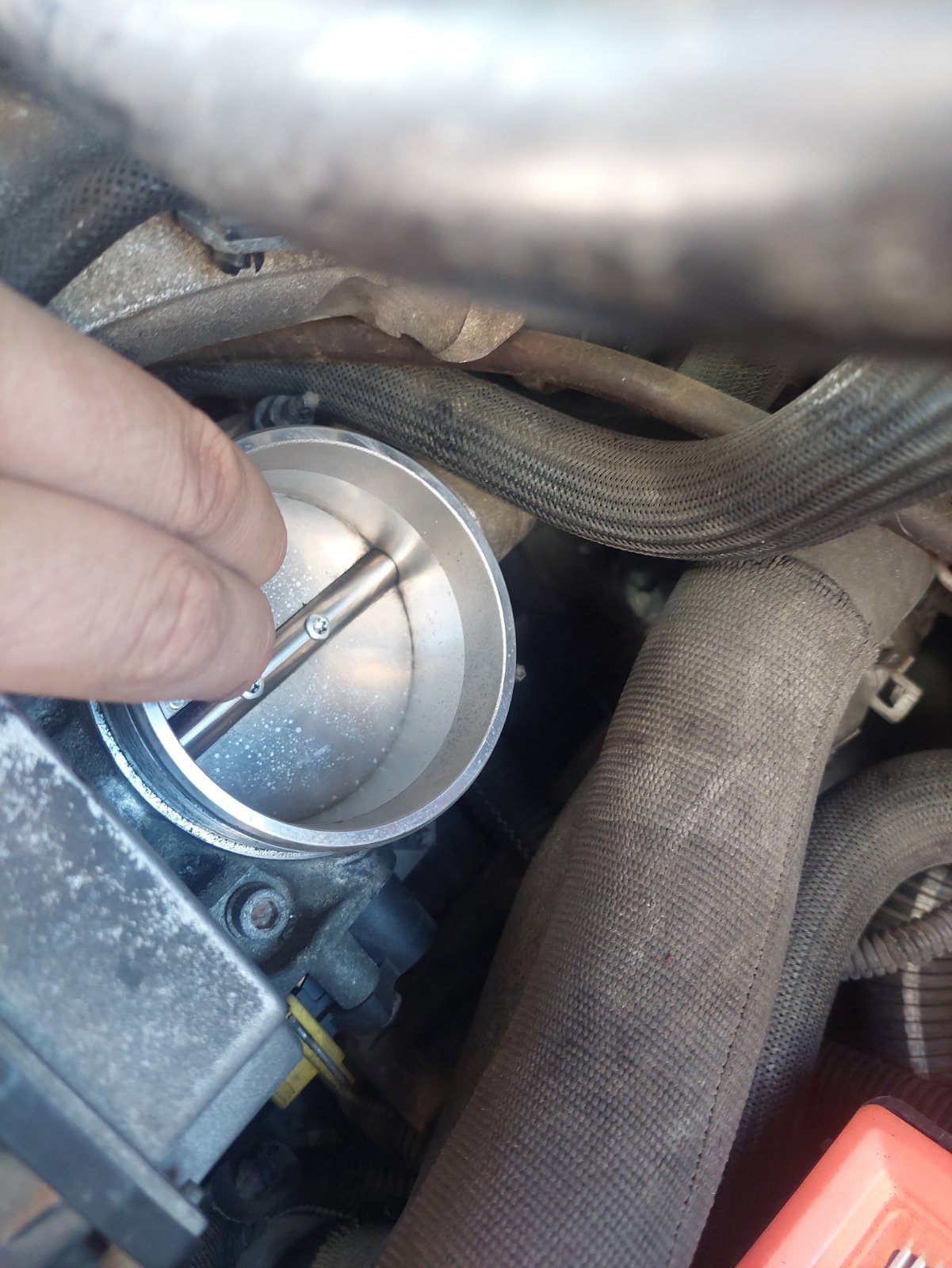

There are the pictures of throtle body inside. By default it is a little bit open.

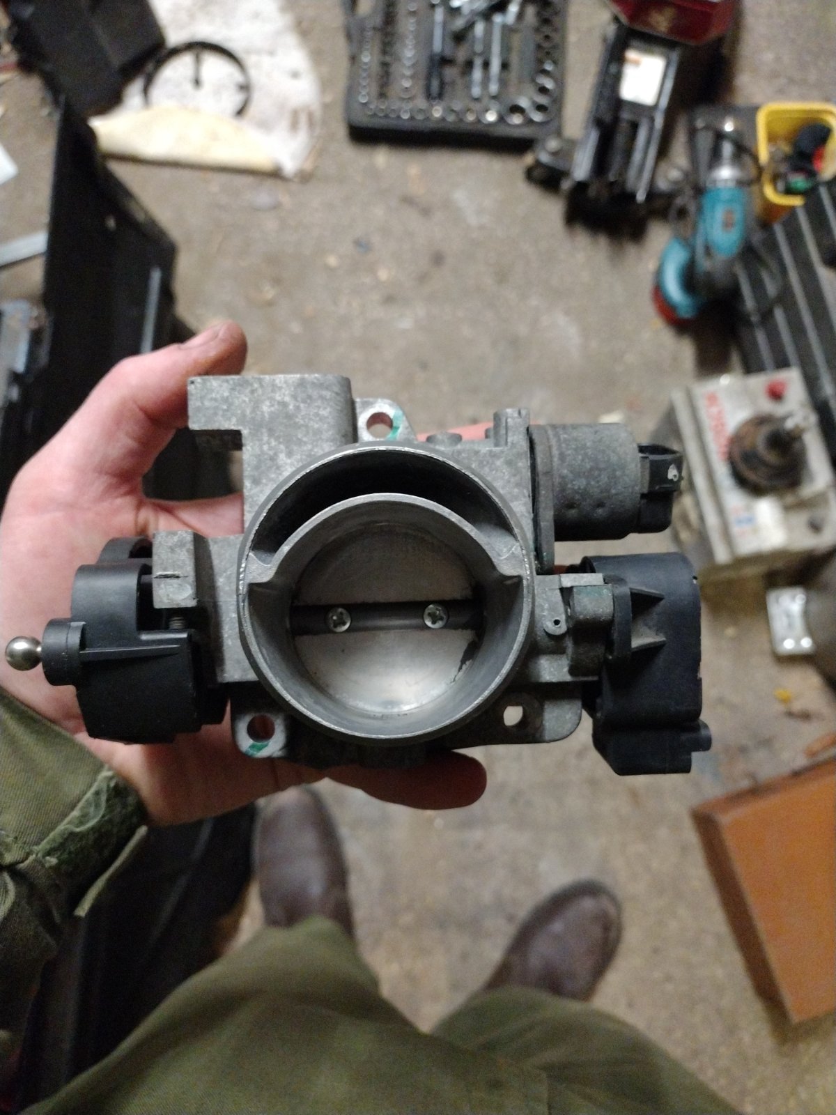

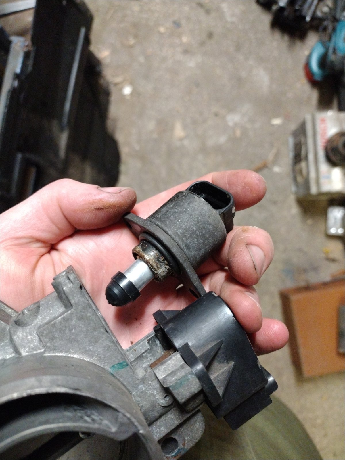

That makes sense I think, the motorised throttle does away with the need for a separate idle control motor (like on my pictures) and so instead it's held a fraction open and tweaked open and shut by ECU to keep the idle speed correctdynamics_sila wrote: 12 Apr 2023, 20:12 There are the pictures of throtle body inside. By default it is a little bit open.
