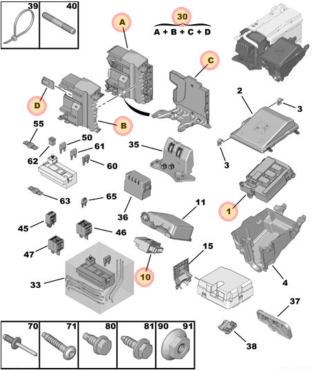

Ok, so here is the issue Chris. As I don't know which component was actually replaced, I can't tell help with the correct one, but here are the possibilities:
(1) The Engine Fusebox itself, part: 9810296380, £402.26
(10) The Switching and Protection Unit, part: 9801916680, £54.30
(30) The Protection and Management Unit, part: 9675349880, £348.16
If it was my money it would be either (1) or (30)
All prices VAT inclusive direct from Citroen. It may be worth trying to contact that member on C4 Owners and seeing if he can advise - or get advice from Citroen.

Thanks Marc, you have gone above and beyond, I agree with your assessment. It seems there is no easy or cheap option. I will do as you suggest and meanwhile live with it. If the fault was on all the time it would be Citroen. I simply can't afford to spend in excess of £400 on the wrong part. Rest assured I will report back. It is a shame when people don't do so. Too many happy to take help and not provide it.

A search of the link brings up the you tube video. It's number 30. There are a few about for £75 or so used. I will get one and, once the weather improves, it looks a simple enough job. I will let you know how it goes.
