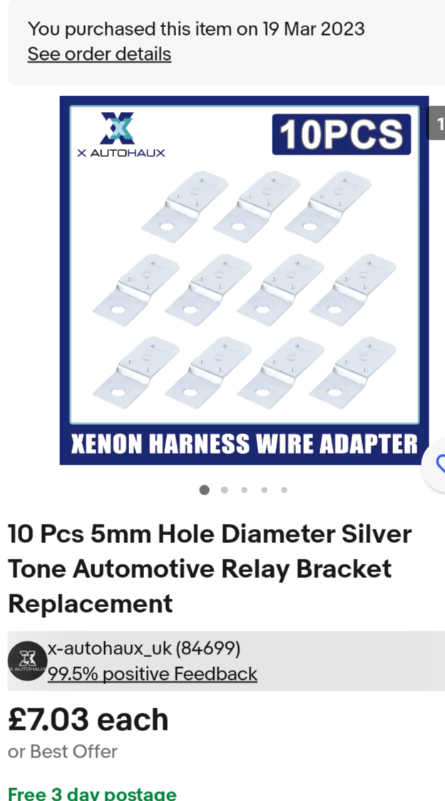

It didn't seem a good solution, and I have the rivet nuts and tool so easily done. None of these though, so will have 7 spare brackets for future use! For 70p a go it didn't seem worth time effort to make my own.CitroJim wrote: 20 Mar 2023, 05:56 Good work Matt, sticky foam pads have a very short life in my experience... You can't beat mounting relays properly...

Relay brackets arrived yesterday afternoon, might have a "dinner time tinker" and get them in place (or looking at the weather currently, maybe not!)

Not in the wheel well. Remaining elusive.MattBLancs wrote: 23 Mar 2023, 13:46 Just had a thought, wonder if it is down below in the spare wheel well rather than in the rear arch void.
Brackets too wide for relay slots so file (and hammer they are very soft steel!) And now all mounted securely
