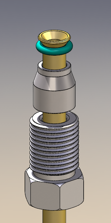

Looking at the LDS pipe ends, I can't get my head around how the LDS pipe ends seal - it looks like the pipe end has a small flare, an o-ring, a white plastic washer, a conical olive, and a tube nut. The logical conclusion would be the pipe seats on the flare, the tube nut pushes the cone which pushes the washer which pushes the o-ring up the flare to expand and form a seal; slight problem with that, the conical olive is bonded solidly to the pipe, so what gives us the seal?
I've modelled something in CAD, and double checking my measurements I noticed I'm planning on having the conical olive slide up the tube towards the flare as the nut tightens, But that's not what happens with the original pipes, so I'm now genuinely confused, and would like anyone's insight on hose these damned things seal before I send potentially flawed CAD models to be machined up.

Great minds Kenny, single flare and jewllery is what I'm going with, I've modelled it up for the smaller sizes on the little pipe from the galvanic corrosion generator, ahem aluminium union to the rear firmness regulator:
Could I trouble you for dimensions on those elements? As on the front to back pipe I believe those components are bigger than the same parts on the short pipe are?

Re: LDS pipe end question
Jay,
Here some dimensions: Brake pipe is 4.76mm diameter, conical olive is OD 8.6mm, plastic o ring OD 9mm x 1.4mm thick, brake screw 10mm x 1 spanner size 11mm.
Kenny
