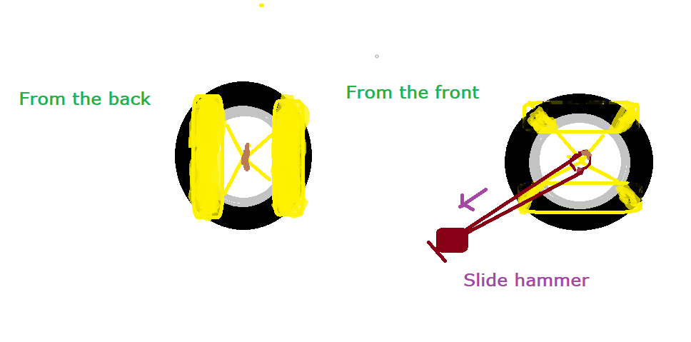

I used to use a trailer tie down harness and a slide hammer, something like this: :)

Very useful bit of kit the ratchet strap tie downs, I have used them for many a purpose they were not intended for :-D
Several vids with variations on this method.
No recommendation, make your own mind up.
Important to ensure the wheel bolts/nuts are just loosened enough to allow the wheel to free itself from the hub but retain the wheel. Looks like it was a particularly well stuck example.

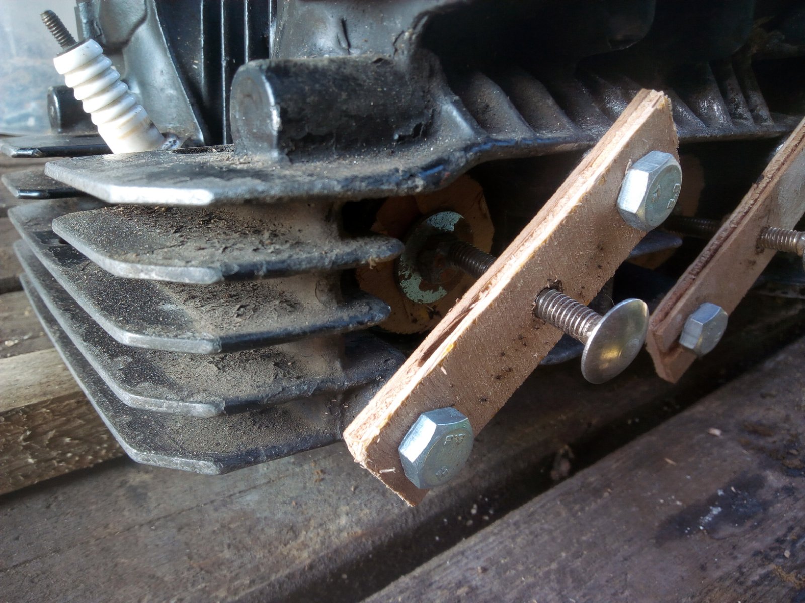

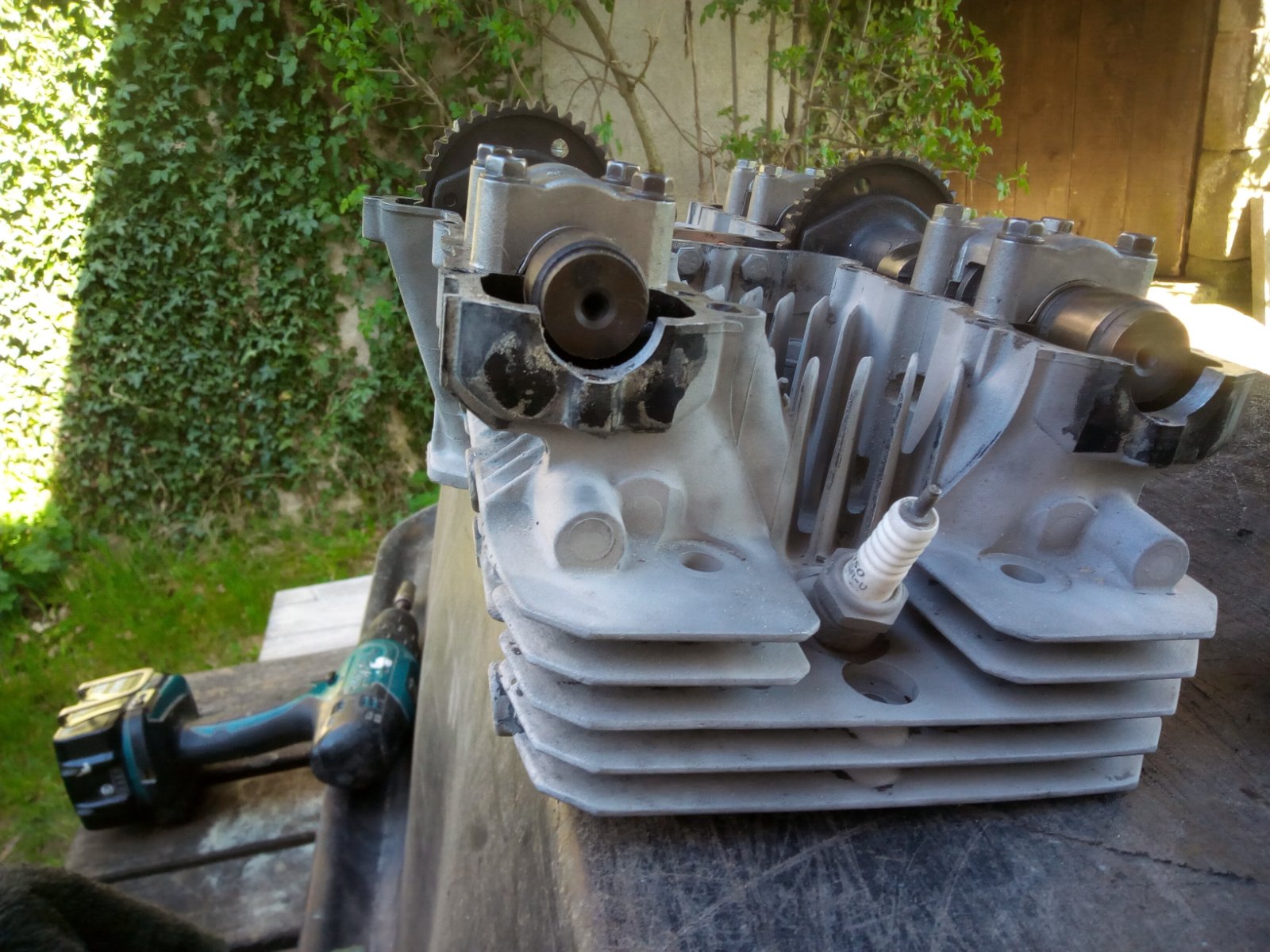

Just a quick update on the sandblasting, not finished, few bits of grime stopped the sand doing it's work but.....
before
after
Also while I was in there had a niggle about a tight spot when rotating the exhaust cam. These engines are line bored. Then realised that I had another ex cam, better but not as free as the inlet. Then I remembered that the inlet and exhaust cams are the same, it's just the cam sprocket position that changes to align the marks for timing and I have another inlet cam, fitted that and as free as a bird. Looks like I have 2 slightly bent ex cams.

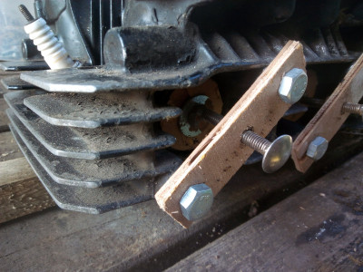

Does anyone know how heat resistant the epoxy pellets, like the ones in the picture below, are?
My dipped beam bulb holder clamp spring mount shattered so the lamp was not being held in its place properly. I have 'squidged' it back in place with a couple of the pellets which have worked well but I'm not sure if they will tolerate the temperature of the metal casing of the halogen lamp.
If it deforms or melts and no longer does the job I'm fine with that, I just want to be sure about its flammability. Any ideas? :? :)

Re: DIY Car Maintenance with function over finesse!!
Unread post by Stickyfinger »
No very, epoxy will soften with heat...there are "types", cheep stuff is not normally very good.
Posts: 21341
x 8155
OK thanks Alasdair, I've done it now so its a case of see how it goes!!

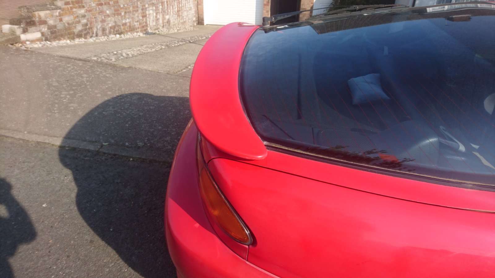

It dawned on me today that Bob and I are off to a classic car racing day at Thruxton on Sunday and I hadn't got round to having the rear spoiler's red fade, as witnessed by Jim and James, sorted out. So realising that I only had today and tomorrow left because there is a ceremony on Saturday, and I would feel disrespectful working on the car during that, I decided to have a go at it this afternoon. So I colour sanded it with 1200, 1500, 2500 and 3000 grit paper, rinsed it and dried it and then applied some super resin polish. The result is probably not as good as it could be but it is certainly good enough to take to Thruxton!!: :-D
