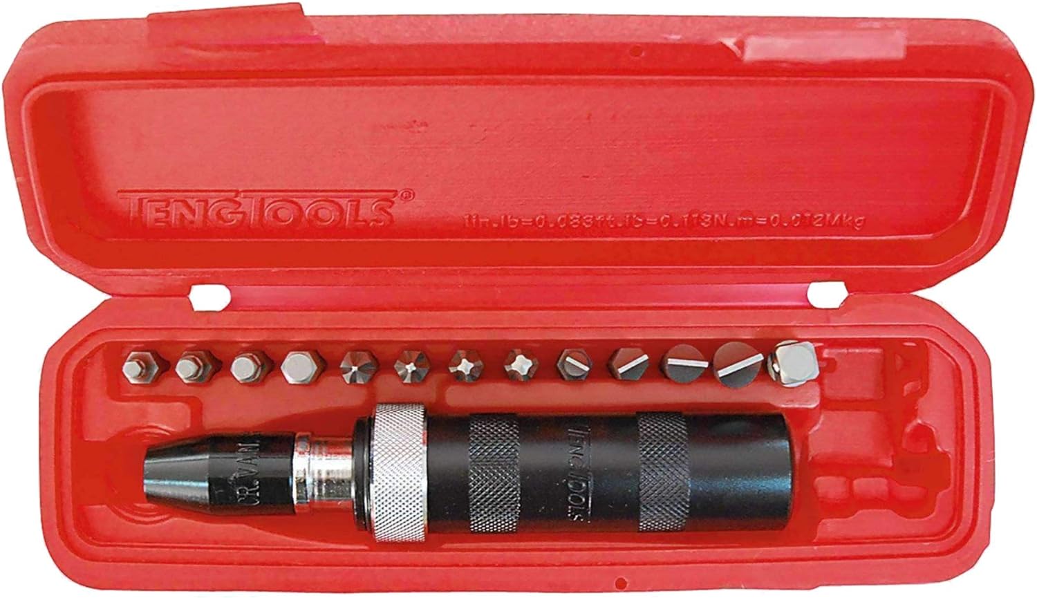

Also, when removing brake disc screws, use something like this:
https://www.amazon.co.uk/Teng-Id515-Pie ... B0001P0VXU
...it's called an impact driver, not to be confused with a power tool used to drive in decking screws, or the air/battery powered gun for driving sockets. You put the appropriate hex/torx/screwdriver bit in, whack it the handle with a hammer, it hammers the bit in and simultaneously twists the bit a couple of degrees, thus preventing "camming out" of the screw head as it only twists the screw when the bit is getting hammered into the screw.
I've used those very screws before, albeit from a different seller, I recognise the markings. Get the stainless screws, use your antiseize compound of choice such as copperslip on the threads, don't gorilla them up, and you'll be golden. If you're worried about getting the discs off later to do a wheel bearing or a drive shaft gaiter or such like, get one of those impact driver things, just make sure it's twisted to the loosen position so when you push down on it the chuck turns counterclockwise.
Those tools are are also handy as they have a 1/2" square on them like a ratchet or breaker bar, can be a godsend for corroded fasteners, as you whack it with the hammer, your simultaneously forcing your socket onto the mangled bolt head, and twisting it, helps prevent the socket slipping off and rounding the bolt head.

Jay, that little impact driver - from my days of spannering Japanese motorcycles - is definitely my go-to tool for disc retaining screws... Never failed me yet!

Yes, same thing I was describing. I'd call it a "manual impact screwdriver"

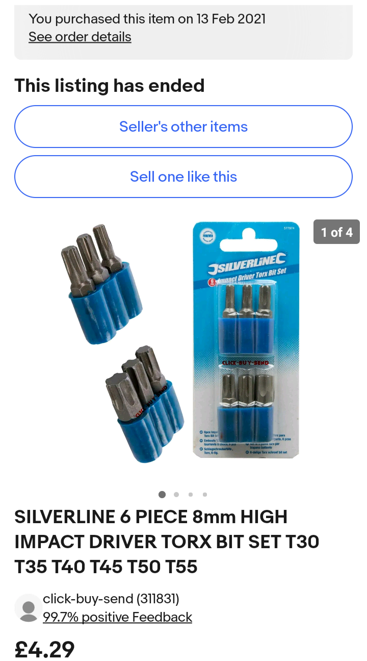

This is the Torx bits set I got to use with my impact screwdriver.
Reminded me: note it is 8mm hex, not the smaller 1/4" (6.35mm) hex commonly used for screwdriver bits.
My impact driver is an old but decent one - Sykes Pickavant from memory. But given the simplicity of the actual device I don't know why a cheap one would be measurably worse??

Re: Brake disk bolts
Teng tend to be rather expensive but very good tools.
Impact driver £46 from Screwfix, £26 from Amazon. Not identical kits though.
Bahco were always excellent quality tools but pricey. Their stablemate Teng are equally expensive but better, in my limited experience.

I've got to admit, I was somewhat surprised how cheap the teng one was off Amazon, I thought it was a safe link. Having said that, the Halfords one is OK, and great value at £15, even better as it's on offer at £12 the how. I actually own both, I loaned my Teng one to a mate, who went offshore, then I needed to use one myself, so I bought a Halfords one just to get by, both are decent enough.
