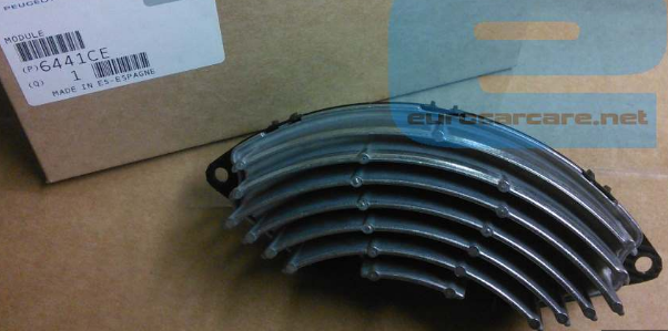

Are we talking about the same thing here - I can't see how you can splice this in:
This is the blower control module. This is usually attached to the blower motor itself.
The other blower control module is for the additional blower and is completely different

Hey, how you doing? Thanks for the reply, yes this thing, it seems to be commonly known on Ebay as a resistor hence my use of that term, there is a connector that goes from this to the blower itself that one is fine, the one that keeps melting is I presume a power feed connector that comes from the loom and attaches to this control module, the exact same connector as the one that goes from this to the blower if that helps identify it, every time it melts the connector and also the connection point on this control module, did think it was something to do with the blower itself last time so replaced the whole lot, blower "fan", control module and the melted connector on the loom for the car but same thing has happened again.
x 6947
Re: C4 Picasso Heater Resistor plug Melted AGAIN!
Ok, so these can be separate if not fitted directly to the Blower Motor.
I can only suggest parts quality as a possible issue - it's well known aftermarket blower control modules can be of terrible quality.
