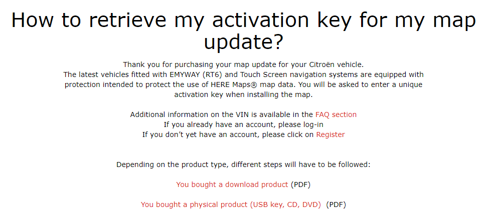

Hi there ive done that this morning and am now able to view the map update on the screen however it asks for the vin and the activation code but before i can actually enter either in full the unit reboots should i just persevere and see if i can eventually get it to enter? Sorry im not very technical really appreciate the help regards karen
- x 6945
Re: Ds5 sat nav
Normally when you purchase map updates from official sources (Official Citroen Navigation Website), it will go through the process of injecting the VIN and activation code into the downloaded files after you purchase the map update.
I'm assuming you may have 'acquired' the maps from non-official sources so if this is the case, so I can't help you with this for obvious reasons Karen. Otherwise the instructions are included on the website at time of purchase as to how to update.

I'm surprised that the installation process is asking for VIN and activation code. Normally, the RT6 unit only asks for the activation code.
Assuming you can get past the rebooting problem, you can use Mirascripts to remove the requirement for an activation code. I've done this to the eMyWay (RT6) unit on my C5X7. If you're interested in this please PM me for details.
- x 6945
Re: Ds5 sat nav
As you can see it is part of the legitimate software protection and why we won't discuss it on the public Forum
