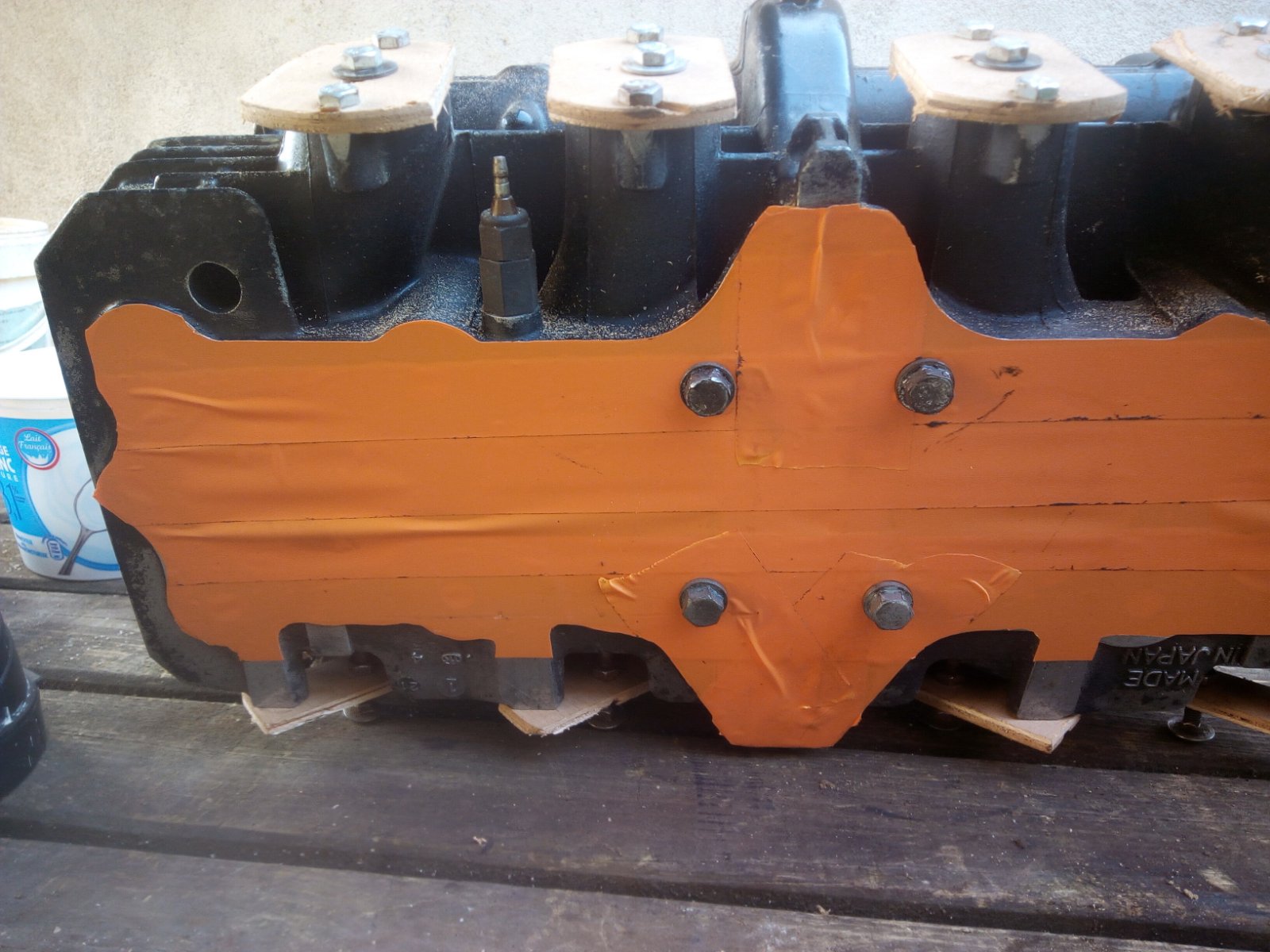

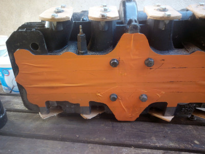

Not DIY car maintenance but bike stuff.
Need to strip the paint off my air cooled GPz1100 cylinder head, no vapour blasters around and would like to do myself, so sand, grade 0, like flour. Yes I have a mask and separate air supply, also doing it in open air. I know the dangers of silicosis, my father in law has it.
So the health of the engine is now the important thing. Don't want it sanding itself away so need to protect it.
Tried with thinners, nylon wheels on a drill....losing the will to live.....so...
Spare cam cover fitted.

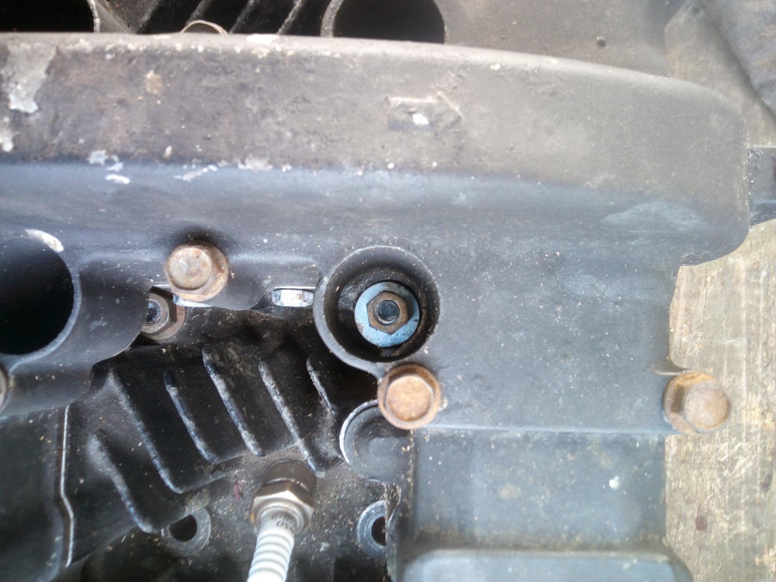

Injection ports blanked Exhausts ports blanked Then noticed oil ways on the centre cylinderhead stud holes, so they're blanked 4 sacrificial spark plugs, all cam cover bolts in, cam end 1/2 moons ragged and taped and the temp sensor in place. Reckon I should be good to play tomorrow

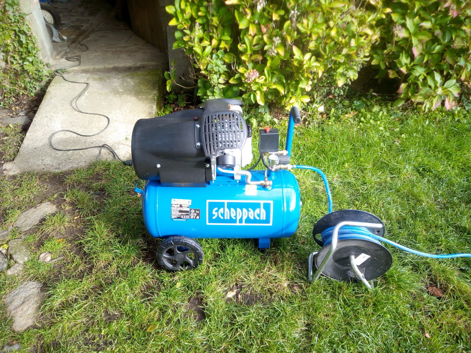

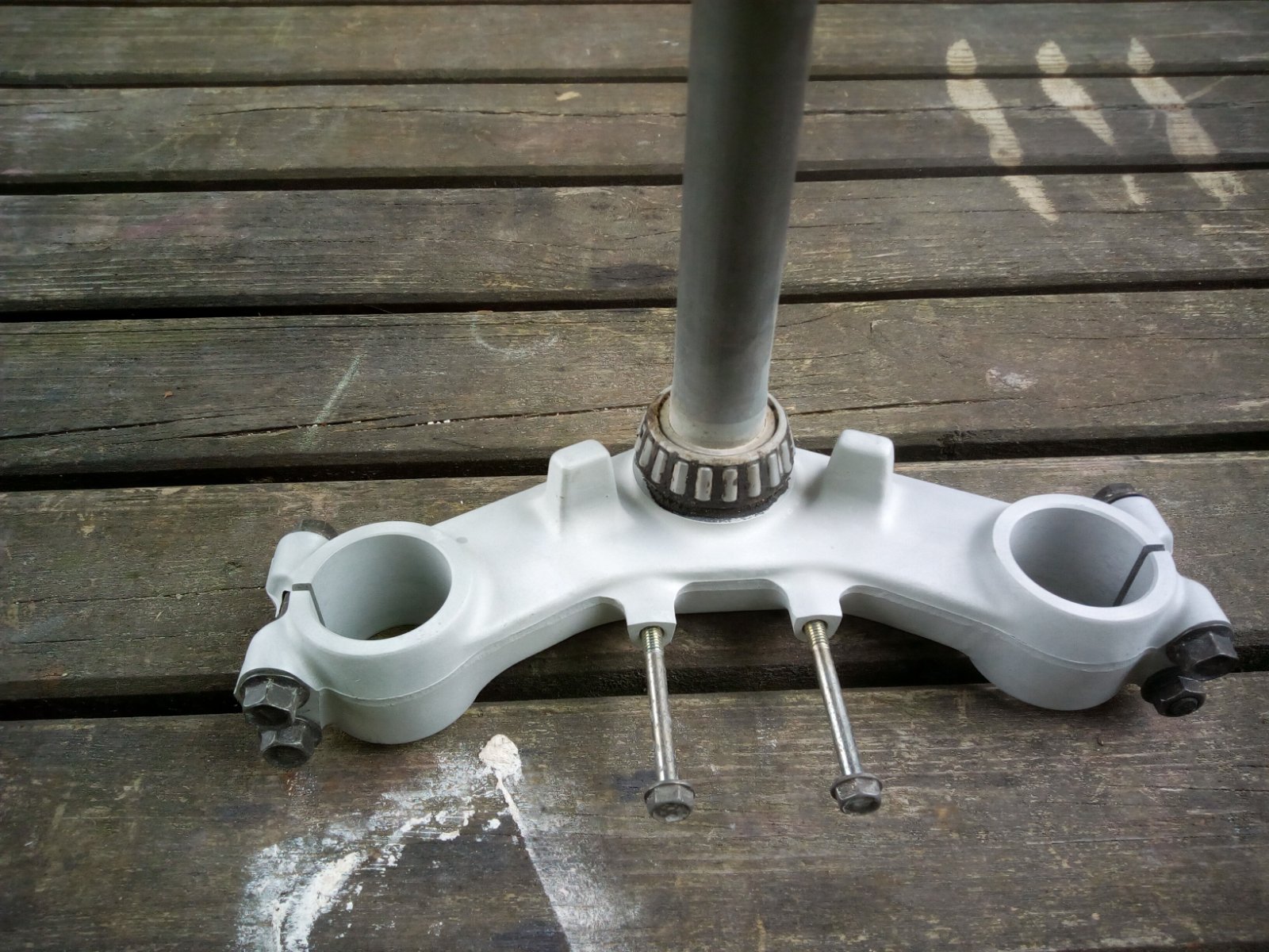

Matt, I have a twin cyl 3hp comp, I do it in a plasterers bath. Get about 65% back, sieved. Had very good results on the the yokes and the tank etc

Ah, that'll be a step up on all counts from the setup I had access to! Your blasting gun looks better too - thinking about it, I guess it really was a "spot blasting" setup with little tank like a spray gun and compressor nowhere near the capacity you have there.
As you say good results shown too
