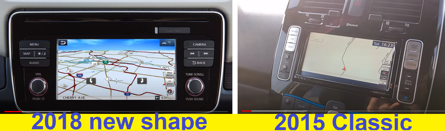

Interesting thing, the display in the newer shape Leafs has knobs and buttons to fiddle with, or maybe to rescue you when the right-hand side of the touch screen expires!

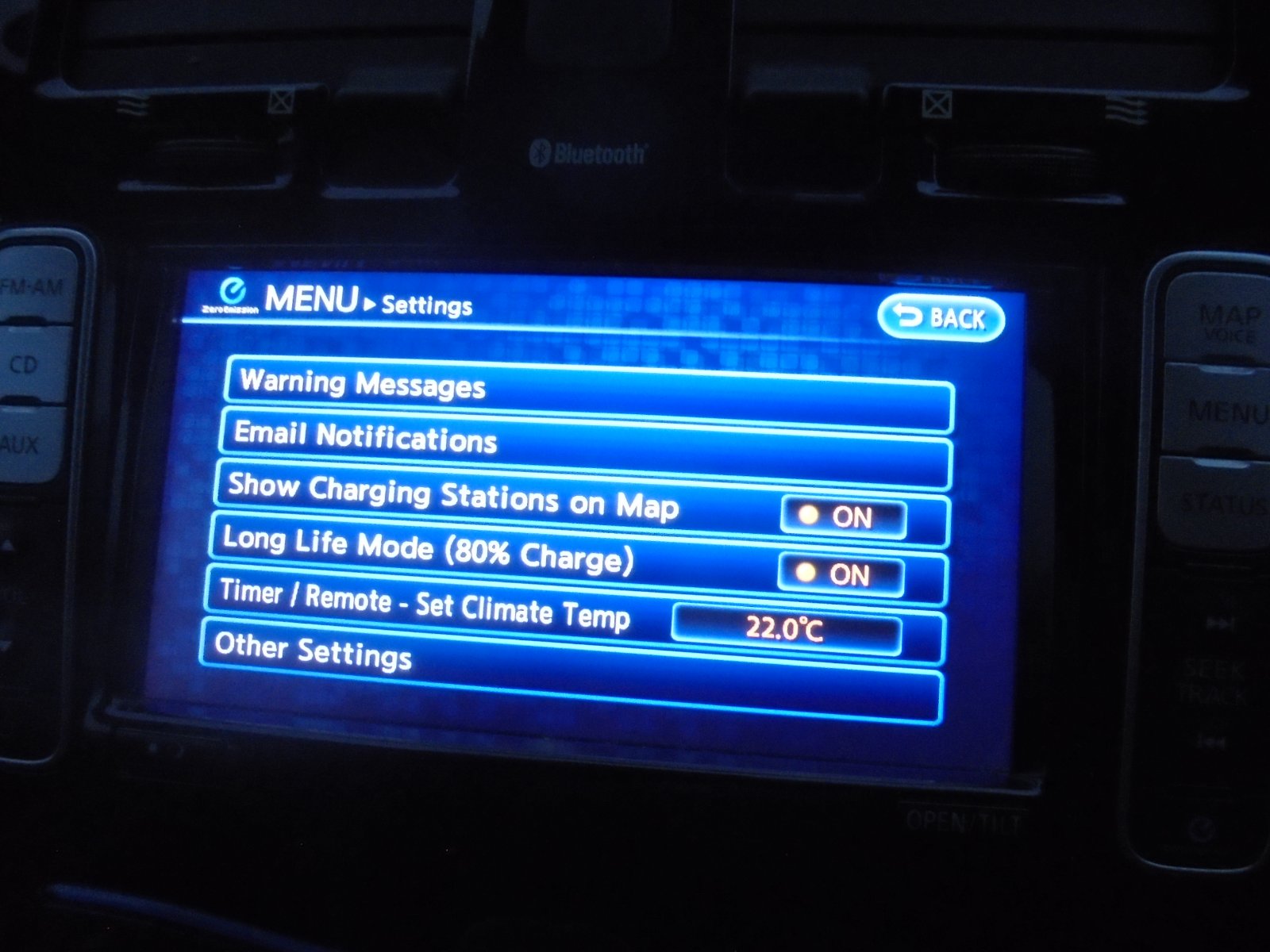

A bit of ruse nicking from others who have gone before, an illogical press the middle of the screen at the same time as the far right, the appropriate finger touch allowed changing of the battery charge option to Long Life Mode (80% Charge) ON.
This can stay on the menu now, as it can be overridden as you choose for a charging session, without relying on the right-hand side of the touchscreen working to alter what is now the default setting. A small win.

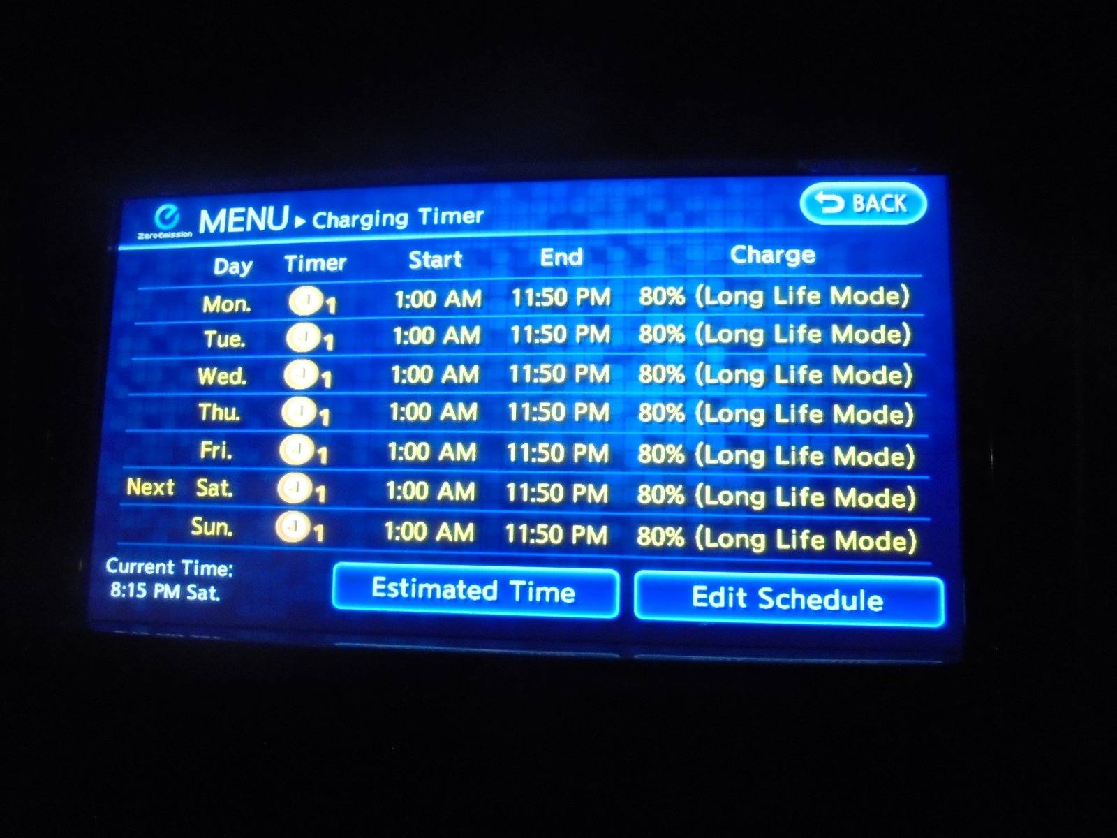

Three years since getting the Bargain Basement Leaf, set up the charging timer. With the right hand side of touchscreen requiring a bit of a knack to use, this allows me default charge up to 80% 7 days a week, but with a proper button to override the charger timer at any time, I can select a charge up to 100% any time I need it, by using the override button and not the touchscreen.
Having got round the only real inconvenience of the right side of the touchscreen not behaving as it should, any possible replacement of the screen has been shelved for now.

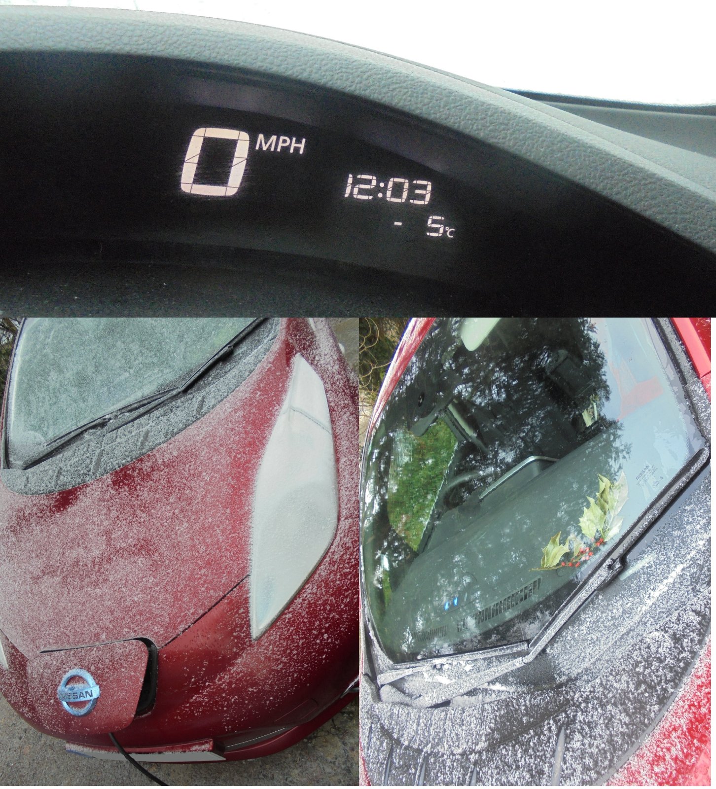

-5°C today<br />Don't have &quot;carwings&quot; or Nissan connect to put the heating on in the car with a few taps on a mobile phone, but switching on and off manually does the job just as well!
-5°C today
Don't have "carwings" or Nissan connect to put the heating on in the car with a few taps on a mobile phone, but switching on and off manually does the job just as well!
Thought I had read somewhere that charging up sub-zero wasn't recommended but not so. Charging will be slower, and the level to which the Li-ion battery will be charged may be less than at higher temperatures.
Head down to -17°C things get a little more urgent but the Li-ion battery warmer automatically comes on to help to prevent the Li-ion battery from freezing, and helps to prevent severe reductions in the Li-ion battery output. It turns off when the Li-ion battery temperature is -10°C or higher. The manual recommends that if external temperatures are expected to go below -17°C the car is connected to an external charger to provide electrical power to operate the Li-ion battery warmer.

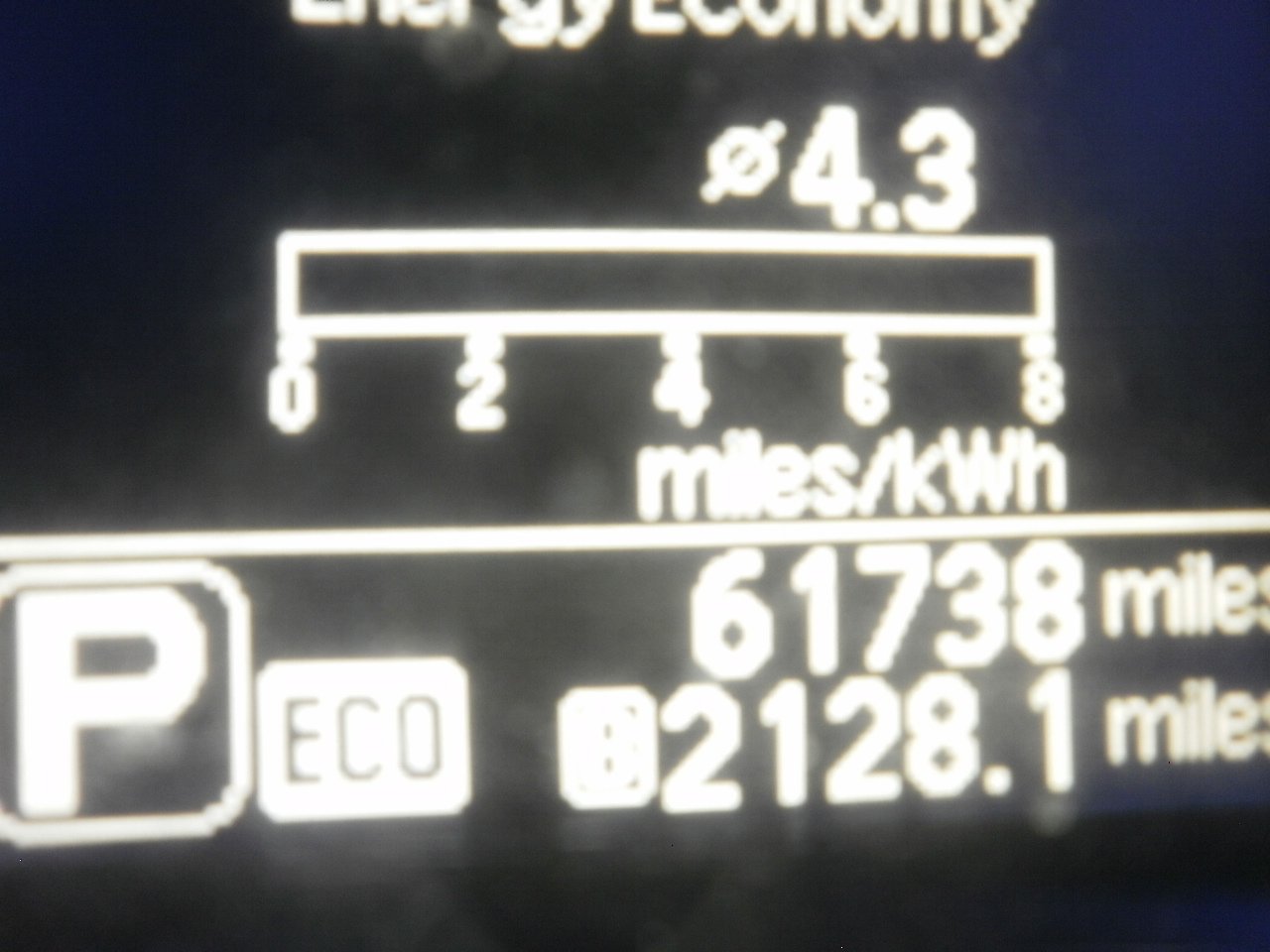

Straight answer to a straight question....it depends :-D
I drive it in ultra range preservation mode and as a result the current stats show me as getting 4.3 miles/kWh for the last 2128 miles, in winter, which is pretty efficient for now an old tech 7.5 year old battery. Heavier footed, less stingy with the heating will get much less than 4.3 at this time of year.
You could times this by 22 kWH available battery capacity and come up with 94.6 miles. In reality over the 7.5 years and 61,738 miles, it has lost one of its 12 bars of original capacity So I would say 85 to 90, although today after charging it showed 94 miles.
The display of miles on the dash is a guessometer working on some kind of algorithm. Up hill you can use up 5 miles in a mile, down hill you can claw much of that back through regeneration. The average miles/kWh is an actual.
I have never driven anywhere near 80 miles without recharging, which on battery longevity mode the workable range I use is between 20 miles and 70 miles. Never arrive at a charger with less than 20 miles on the guessometer and typically no charge up over 80%.
Won't suit everyone, but no regrets and 33,000 EV miles in and around Tyneside, Scottish Borders and Northumberland and Durham which is our usual stomping ground in what is now a very low range but solidly reliable well-engineered EV.
