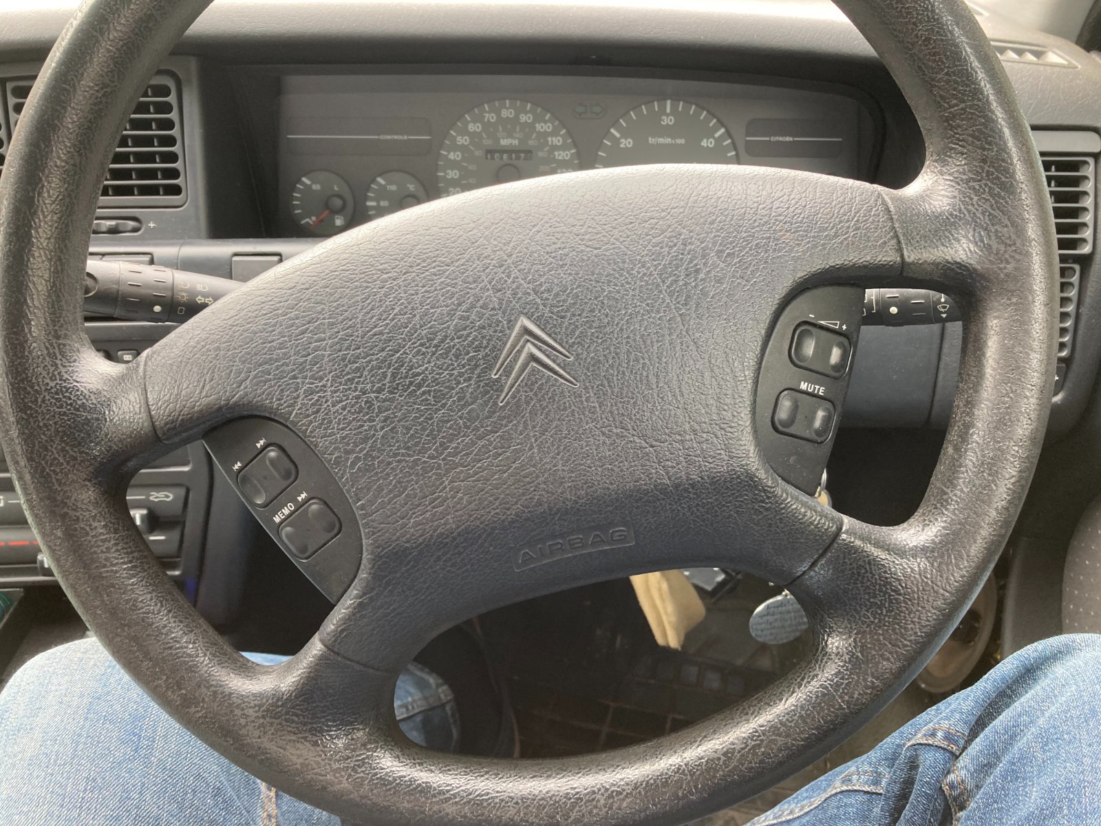

Thanks for posting all that up Richard! I wrote my original reply on the basis that it's so rare for me to need to have tracking done I can't remember the last time I did... Maybe a reflection of the slow low mileage I do... So I could never justify the cost and effort of getting tooled up for it...
However, I can see a big advantage of doing it yourself... A properly centred steering wheel
Nothing infuriates me more than an off-centre steering wheel

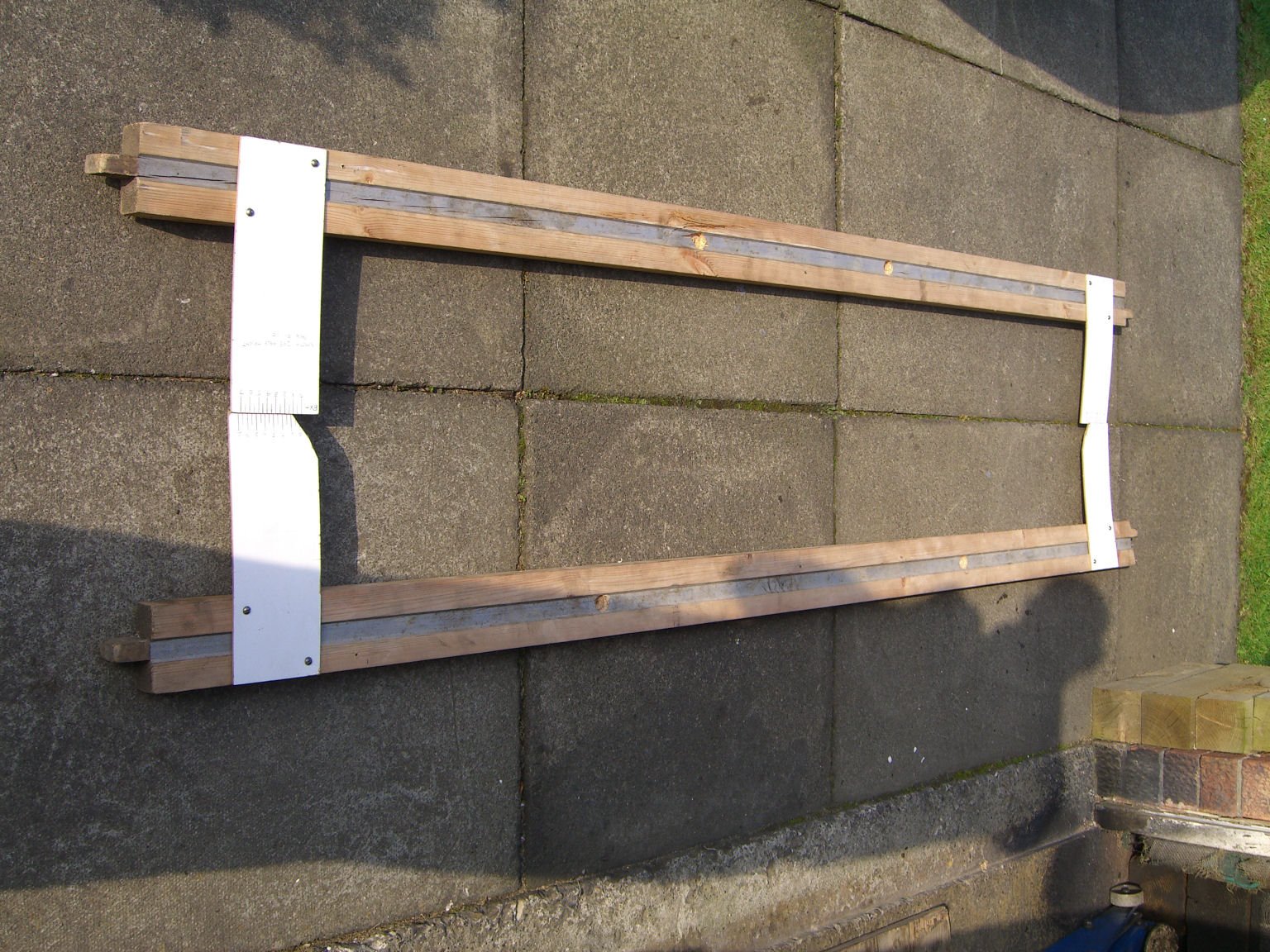

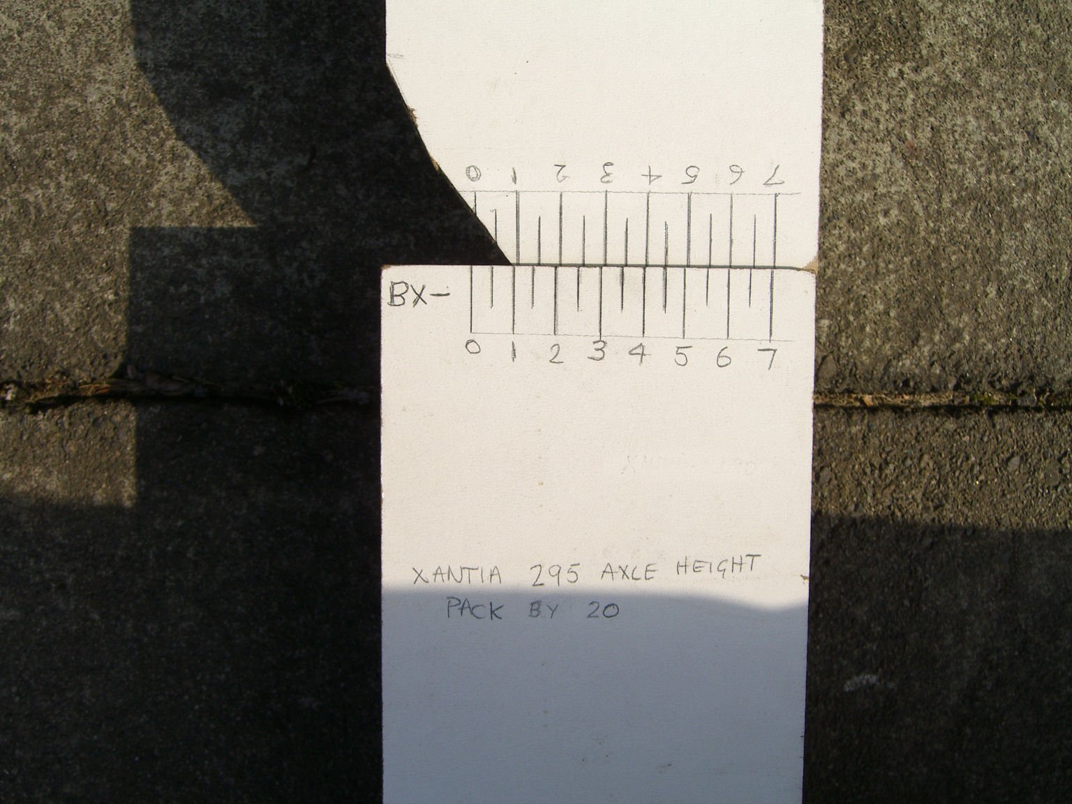

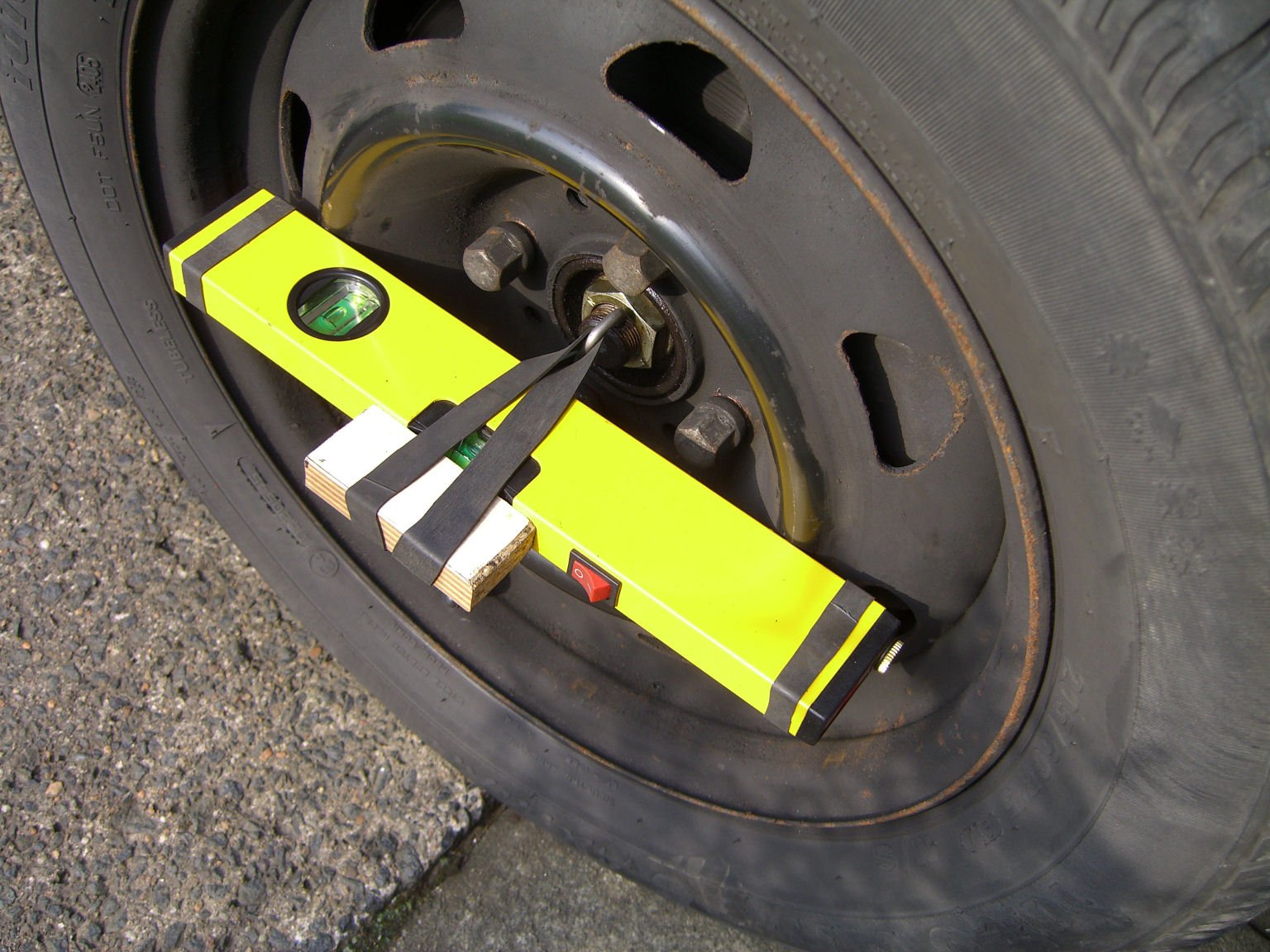

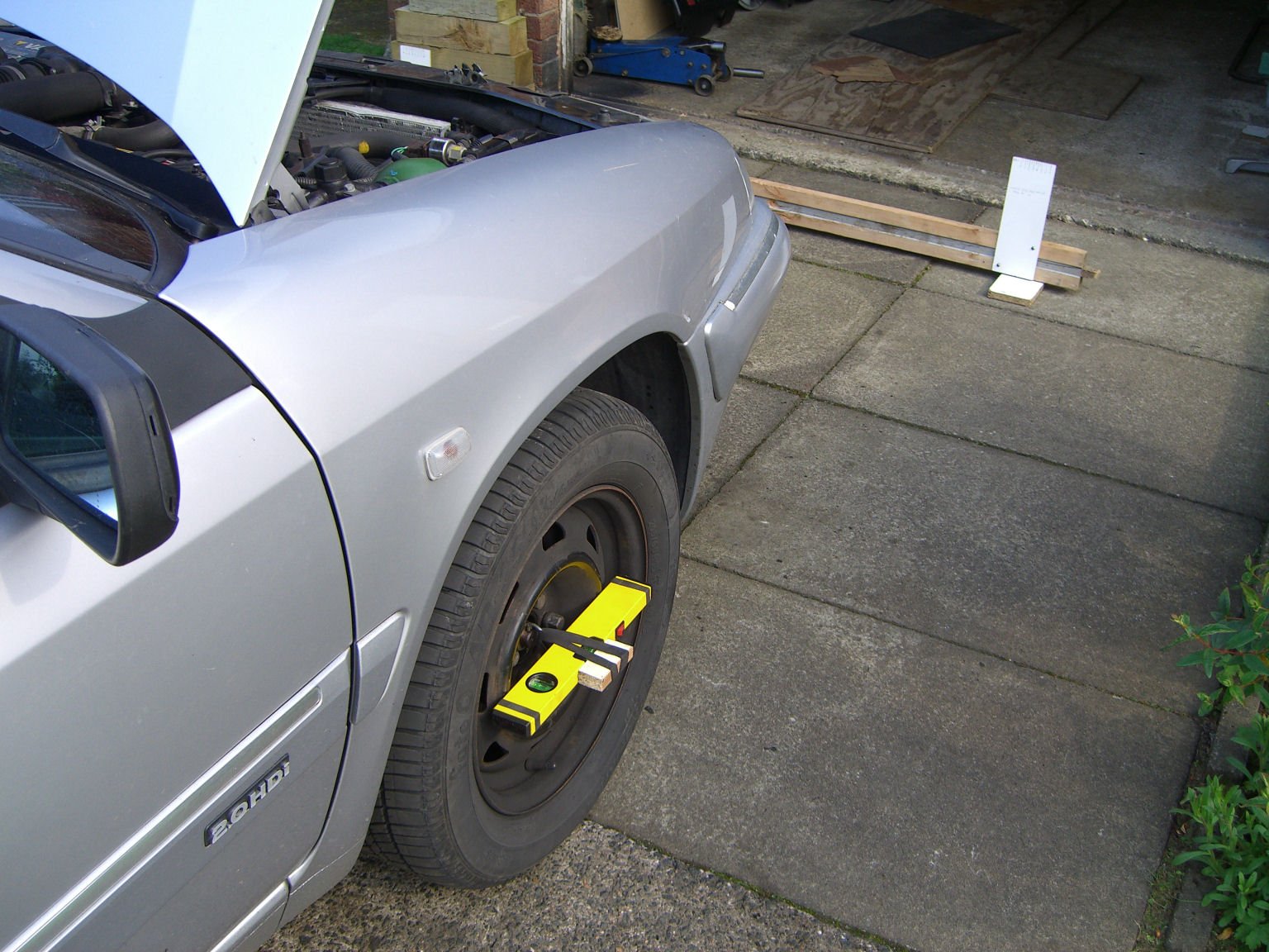

Here are photos which should make it a bit clearer. I later made M6 threaded holes in the wheel bolts, and fixing brackets to mount the laser levels onto the wheel.
Note that there is no need to align the lasers except to turn around on wheel to get both spots on the scales on the target boards.

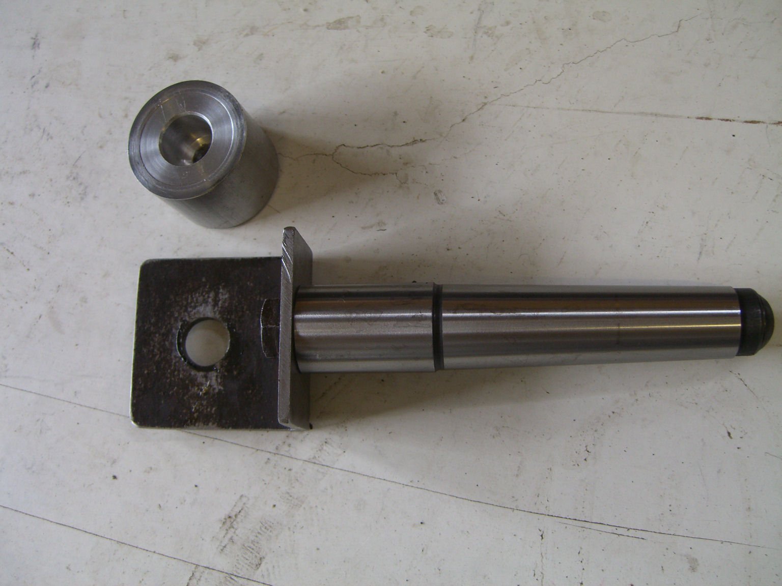

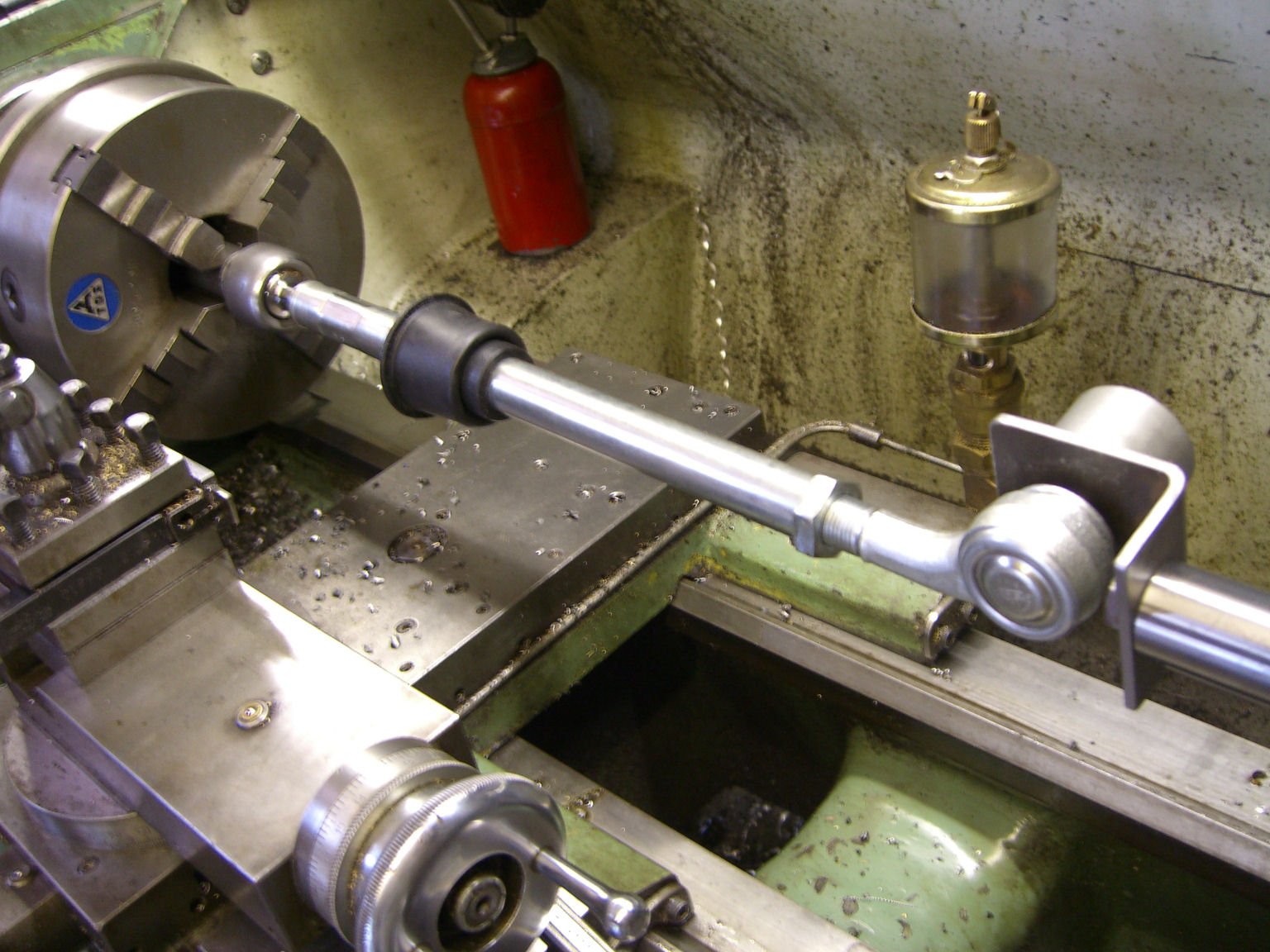

For your delectation, here is another eccentric way of doing things. When fitting new trackrod parts, and if you happen to have an appropriate lathe, it can be used measure the crucial length of the trackrod. You take the whole old trackrod still assembled (inner and outer joints), put it in the lathe, and thereby transfer the length to the new parts. Provided the old parts are not totally shot, you can get very near without having to set the tracking on the car. It does need a means to mount the taper pin square on, just a bit of plate and a turned spacer works fine.
Note that the lathe chuck is merely closed, not tightened, so that the tailstock measuring scale can be used to find the point where there is no slack. You adjust the new parts to be the same dimension as the old.

thorter wrote: 15 Mar 2023, 16:24 For your delectation, here is another eccentric way of doing things. When fitting new trackrod parts, and if you happen to have an appropriate lathe, it can be used measure the crucial length of the trackrod. You take the whole old trackrod still assembled (inner and outer joints), put it in the lathe, and thereby transfer the length to the new parts. Provided the old parts are not totally shot, you can get very near without having to set the tracking on the car. It does need a means to mount the taper pin square on, just a bit of plate and a turned spacer works fine.
All of your posts on this subject have been most delectable thorter
Your method for determining the overall trackrod length is inspired and given how the track rods are attached to the rack in the AX this is a very simple job to do and does not even need gaiters to be removed...
Excellent

That's a thing of beauty. Have you 'kissed' the steering rod up whilst in the lathe or did you make brand new aluminium ones?thorter wrote: 15 Mar 2023, 16:24 For your delectation, here is another eccentric way of doing things. When fitting new trackrod parts, and if you happen to have an appropriate lathe, it can be used measure the crucial length of the trackrod. You take the whole old trackrod still assembled (inner and outer joints), put it in the lathe, and thereby transfer the length to the new parts. Provided the old parts are not totally shot, you can get very near without having to set the tracking on the car. It does need a means to mount the taper pin square on, just a bit of plate and a turned spacer works fine.
I must say I am quite disappointed to see the the boards haven't been machined and laser etched.
Thanks for searching for your photos and uploading. That's a great help.

That was how the bits came, presumably tin flashed! Sadly, by the next year they were more rusty than painted ones. I also used the lathe setup to equalise the track rod length at each side. This can be quite far out due to previous replacements. Counting threads does not always match the lengths if parts are from different batches.
The tracking fixture was the usual "need it immediately" project. From experience, I suggest anyone making a similar setup should only put a single line on the offside boards and align that with the laser spot by moving the board slightly. Then when reading the scales on the other side, the calculation is minimised.
I found that for the least steering wander, it is best to aim for near the centre of the specified toe in/out band.
