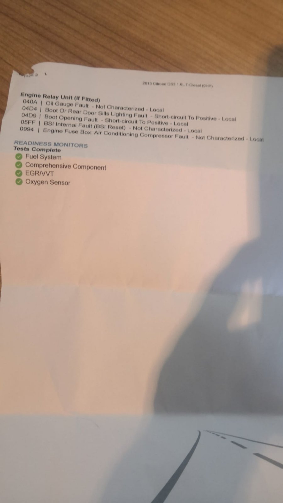

I'll have these up as soon as I can get it organised.GiveMeABreak wrote: 10 Mar 2023, 10:33
I would advise getting the actual fault codes that were picked up - or get a diagnostic done with Diagbox and put them up here as without fault codes it will be difficult to point you in the right direction.

Re: Smoking diesel DS3

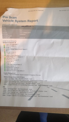

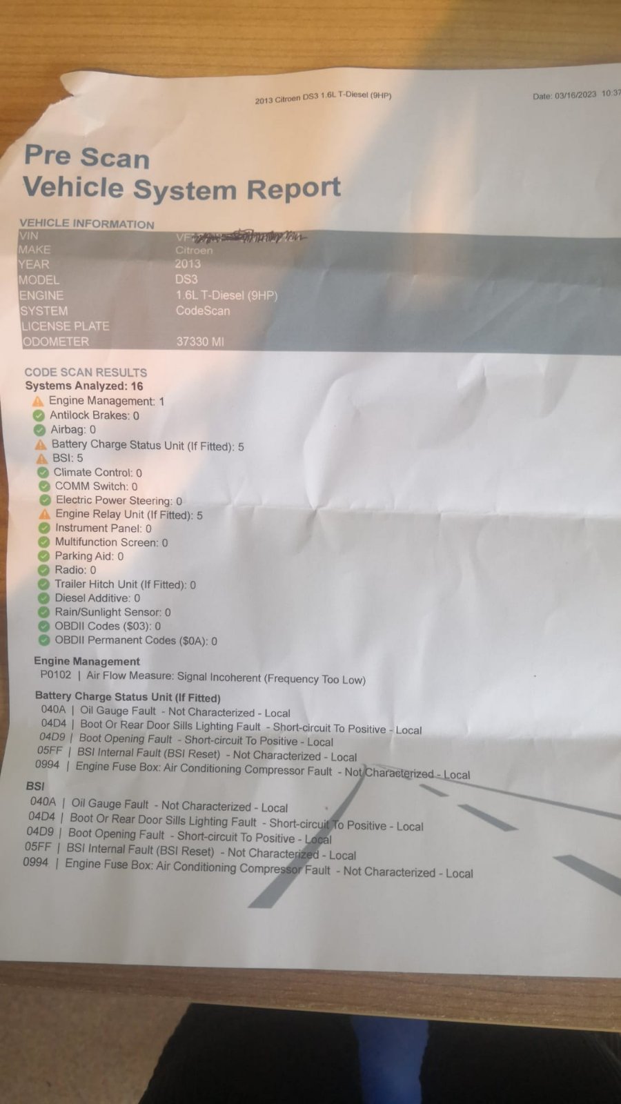

Unfortunately none of those codes are coming for your vehicle. That's an aftermarket diagnostic tool too, so maybe why.
