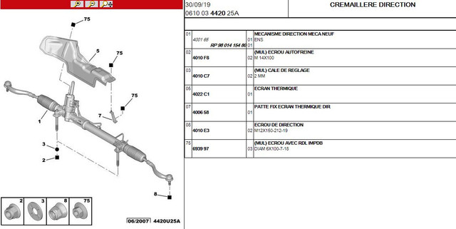

I removed the lump with a hack saw and filed down smooth, photo's are on my last steering rack thread. I believe the lump was for older hydraulic Citroens. One of my thoughts was changing rack pinion with an earlier one ie Xantia and using these threaded ports. Of course the pinion would have to fit but I suspect they do.
Just idea for you to mull around.

Ah, Found it!cedrichn wrote: 21 Aug 2020, 11:20 Hello,
I did read all the discussionAnd I like the way you look for solutions and root causes, and I also start to worry for my X7
So I went to check which rack I have on my reg 58 2.0 petrol, and it looks like i found what the screw is for !
The redundant lump is for steering rack exhaust heat shield for 2.0 (EW10) models.
I'd think not likely fitted to the 1.6 petrol turbo model as exhaust and turbo is on front of the block (not the rear like EW10
Page 25 on this thread!

Thanks Matt so it serves no purpose on our cars so cut it off and turn it down. I had a peak through the floor on mine the shaft is very corroded. So it will need a good bit of turning and then sleeved. I got under her this morning aswell to get a better look at the pipes they are not much different than brake lines so perhaps a flared fitting would work if they won't seal.
