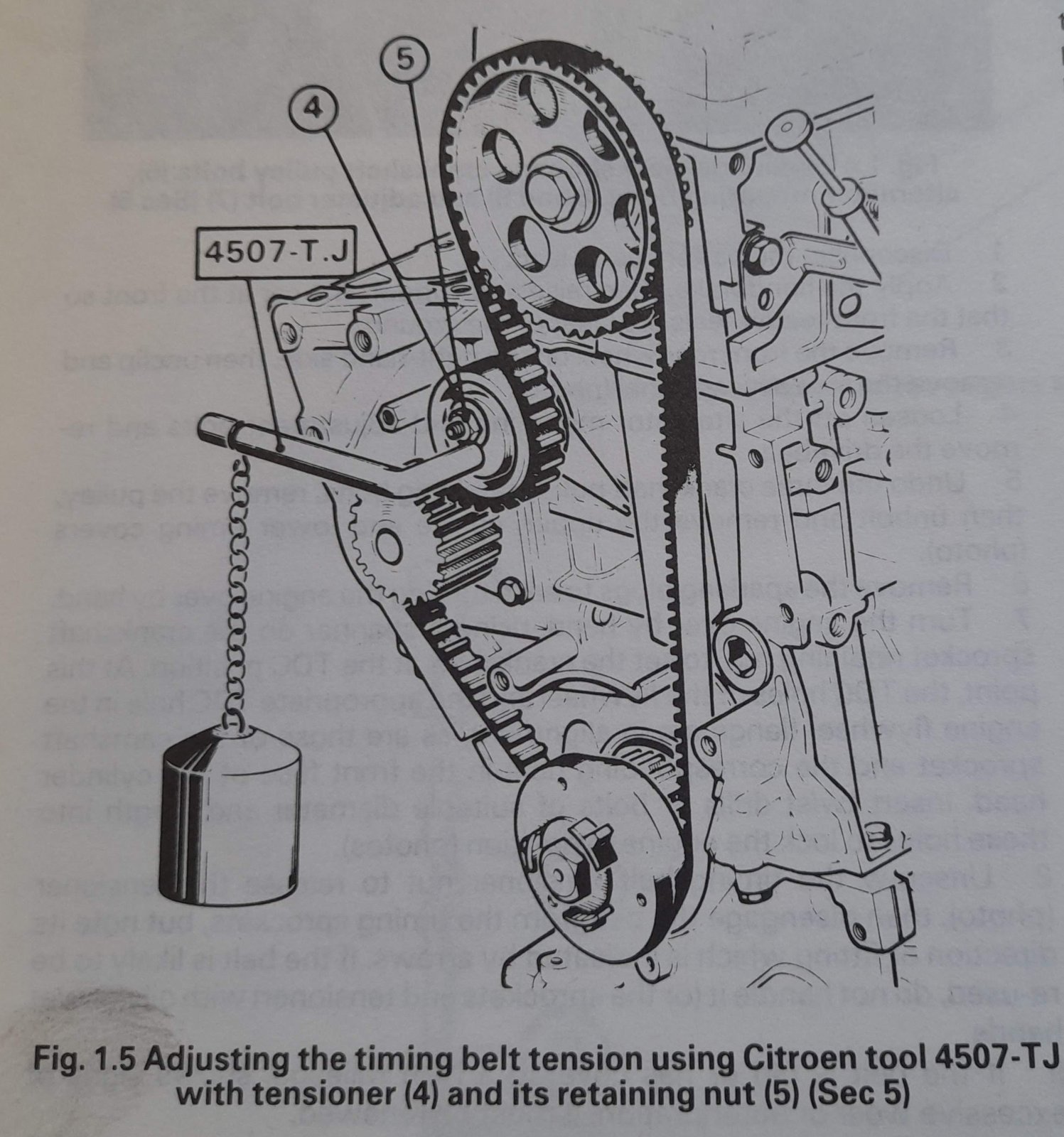

Yes indeed. I am assuming this is the 8 valve TU1 engine. It was something that bothered me initially until I dug deeply into it.
A very seemingly slack timing belt with a cold engine is entirely normal as the TU 'grows' as it warms and the tension increases... If you set the tension to what appears to be right with a cold engine it'll be far too tight when hot and it'll sound horrible, particularly at idle and will whine as the revs increase. A correctly set belt will run silently and will show very little whip on its longest run under snap acceleration.
The only accurate way to set the tension in my experience is to use the weight method as shown in this diagram I've borrowed from the Haynes AX Manual...
(c) Citroen and Haynes Publishing
Using this method is nowhere near as difficult as it looks...
You can use a SEEM gauge but it must be used with the engine hot and then you should see a reading of 45 Units.
Cold, it'll be about 23..
The 90 degree twist method will work approximately with a hot engine.
There is no automatic tensioner with an arrow - I know precisely what you mean - available for the 8V TU.
I did a lot of research into this very subject a while back and you can read bits of it in my blog on here and a big article in a forthcoming edition of the CCC Citroenian magazine. I did my research on both my own Saxo and AX which both have 1.1 TU1 8V engines.
My blog shows the weight method in use.
Hope that helps.

Thank you for this excellent reply, gives peace of mind.
The belt I removed was 100 teeth and had one of those spring loaded pointers on the tensioner, and the new belt has 100 teeth and the same gadget, like on my Fiat and some Renaults.
Both crankcase pin and camshaft sprocket pin were good, but on turning the crank with a socket, it appeared to take up slack on the belt between the crank and the cam. and was more than the half twist on the belt.
But I can re-assemble it now, thanks to the knowledge that the engine "grows",
Does this mean that snap acceleration after cold startup risks slipping a belt ?

xsaras4ever wrote: 09 Mar 2023, 17:51 Does this mean that snap acceleration after cold startup risks slipping a belt ?
I'd say you'd be very unlucky if it did but always a good plan never to rev a cold engine too hard or too eagerly when cold... And the little TU soon warms up ;)
