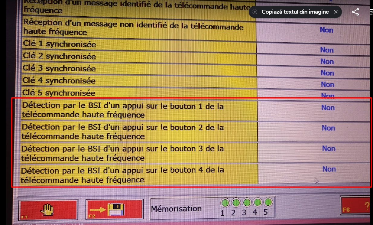

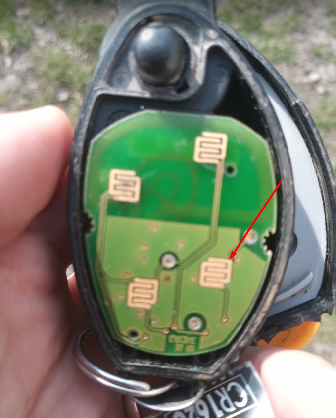

Who knows, what this 4th button can be used for?
I see it in Lexia:

4th button on the key fob is probably for C8 model sliding doors.
Never seen a C5 with more than 3 buttons

My C5s had the same, four buttons on the PCB but three on the fob.
I believe that the fourth was for models where the tailgate or hatch could be unlocked only.

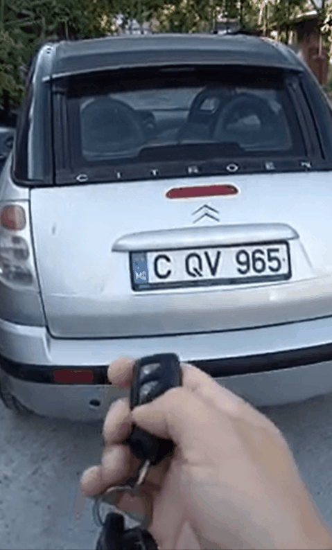

Was playing around with lexia, and there are no options to re-program the buttons.
On my Pluriel, I used an after-market alarm, which let you re-program the buttons, like this for example (it's a gif, will open if you click on it):

Agree, the only way is an aftermarket remote controller, which can be programmed more flexibly, as I did on my Pluriel.
