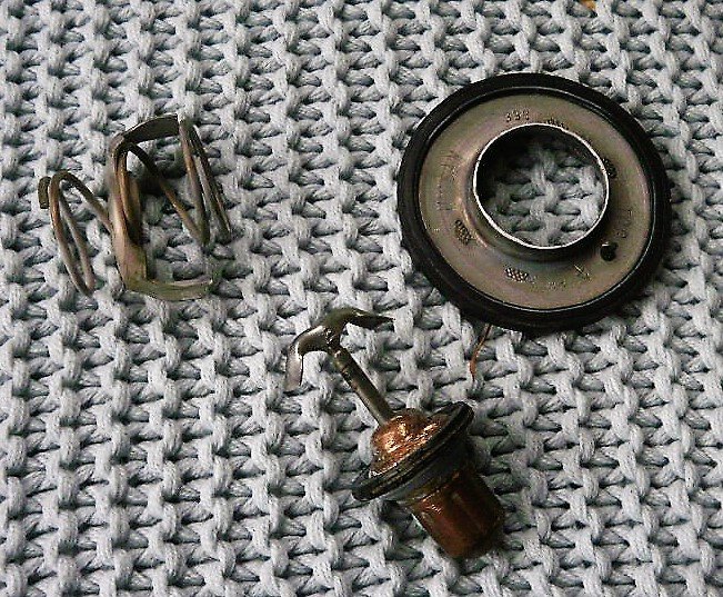

Here's an easy job, to solve a problem of a thermostat stuck shut, and a over-rapidly heating up cooling system.
No real difficult access problem, 3 little bolts retaining the plastic thermostat housing specified at 7 NM, barely more than finger tight. New thermostat purchased, just pop it in with its rubber sealing ring, and bolt the housing back up. Followed all the appropriate draining and refilling and installation stuff as per the official tech manual for the 2005 K12 which I have courtesy of the net.
First attempt.....thermostat housing leak. There is the temptation to just tighten up the bolts a little more...totally ineffective and very probably damaging (didn't stop me gently doing it!)
Second and third attempts followed on using first sparing application of first the instant gasket, then the cavalry of the blue hylomar. The hylomar worked nicely at tick over but at 3000 revs spurting coolant from the housing. Back to square 1.
At this point I began to lose confidence in the new thermostat, and its rubber seal, and the plastic thermostat housing in general. So a plan came together. The original thermostat was a genuine Nissan article, maybe it just fitted better, but of course it wasn't working. Does anyone ever "repair" a thermostat
I definitely got it to open with a bit of heat...the sort of heat that a gas ring outputs! but couldn't put up with a sea of frustration "freeing" it off (even if that was possible), reinstalling it and hoping it would work, and returning to square 1.

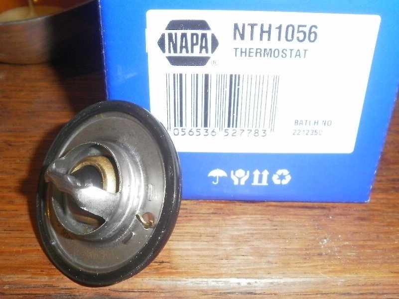

So what have I done....this, and the cause of the previous failed leaking thermostat housing...
...the new thermostat. Compared to the original which was tight in its recess, the new one was noticeably slack. Looks the same, even took the original in to compare them at the factors, but subtlety different.
This was the new part...does look identical but didn't fit properly. Neil
