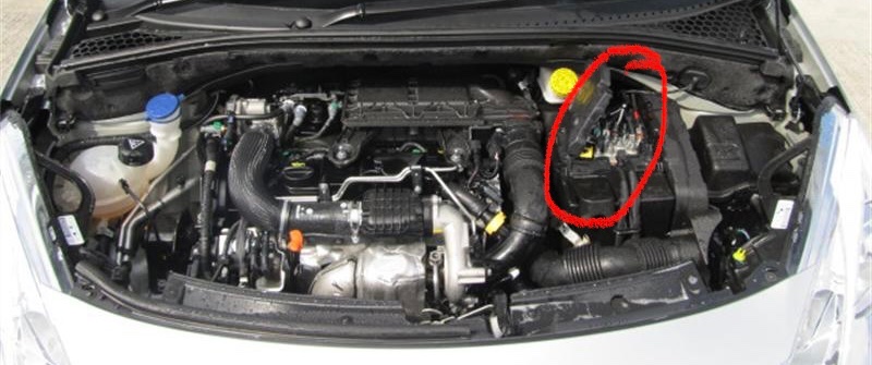

Does someone know what is this cable for ?(pictures attached)
Long story short- the car has an “engine fault “ showing on the small radio display- no engine management light on the dash.
ECO mode deactivating as soon as I start the engine and won’t go active no matter what.
On the next morning the car couldn’t start cos the battery was flat and I found a parasitic draw from the cable on the pictures. I found out the alternator won’t charge the battery then I’ve changed alternator + battery( battery was dead- probably shorted) - the car now starts and runs normal but “engine fault” on display still there and ECO mode won’t activate same as before.
This cable needs to stay disconnected otherwise it drains the battery overnight.
The cable goes to F3- 40A fuse on top of the battery.
I suspect short with whatever is on this cable, but can’t find where is the cable going to. Diagnostic not really helpful. Showing BSI sometimes but it clears and stays clear and the faults are still there.
Any idea?
Thanks in advance!

GiveMeABreak wrote: 06 Mar 2023, 23:38 The BCP3 (Relay 3 protection switch unit) has three fuses, F1, F2 & F3. All these Fuses are 40A and are for the heater protection - Air Conditioning.
Hi, thanks for the fast reply!
I don’t have 3x40A there. Only 1x40A, then 30A,70A and 2x80A as shown on picture.
Or maybe I didn’t understand what you mean? 🤷???
Thank you !
EDIT: these are the fuses on top of the battery.
Picture for location attached.
I guess you already know that but worth mentioning.
The fuses there are F7,F3,F6,F4,F8(unused) and F5 in the same order left to right.
x 6961

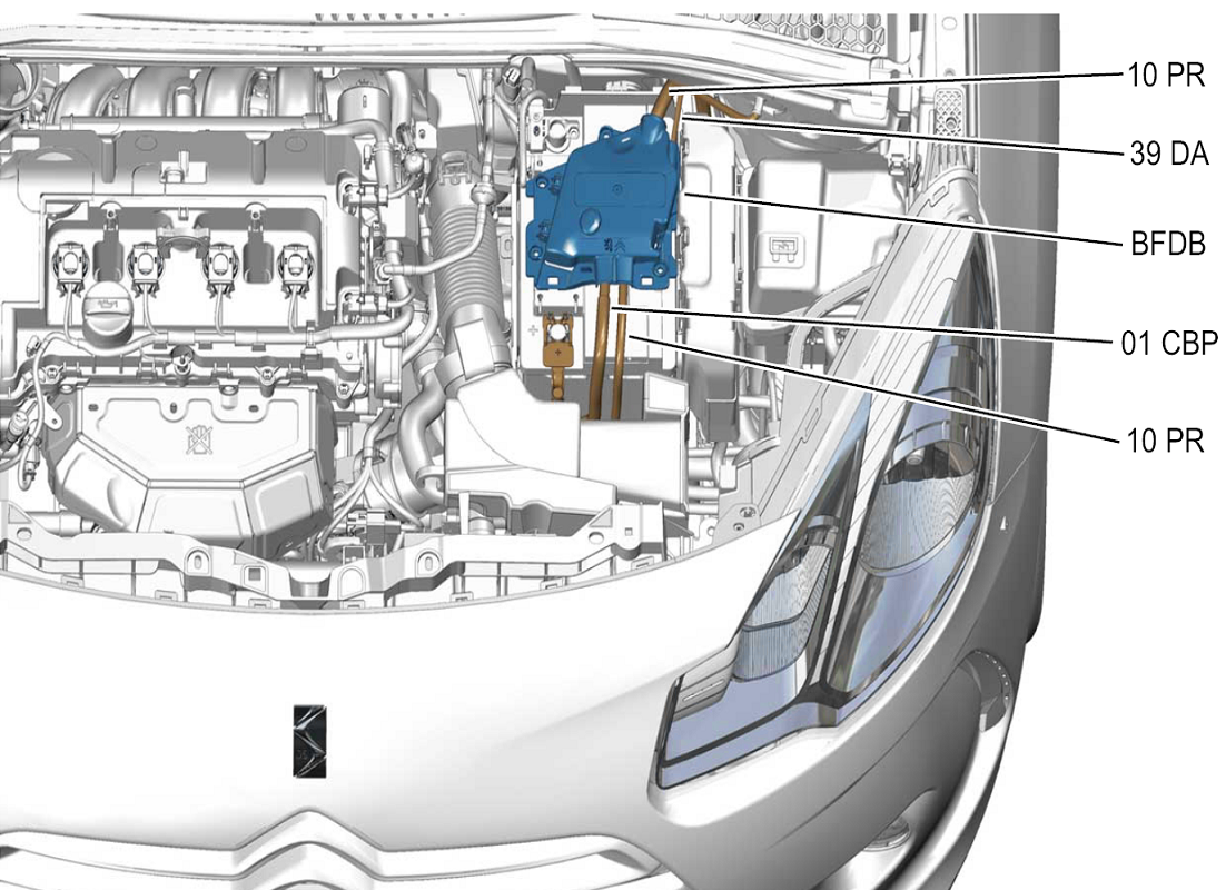

Re: DS3 electrical problem
No, that's not the same place. What you are showing are the main Maxi Fuses, which is not the same as the BCP3 unit.
If you have your VIN, (please post your VIN in full without spaces - it will be automatically masked from public view after submitting your post & will only be visible to staff), I will be able to look at the specific diagram for your vehicle, but the BCP3 unit is separate to the maxi fuses:
Here's the Fuses:
PSF1: Engine compartment fusebox panel
1021: Reversible alternator
BFDB: Fuse box at the battery outlet
BCP3: Relay 3 protection switch unit
1031: Battery charge status unit
1012: Centralised voltage maintaining system
Here is the BFDB (Fuse Box at Battery Outlet):
