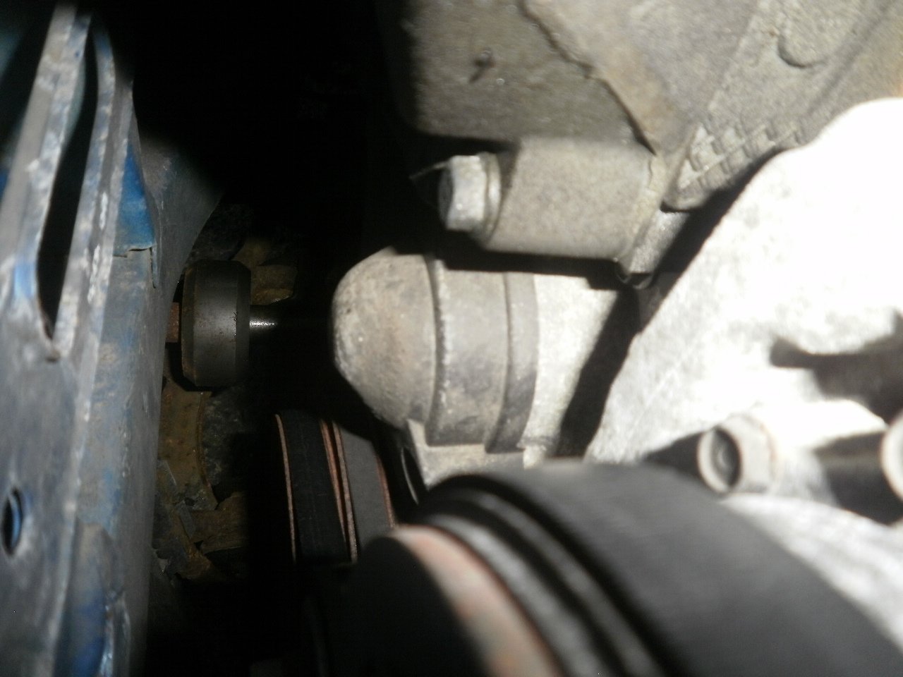

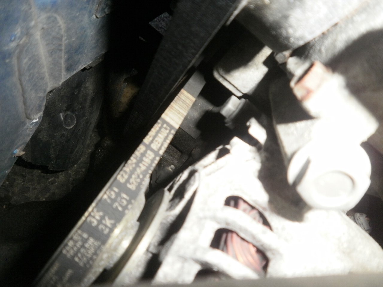

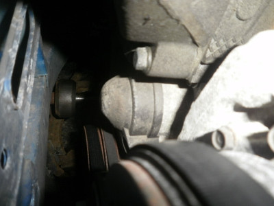

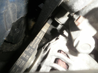

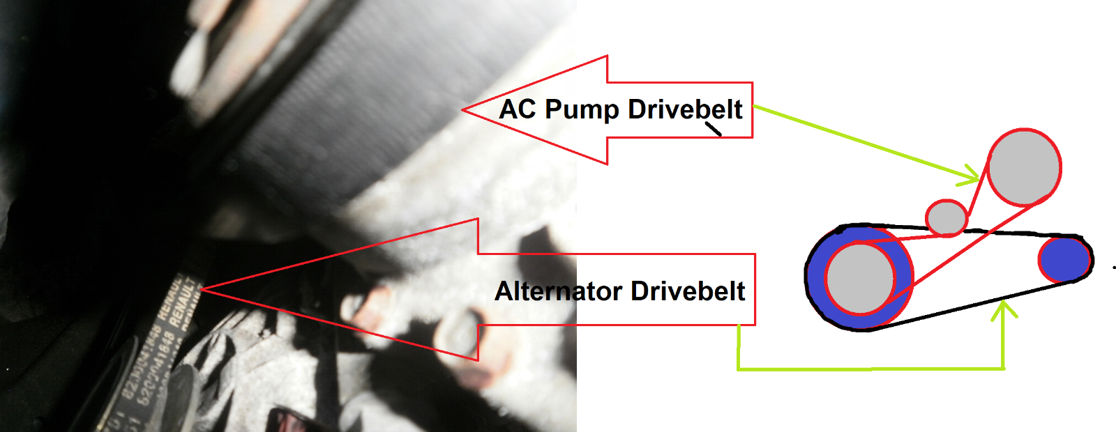

To add a little bit to what has already been said, I can confirm that the Clio 2 1.2 16 V when fitted with air conditioning has 2 separate drive belts. One from the Crankshaft pulley to the Alternator (the thin one) and one from the crankshaft pulley to the Air conditioning pump (the thicker one).
Also the very easy access to the alternator drive belt in the video was for a model without Air Conditioning, but true enough the procedure for renewal of that belt is as the video, but as JG points out access is awkward. Only a couple of bolts to slacken on the alternator to move it to take the tension off the belt and remove it, and similarly on re-tensioning the new belt so not that difficult, and access from underneath probably is the best bet for that belt.
Here are a few pics of the Clio 2 in my maintenance fleet hopefully it shows the two drive belts. They are literally, ( in spite of the slightly duff photography), the finest pictures of the two belts in situ on a D4F 1.2 16V Clio 2 with Air Con anywhere on the world wide web.
the two belts and my own diagram of how I imagine they run
The two belts on the crankshaft pulley<br />left of picture  AC pump drivebelt<br />right of picture Alternator drivebelt
AC Belt  Left of Alternator drive belt<br />Alternator Drive Belt Original Renault Markings (right)
