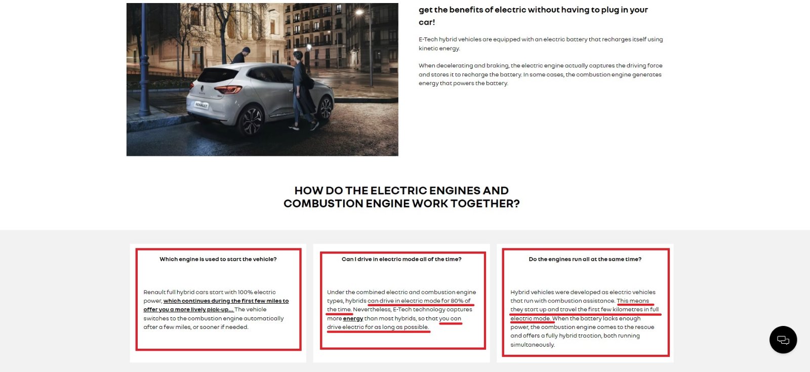

I'm trying to canvass other Clio Hybrid owners to see if they have the same problem as myself?
I bought a new Clio Hybrid in July 2023 for the first few months all was well and I was getting 59.9mpg, I went on vacation and on my return in October I started to notice that although the EV battery was 90% fully charged the ICE was still running and on trips around town would not switch over to the electric motor, it did not appear to return to normal until the ICE was fully warmed up and I saw the mpg was dropping to 50mpg.
Thinking there was a problem with a engine sensor I left it hoping it would go back to normal, also thinking it was electrical I tried various things what I did find is before the ICE was fully warmed up and the battery was over 50% charge if I switched the heater fan off the car would then switch over to the EV mode but when I switched the fan back on the ICE would kick in again, thinking there was still a fault I booked it into the dealer where I had bought it.

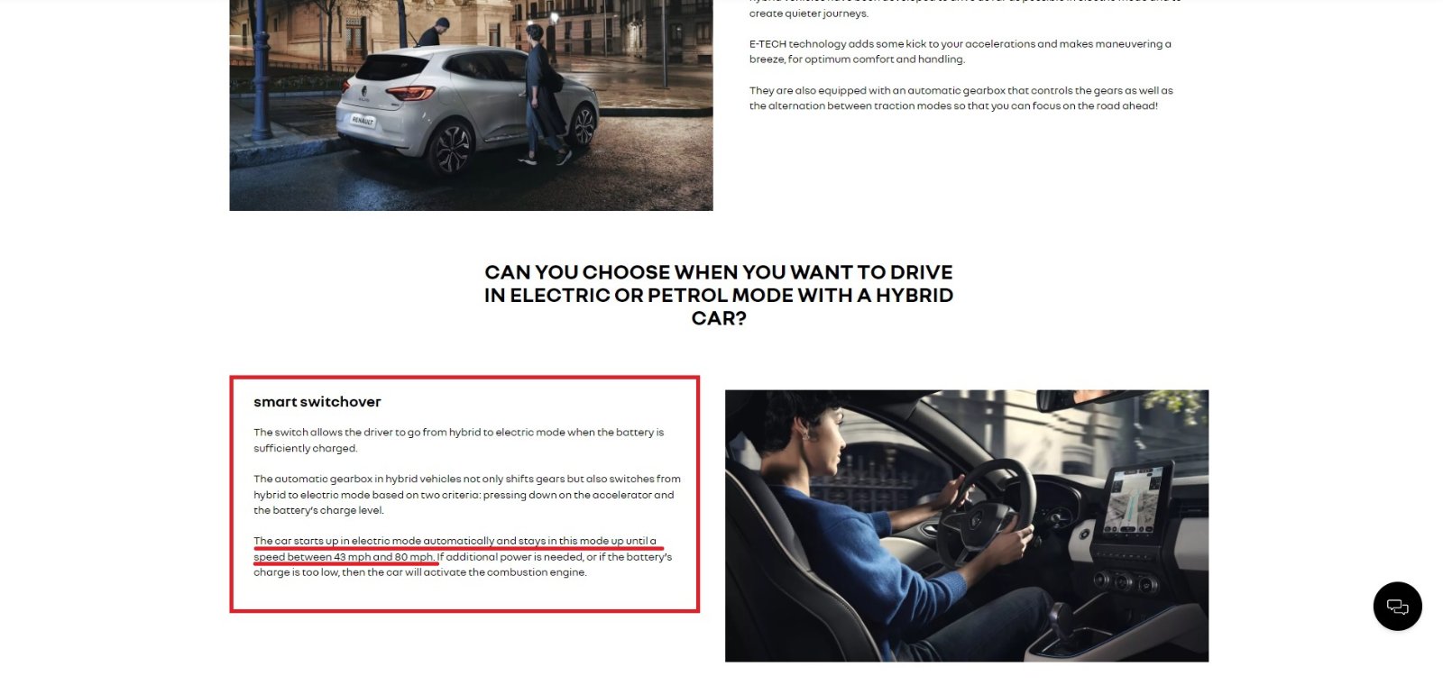

On arrival at the dealers I was met by a mechanic who told me that because the weather was cooler the EV mode won't kick in until the ICE was warmed up, by now I was only getting 40mpg. I argued that the Renault UK website was boasting that drivers would be using EV mode 80% of the time and the vehicle would start in EV Mode neither what was happening with my car, I certainly was not made aware of this on purchase.
I've now sent a complaint to Renault UK and their response was the same as the mechanic, I replied with screen shots of their website which clearly shows the opposite to what they are trying to make me believe.
Therefore before I take it further I would like to find out from other owners if they are experiencing similar performance? so any responses are most welcome.
Kind regards.
