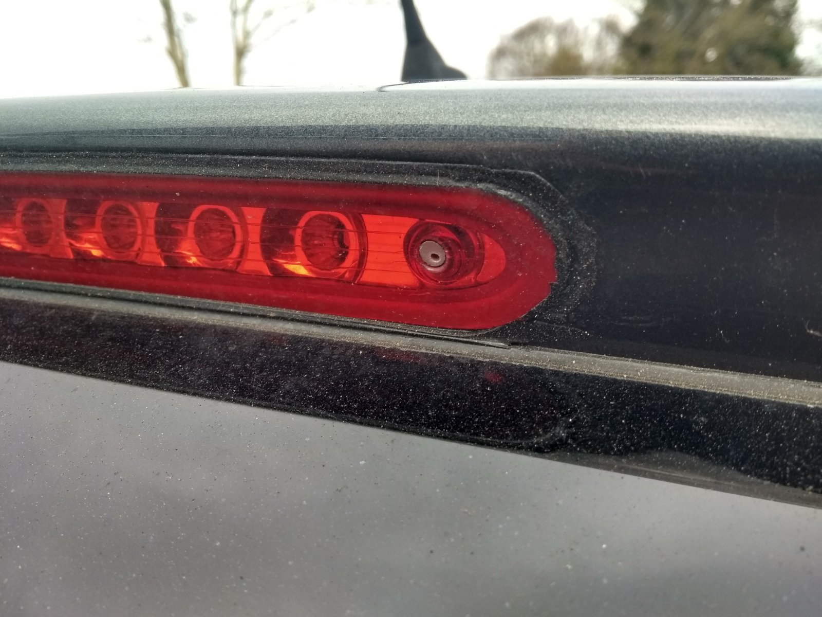

Although it's impossible to see, I could get a finger in and it was definitely set around the brake light. I undid the nuts, but it still wouldn't come out easily - a look at the unit on eBay seems to show a sort of foam seal, and a couple of clip type protrusions on each side. I guess some 'gentle' persuasion would have popped it out. However given that the seal is not available on its own, and I wasn't forking out £100 for a new light, decided I might as well seal it in. Out with the masking tape...
(Supposed to be a pic here, but phone decided not to save it...)
Sealed it round with the black silicone, see if that stops the water coming in!

Sealing looks to have been a success, sealant only just visible if you look closely.
Trim refitted so it's bound to leak again now!
