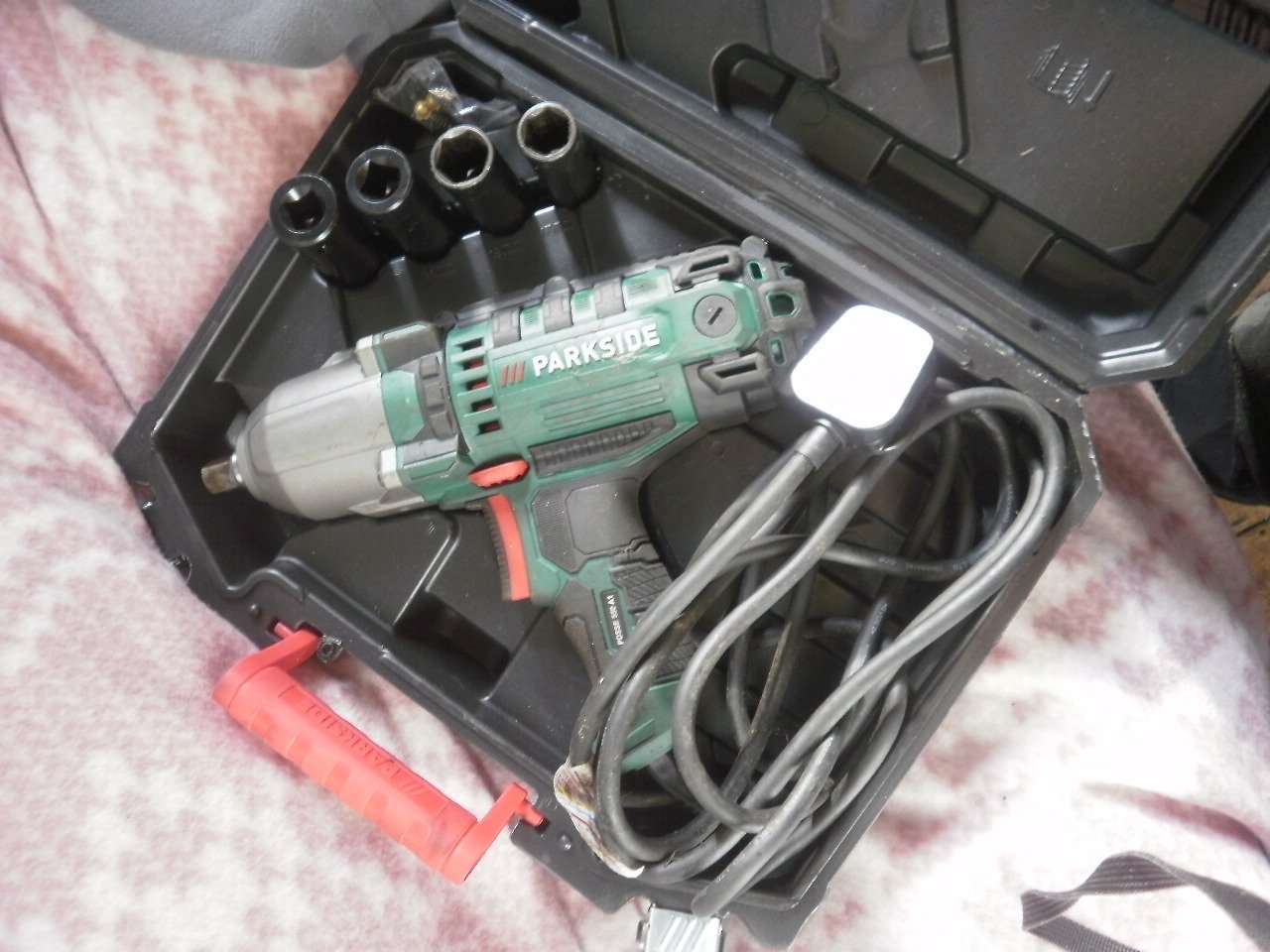

So that was 2010, in 2023 as part of insurance if the hub nut proved too tight on the Clio when doing the driveshaft I bought this to put in the arsenal in reserve.addo wrote: 03 Jul 2010, 12:14 I can assure avid readers, that the 18V Snap-On cordless rattler has plenty of poke. It'll crack damper bolts without a worry. Shame that at about USD$550 plus posting, I can't afford one!![]()
100 NM tightening 500 NM undoing yes attached to a cord, but 4 free impact sockets probably £20 of anyone's money on their own and the whole package £49.99 from Lidl in 2023.

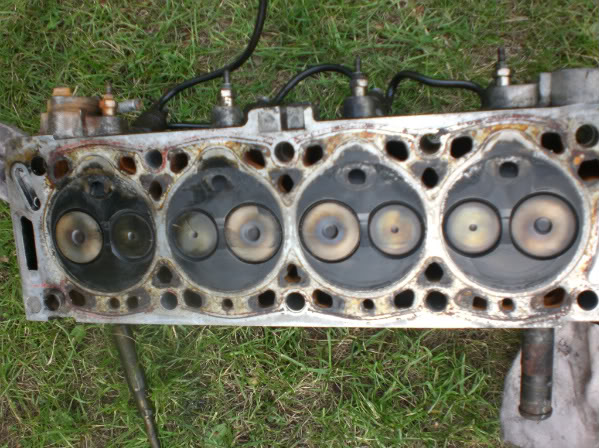

I'm sure if you had been on the forum back in 2010 you would have chipped in with some useful help. This was my get to know the Xantia intimately phase. The short story was broken cambelt and resultant broken camshaft and caps, probably one bent valve. Not much wrong with that head but the easiest and quickest route to resolution was to take the head and associated paraphernalia off my old Xantia 1.9 TD, and install it on my Xantia 1.9TD under resurrection. It worked after much BS&T, and guidance along the way from the FCF.mickthemaverick wrote: 17 Feb 2023, 18:48 Finding a suitable anchor point inside the engine bay did result in an extensive examination of the cylinder head from above! Does that count?![]()
I think we can risk a pic of the old cylinder head from 2010!
