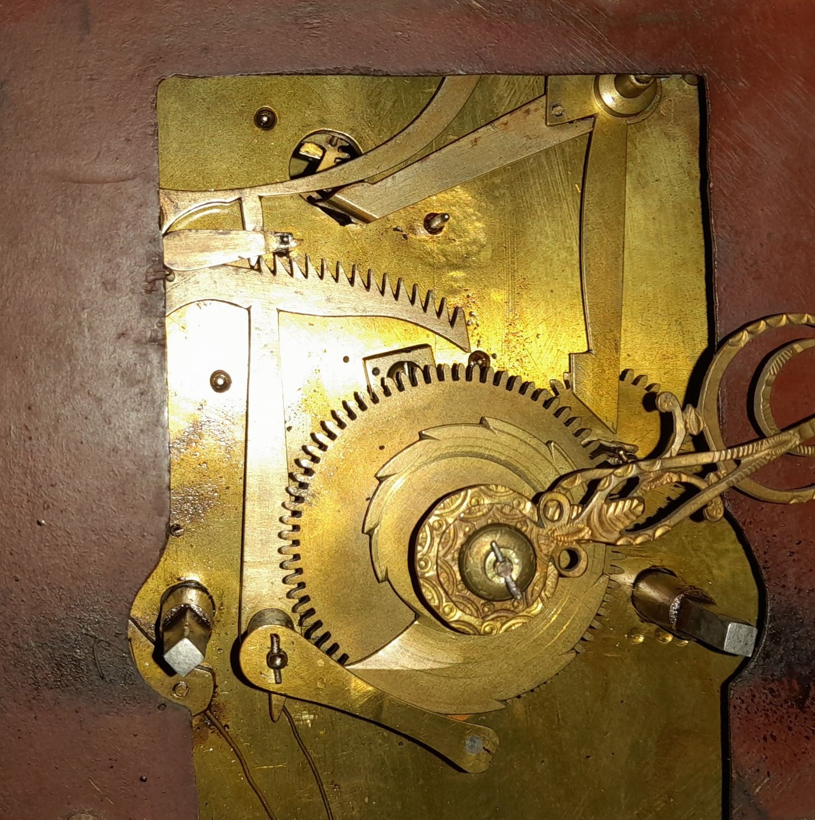

So today, being stuck at home, I looked to resolve a small problem on my recently overhauled grandfather clock. The going train has been running magnificently and it's keeping perfect time but the striking train has been suffering occasional bouts of over-enthusiasm... It sometimes and randomly strikes more than it should and it's not good to hear thirteen strikes at 8 o'clock or 15 at midnight :o: :lol: It's quite off-putting and it means things are not perfect so must be rectified...
With the face off, I could see that occasionally the strike count rack would fail to advance properly and would either miss a strike or even slip back...
There are two possible causes - the gathering pallet being 90 degrees out of phase and/or the rack tension spring - the hairpin shaped spring in the bottom left of the picture - being a bit over-tensioned... I did think it was a bit weak during the overhaul and may have overdone it a bit...
I've readjusted the rack spring tension and advanced the gathering pallet by 90 degrees. So far, with a manual advance right round the dial all seems good. Fingers crossed...
On long-term test now with the face off but hands on. The face will go back on again once I'm happy all is 100% good.

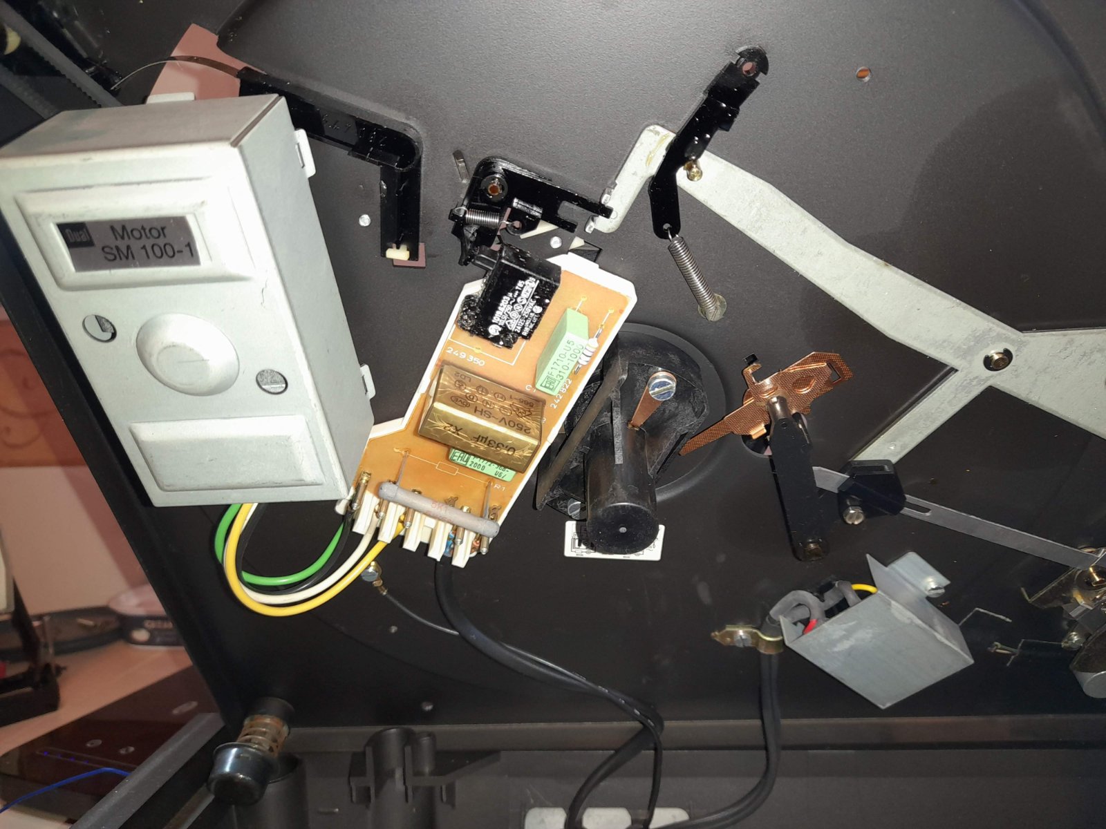

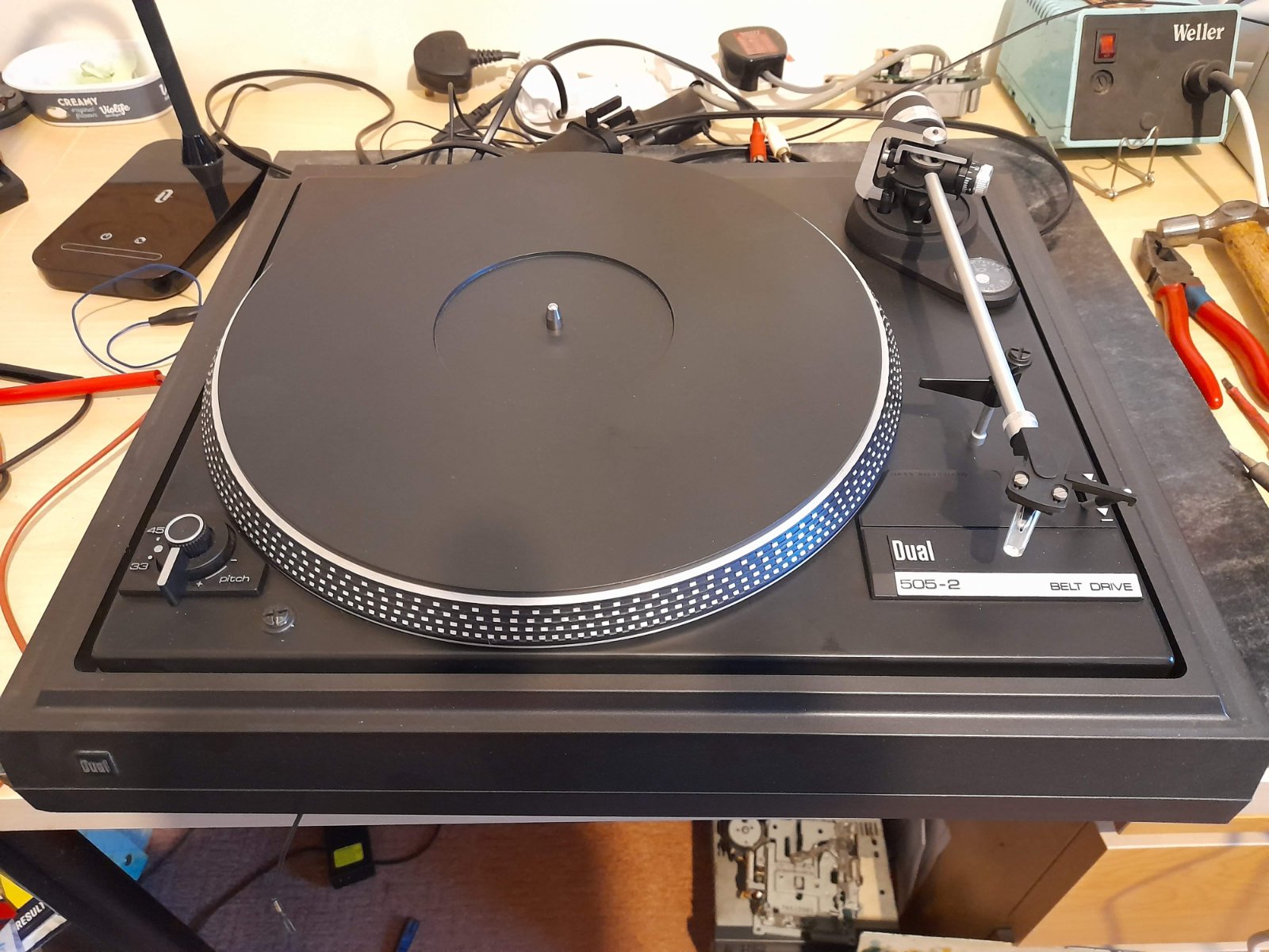

My record deck failed to spin the other day and today, still not being well enough to run, cycle or play cars, was an ideal time to look at it...
The first port of call was the microswitch, operated indirectly by the tone arm, but that was OK...
The culprit was quite a surprise... The motor mains supply and the switching between 110V and 240V is via push-on connectors. One or more were a bit intermittent... A bit of 'wiggling' and it all came good... All removed and cleaned/retensioned... It now seems happy.
I note the presence of a 'Rifa' Class X suppression capacitor on the little board - the yellow 0.33uF one. These have a very nasty habit of turning into very smelly smokebombs and are best changed on sight... When they go, they go with an alarming, albeit impressive bang and produce an amazing amount of acrid smoke :lol:
Much debate has been conducted in the vintage radio forum as to why they fail and the conclusion is the micro-cracks you might just see visible in the encapsulation admits moisture over time. The last Rifa I hade go off - two simultaneously in fact - was in my Kenwood Chef food mixer whilst kneading dough... The bread was OK but the kitchen reeked of them for days...
Some new ones are on order as I currently have none in stock...
And back in action playing a jolly good record... One of my all-time favourites.
