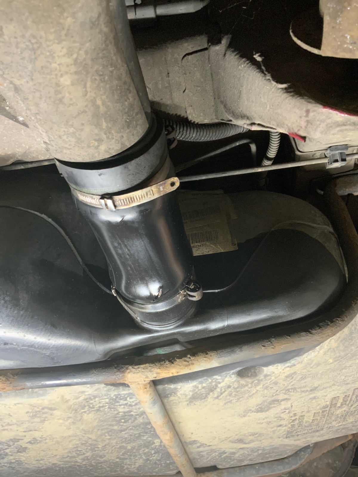

Hi I have Citroen c8 2.0hdi which as you can see from the picture it has a crack in the hose
from the fuel inlet to the fuel tank so does anyone have a part number or could I replace it with any hose and if so what size I would need please

Ok could it be replaced with this

Re: Fuel pipe replacement
https://www.autosiliconehoses.com/blog/ ... or%20fuel.
This site suggests no, silicone hoses not "fuel or oil safe"
There some hoses specifically listed as filler neck hoses on eBay, if you can confirm the diameter of the pipe spigot (check both ends in case differ!
Looks the same but worth checking) then such as this:
https://www.ebay.co.uk/itm/203539887372
Look a potential option, even supplied with Jubilee clips (don't think the existing ones will be reusable)
I'm not sure how easy it'll be to measure without removing the existing hose, and given its cracked that may not remove without breaking up.
