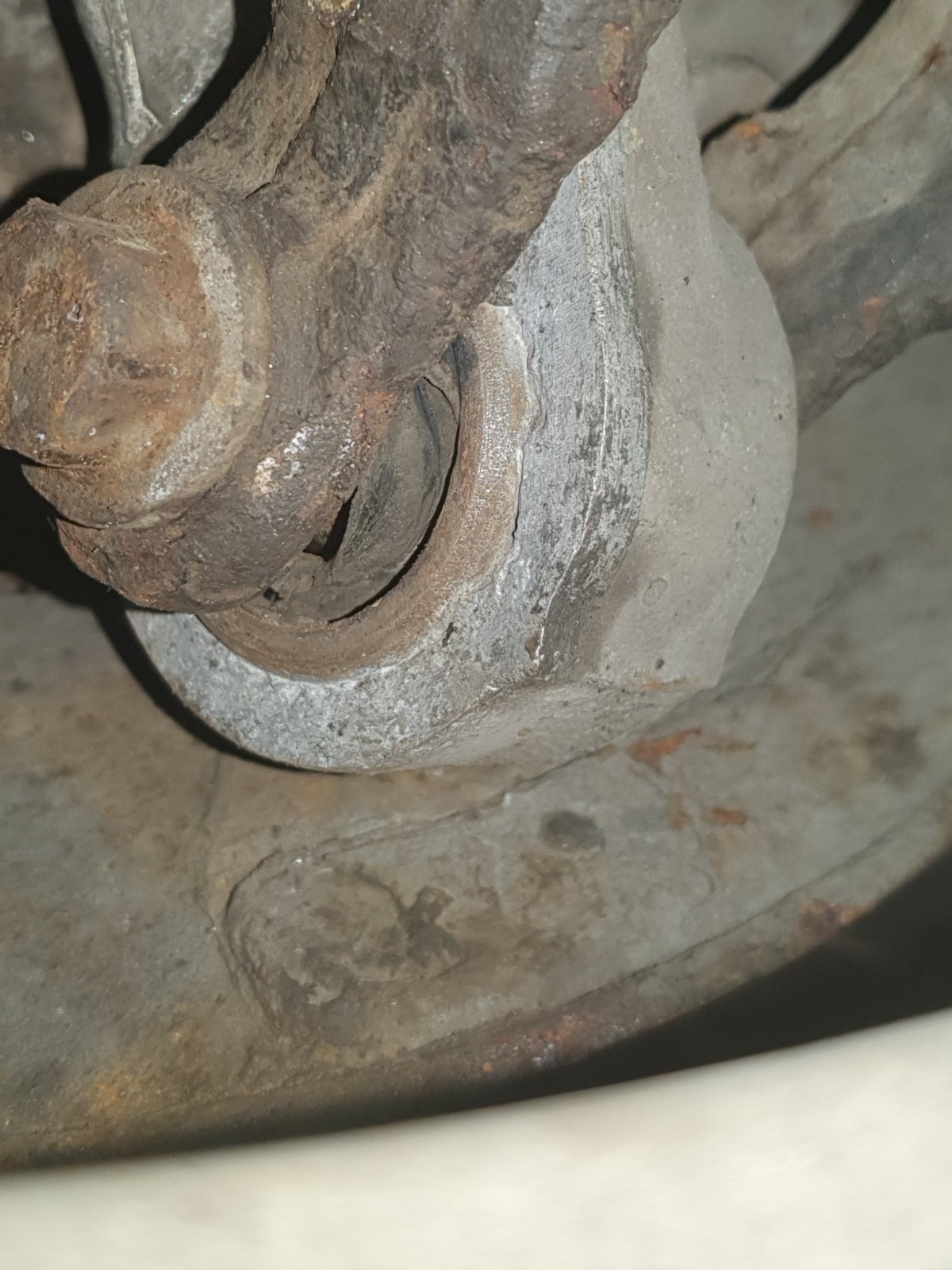

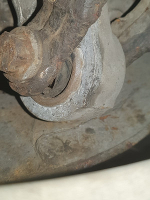

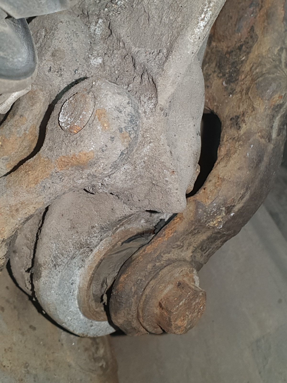

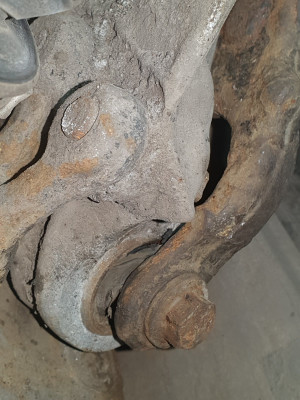

The lower front arm outer bushings have failed, again. After only 13 months and I don't do a lot of miles..
These were supplied by TMS motor spares and fitted by the so - called Citroen specialist I took the car to a year ago at a period where I couldn't carry out any work myself. They replaced the front bushes and all was well. But as I was refitting the RH arm yesterday after replacing the inner bushes, I noticed the outer one was totally gubbed.
These were 'Meyle' brand parts. Are these then to be avoided? I'd always considered these to be a decent brand.
I've ordered another pair of these that I'll replace myself. There is a possibility the garage torqued up the arm fixing bolt with the car on a lift and the wheels hanging down. I don't know the exact procedure for the C5 but on the Xantia you tightened the inner front bush bolt only when the car was at normal height or the arm outer lower end was about 8mm below the subframe. This meant the rubber bush flexed within its expected range. I guess you do the same on the C5? Tightening this with the wheels hanging free would have the bush heavily pre- twisted at normal suspension height and even more as the suspension deflects upwards.. Of course, I don't actually know if they did this wrong and it might be the bush itself is poor quality but given how badly they messed everything up with the steering rack... well..

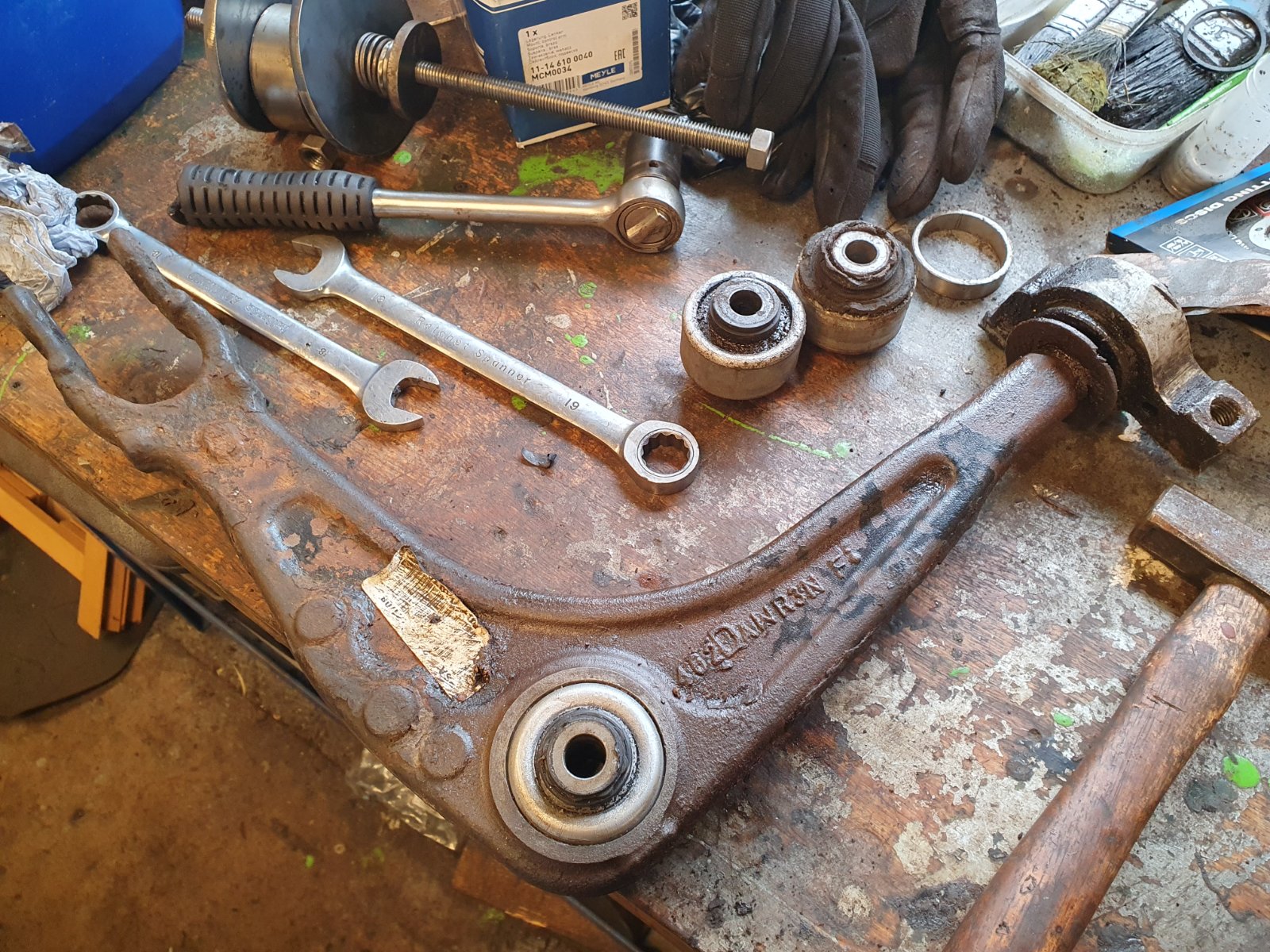

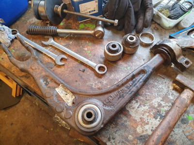

Incidentally, the inner bushes I replaced yesterday didn't really need replacing. Once the arm was out and the bushes cleaned you could see they were unworn (unlike the LH side ones changed a few weeks ago) so all the play I felt at the RH side was caused by the outer bushing - I mistakenly didn't even check it because it was only 13 months old.. Always check everything!! Anyway at least all 4 inner control arm bushings are new now.
Nice shiny replaced inners...
