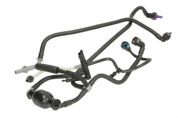

Replaced three of the glow plugs, the one behind the EGR can wait until I get more time. Two out of the three were ok, 0.9ohm measured, one was a dud, open circuit. Hopefully tomorrow I wont have the glow plug warning flashing at me.....
I did find that the fuel pipe under the airbox has rubbed a hole in it... I'll put up a picture, so Marc can help me with a part number.....
Also need a set of pipes for the power steering.... as I have a leak from the metal piece where it clamps to the bodywork...

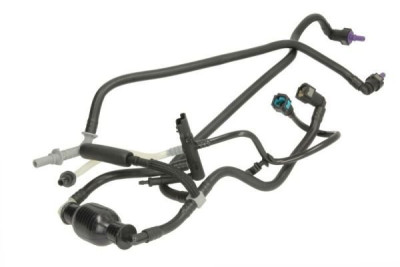

Quick google search found 1574T0 as the part number.....
Looks like its only available as a full fuel harness.... Might as well replace out the fuel filter at the same time...

Correct that's the Injection Pipe Harness, £157 from Citroen Inc.

Well, £80 inc vat from General Traffic..... arrives tomorrow am. I'll post up some pictures.... Autodoc is cheap, but you have to wait weeks for it to arrive from Germany.

Well, Im fault free.... The EML went out the following morning. New harness fitted, and I found that the air box has been rubbing against the fuel pipe. Both badly worn where touching. Im surprised that this hasnt been part of a safety recall, as I had diesel dripping onto the engine. Luckily it was only the fuel return pipe back to the tank, not a high pressure one. Also replaced the fuel filter whilst I hat it to bits...
