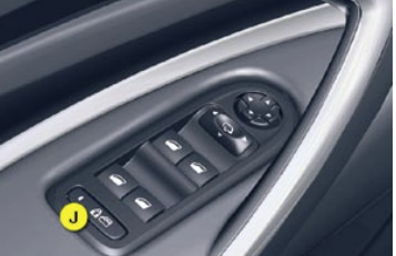

This is the button and it has 2 functions:
This deactivates the controls in the rear of the vehicle, both for the rear windows and for opening the rear doors from the inside. The electric child safety device is activated by pressing on button J .
The activation of the function is indicated by a message on the instrument panel screen and the light on button J.
So as said, if the light and or message is not coming on and the functionality is not working, then I suggest you carefully lever up the control unit with some trim removal tools, and check that the plugs are securely locked in place.
This won't be the first time I've seen these plugs come loose or fall out as a result of the doors being slammed.

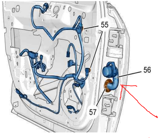

Ok, so if you have confirmed that the switch plugs are intact within the underside of the module, then the next thing I can suggest is the wiring loom in the driver door aperture. There is a plastic guard that protects the wires as the door is opened and closed, but over time the wires inside can become flexed and stressed, causing breaks. If the control wire (s) to the rear doors are broken, this may be why it is not working.
The lug can be undone so that you can inspect the wires.

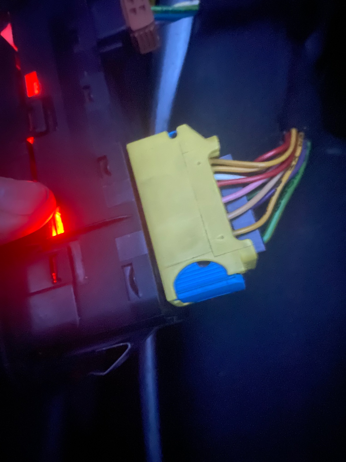

Re: Citroen C5 09 estate windows only go halfway down

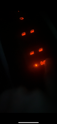

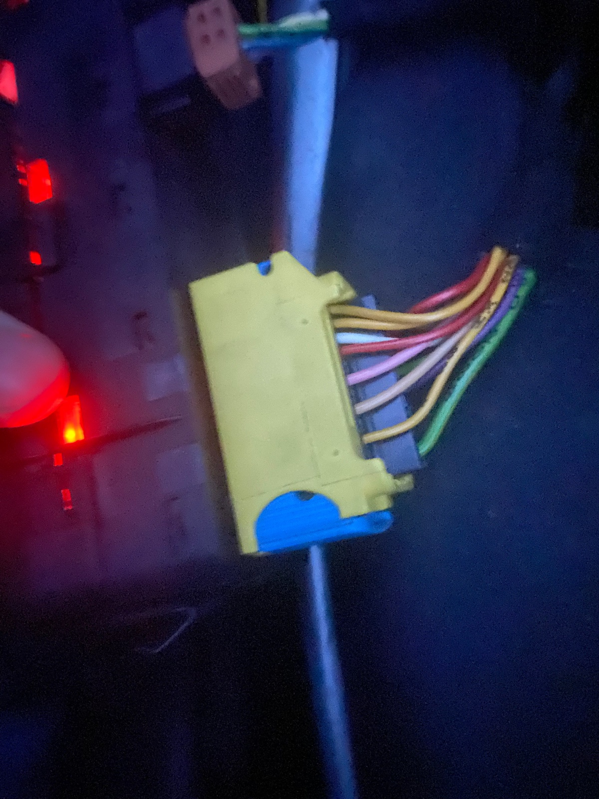

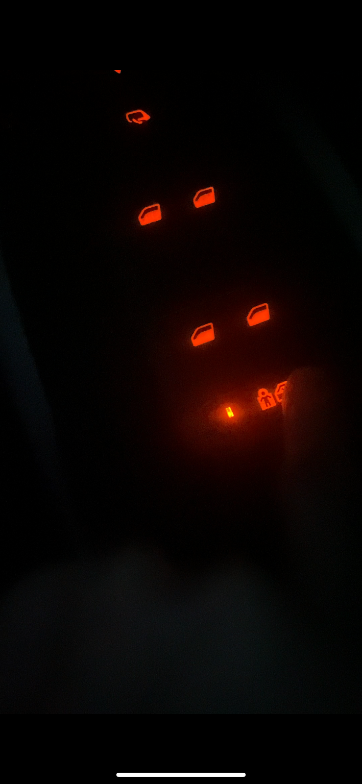

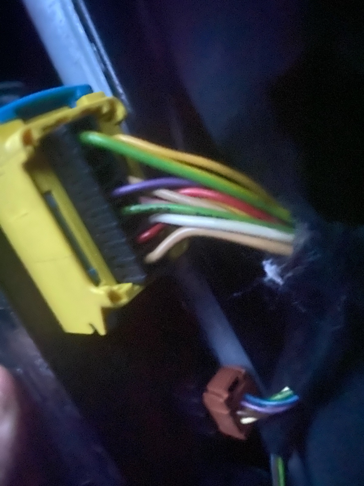

Here are some pics of connector blocks and the switch that does light up for a second then turns off, I don’t get any messages on the dash or anything either
Well the light on the rear window / door opening button on the driver's control panel is not supposed to go out when activated. If it comes on and goes off, there is a fault. That will be why it is non-functional.
Further, when the system is active the lighting of the rear door opening lever is not lit (more easily seen at night of course). When the system is deactivated the door opening area is lit. So that's another way you can see if the system is active.
So there looks to be a fault in the system.
