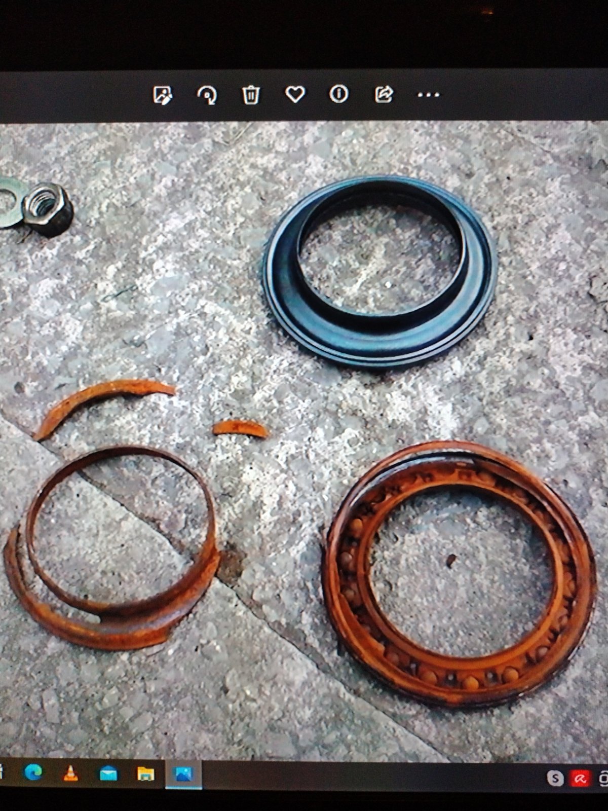

Sorry for terrible "point phone at monitor" picture, but just came across it whilst looking for something else.
This is quite how bad the 306's strut top bearings were, and still only really a noise rather than resistance felt at the wheel!
If I am doing anything front suspension related on a "new" (to me) car, then I'll usually consider changing these. Dead cheap (£12? From memory)
(But not changed my mind on earlier thoughts that is steering column related in your instance)
