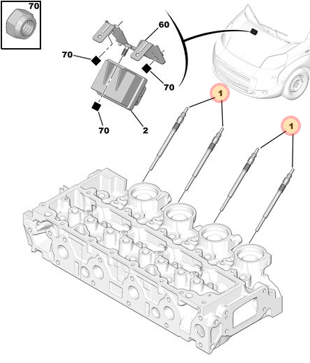

Re: Nemo 2010 1.4HDi Glow Plugs
Her you go:
Item (1) NGK, part: 5960F9, £31.16 (each)

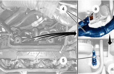

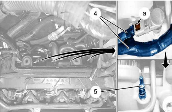

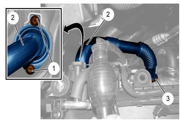

Yes, correct. You'll also need a plug removal tool.
Remove:
The bolts (/)
The clip (3) using circlip pliers.
The EGR connection pipe (2)
Disconnect the supply bar (4) at "a" and move it aside.
Remove the glow plugs (5) using the glow plug removal tool.
Remove:
The bolts (/)

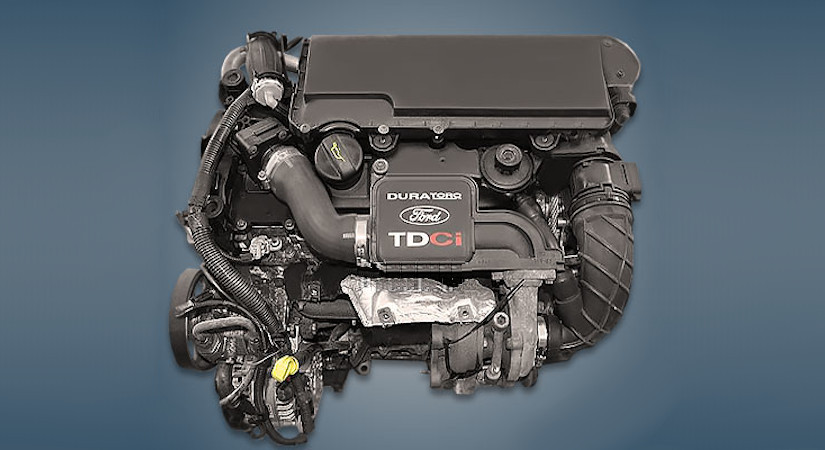

Does this engine have a specific name, just for searching purposes. Is it a Fiat engine, or a Citroen/Peugeot and is it shared across a few Citroen vehicles ?
Edit that, Ive just read its fitted in Ford Fiestas
https://mymotorlist.com/engines/ford/1-4-tdci/

You have a DV4TED engine.
There's nothing really Citroen about the Nemo, it's basically a Fiat as is the Peugeot Bipper. They're essentially all the same with cosmetic changes, but the engines can be different as well as the Head units.
The tool needs to be a long 6-sided socket for the glowplugs.
Yes the engine is used by Ford (Duratorq), Mazda, Fiat and PSA and even the DCi on Renault.
