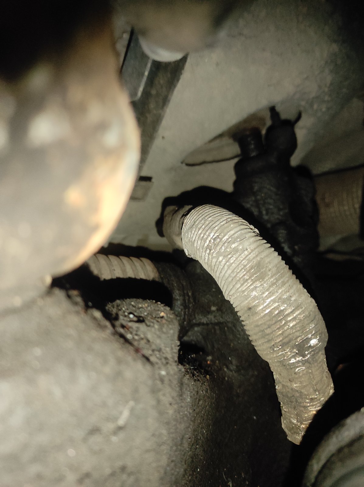

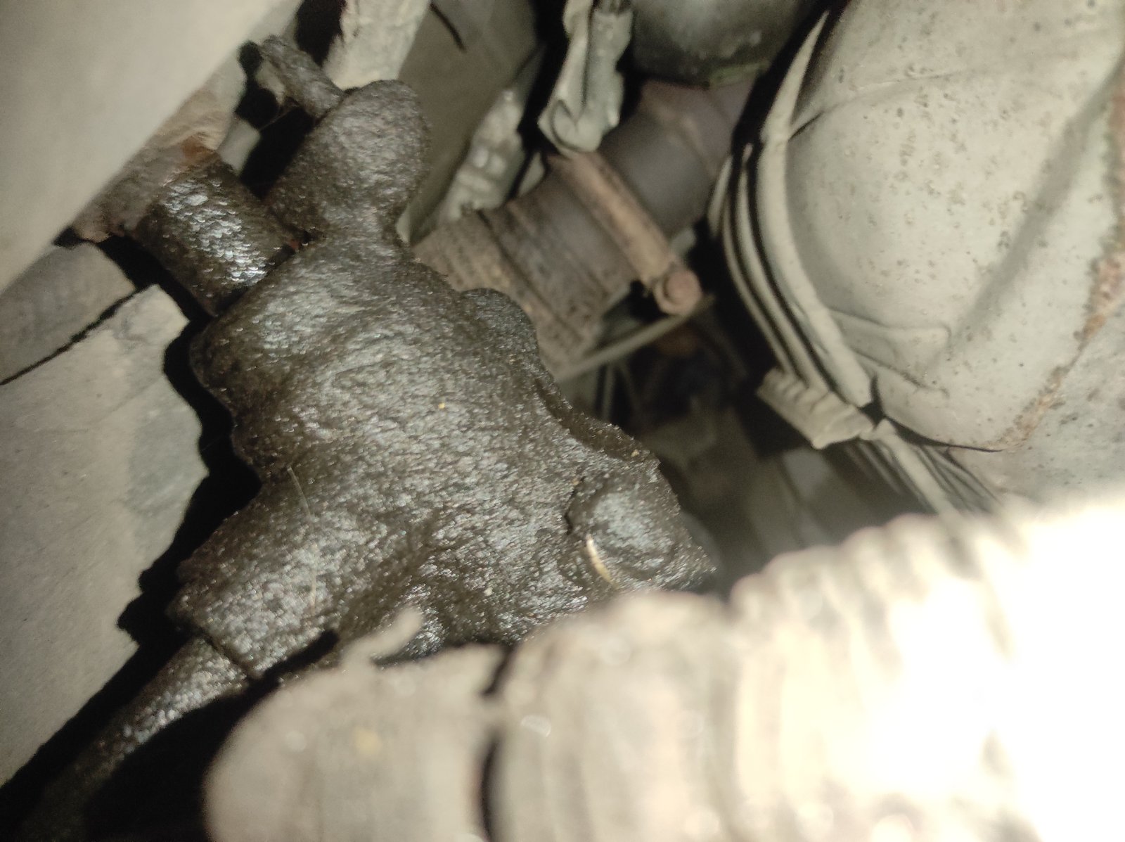

Hi lads is this as bad as I think it is or is it savable.do you think cleaning it up putting a sleeve on it and changing the seal would work.

darbuck wrote: 07 Mar 2023, 18:43 Hi lads is this as bad as I think it is or is it savable.do you think cleaning it up putting a sleeve on it and changing the seal would work.
Disclaimer / get my excuses lined up early: I've not yet had interaction with this steering rack issue or with speedi sleeves! So answer very much "based on theory"
I don't see why speedi sleeve wouldn't work - you could quite aggressively remove the rust as would not need to worry about the sealing surface. So suggested process as follows:
Rack off the car,
Pinion housing off the rack,
Pinion shaft out the housing, Don't worry about the crusty shaft dragged through the lip seal (as this seal has already failed)
Pinion shaft: angle grinder flap disk / twist knot wire wheel. Power file, etc = have at it. Suggest phosphoric acid/ Kurust or similar to neutralise what remains as best you can.
Belzona chemical metal product splodges on the shaft in approximate location of speedi sleeve.
Push speedi sleeve onto the shaft and wipe off excess Belzona before it sets.
(Let it set)
Paint rest of pinion shaft to slow down the rust?
New lip seal into pinion housing,
Reassembly of pinion housing.
Pinion housing back onto rack.
Rack back into car.
Obviously other steps like repair of the aluminium pipes, stop for a brew, etc excluded from the above :)

Hi Matt sounds like a plan I have the luxury of access to a lathe in work so might turn it down and then speedi sleeve. I have been reading the thread but I am only on Pg 24 it's a bit of a novel😂😂.I have been avoiding this problem with all the other issues this car came with.
