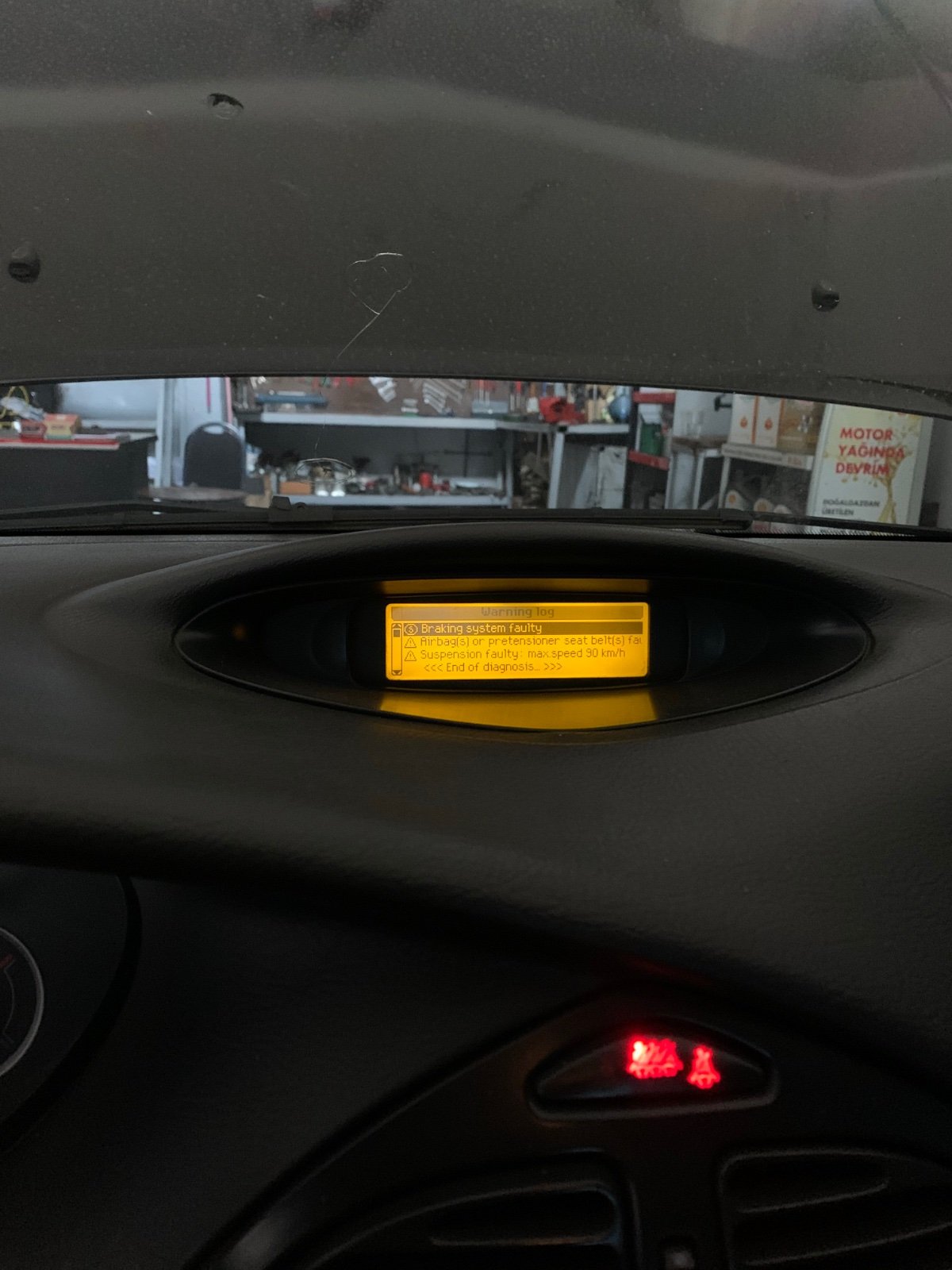

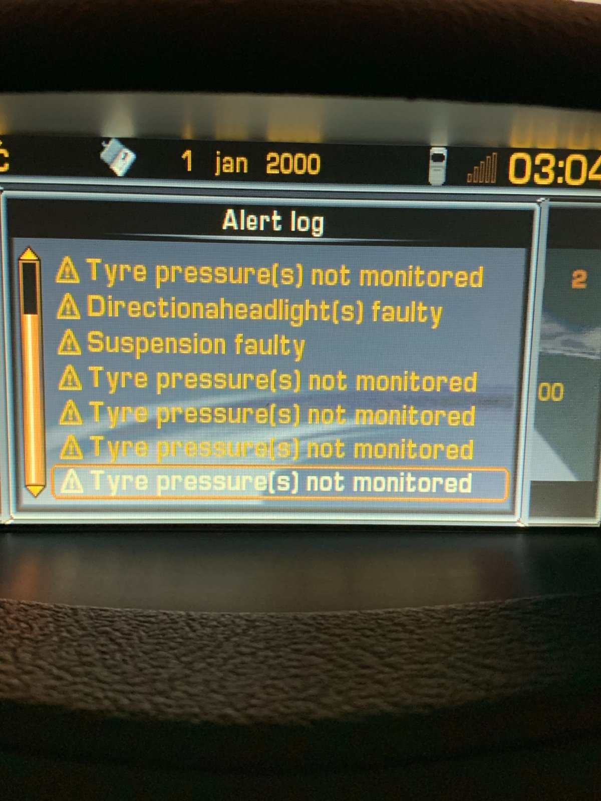

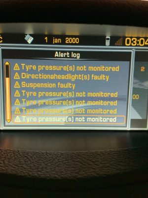

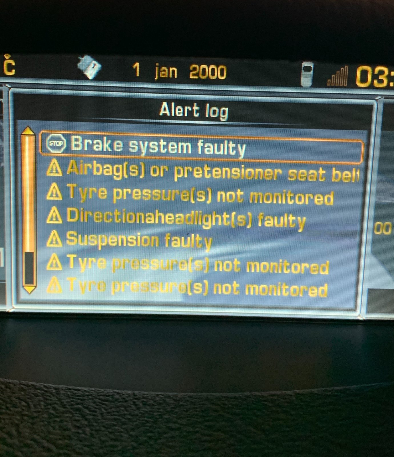

Help multiplex guys, I have a non start citroen C5 2.0 Hdi FAP 136 automatic 2006 , no cranking and no clicking on the starter, when turning the key to start the engine nothing happens only constant buzzing noise coming either from the alternator or from the suspension pump and relay that clicks every 5 seconds in the BSM, brake interlock not working, the imobilizer is ok because when i leave the key in the lock and open the door it knows that the key is still in the lock and gives a warning, i checked the fuses on the BSI and other fuses inside they are ok, checked the maxi fuses and the fuses on the BSM they are fine, battery is fully charged, i tried BSI reset and still the same errors return, on the navigation screen it shows many warnings: STOP Brake system faulty, !Aribag(s) or pretensioner seat belt faulty, !Tyre presure not monitored, !Directional headlights faulty !Suspension faulty, etc, now i know this faults are chained to the main cause of the fault but i can't figure out what could the main fault be,

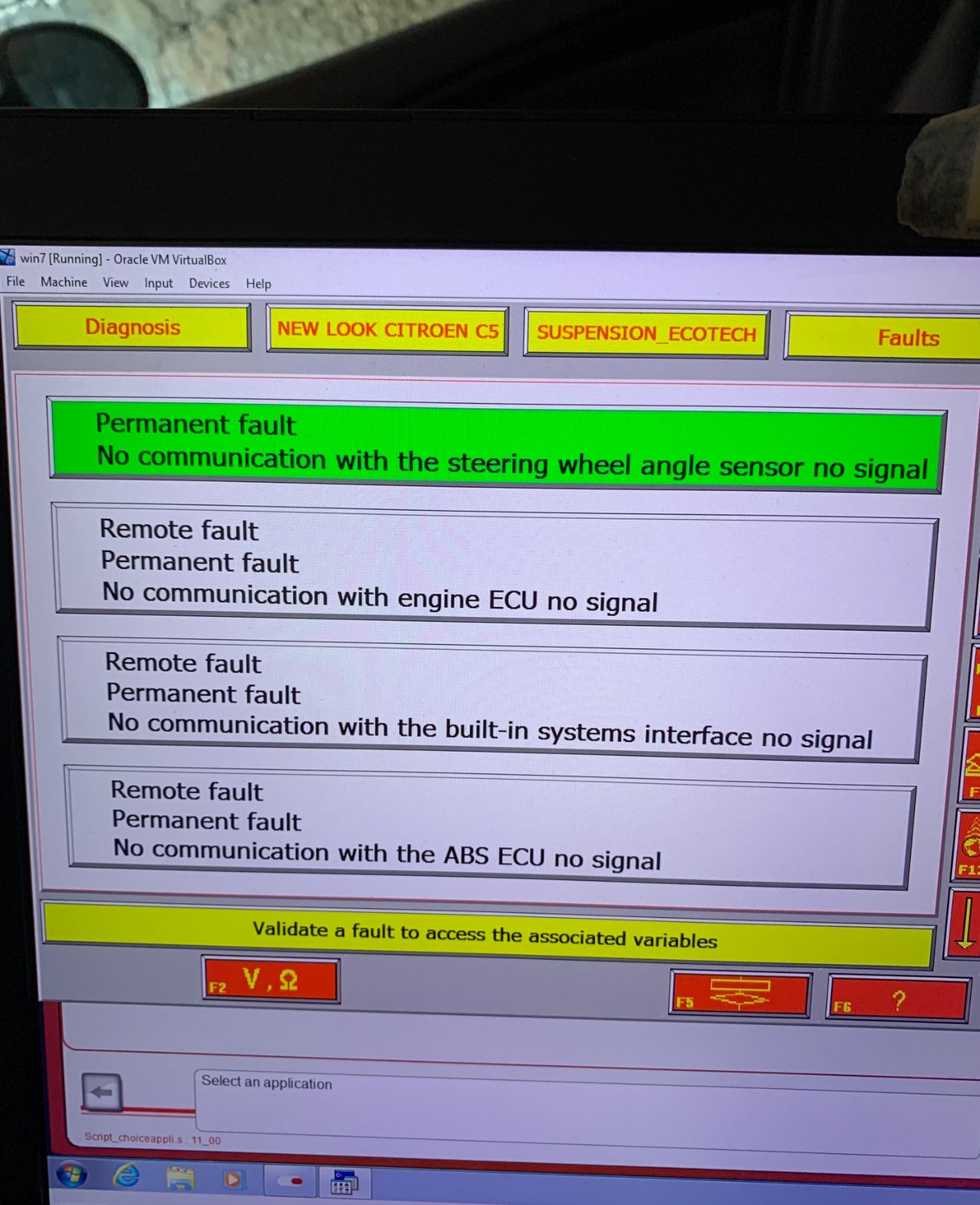

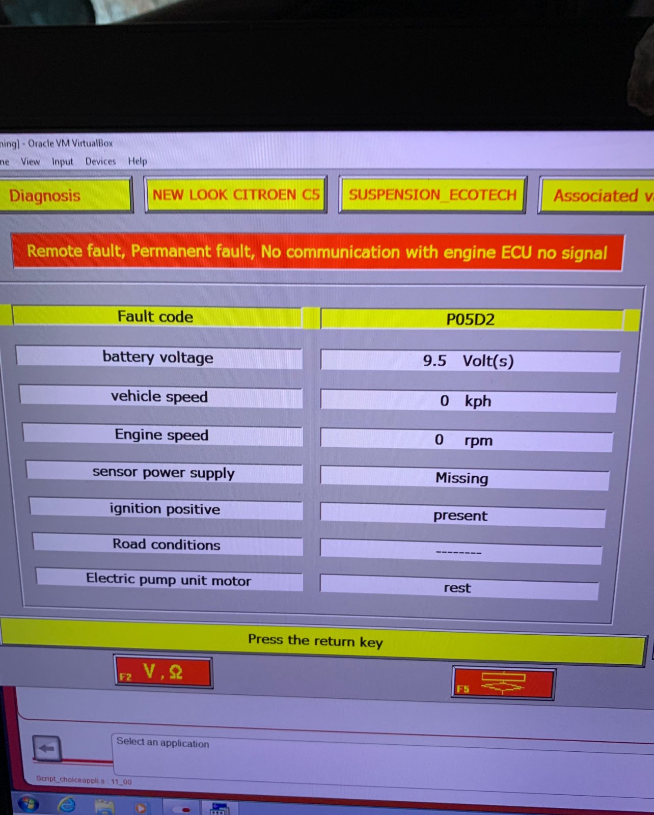

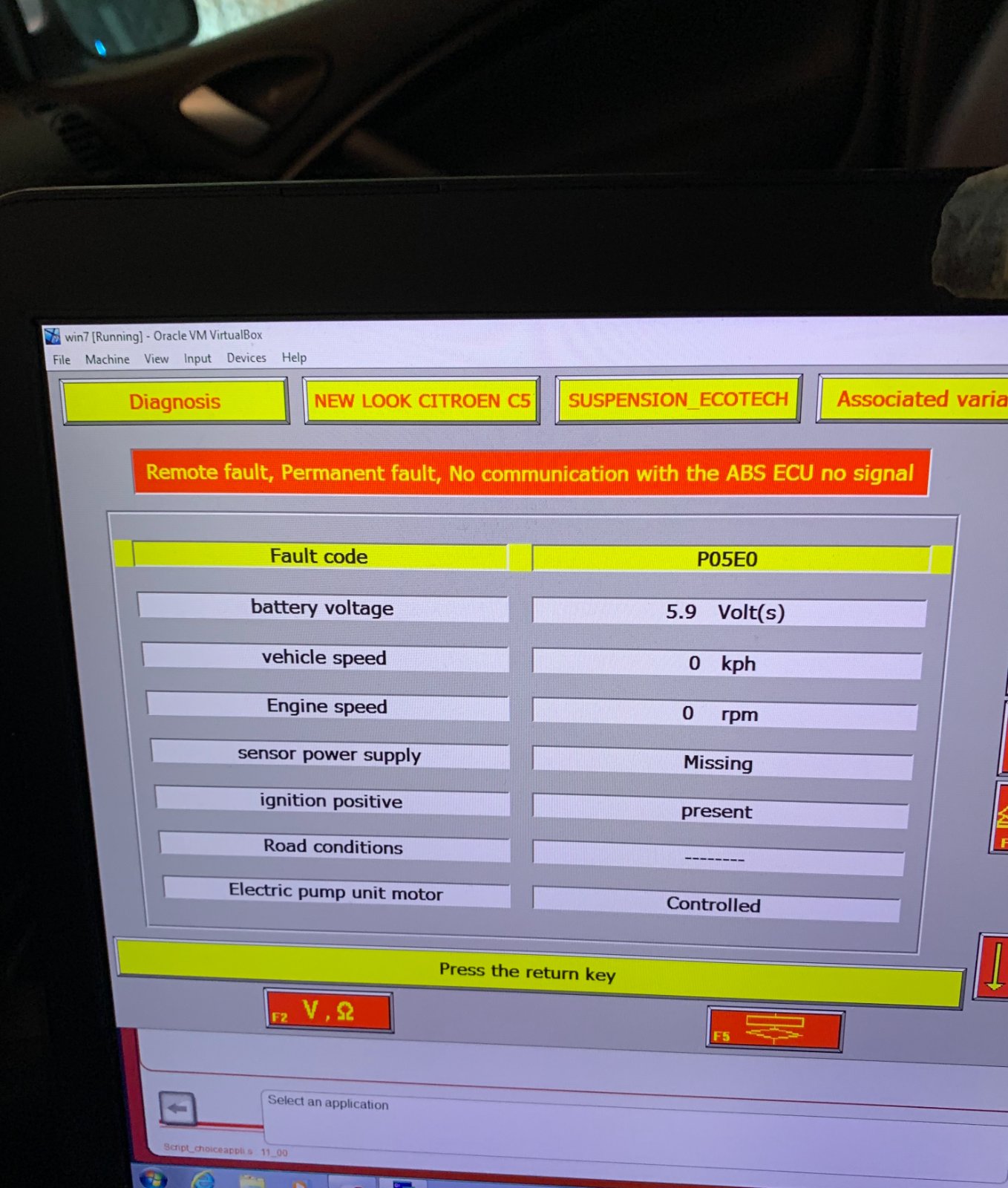

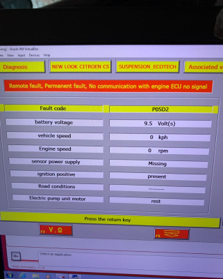

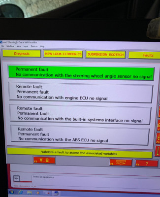

i did a Golbal test scan with Lexia and i have no comunication with the engine ECU in the others there are the same codes repeating it self i will upload some pictures if you can please help me solve this issue thank you,

First question has your Lexia ever spoke to the injection ECU previously? Fake interfaces are known to be hit and miss with Full CAN systems.

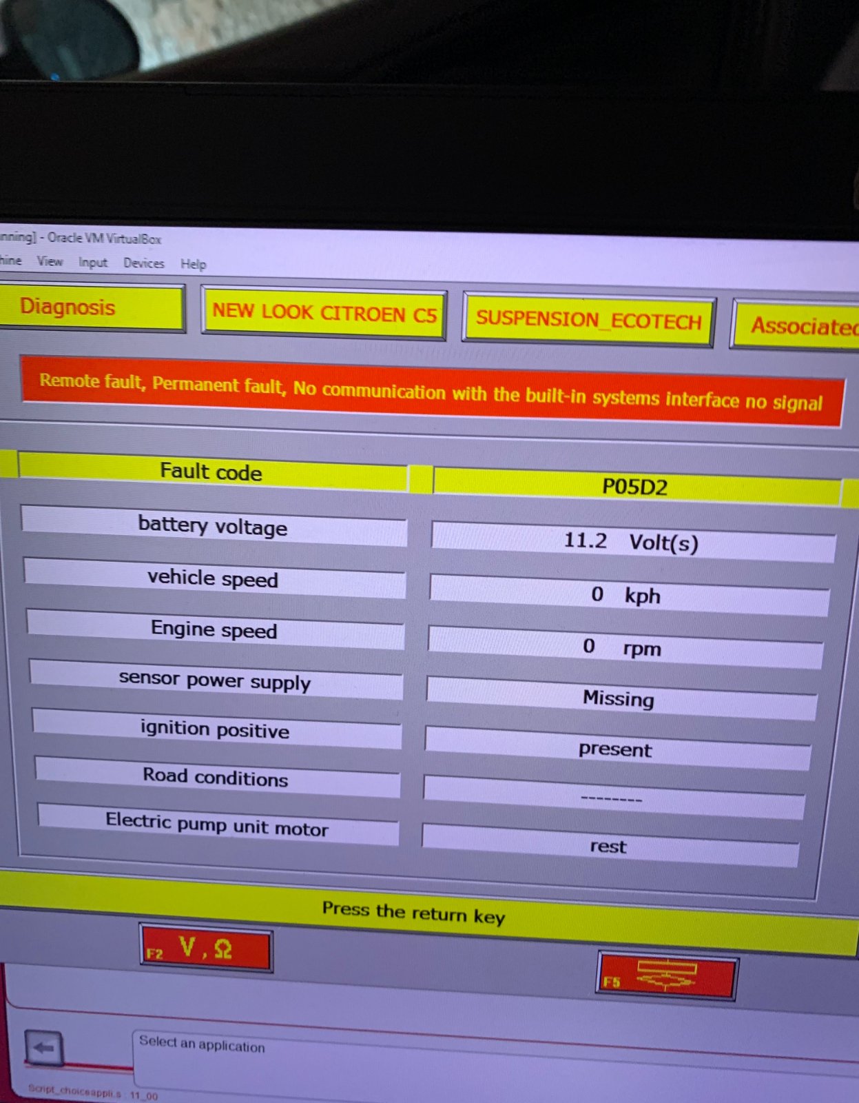

Is the battery actually OK? Reported voltages look suspiciously low in some of those shots.... Does it maintain over 12V when you switch on the ignition?

Battery voltage readings definitely suspicious - either poor battery or poor feed connections.
therefore not surprising you have the spread of odd faults

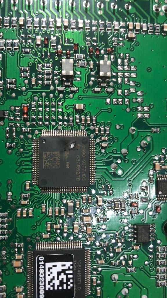

Abs beyni,entegre :(

Kayso wrote: 13 Feb 2023, 19:02 Image
That is one fried chip :bigcry:
Looks to have been VERY hot or voltage spike! Before replacing you will HAVE to find the cause! Test ALL connections. Make sure the multi-plug to the ABS module isn't damaged because that looks like a few pins/wires have short circuited and cause a major spike or short circuit....
