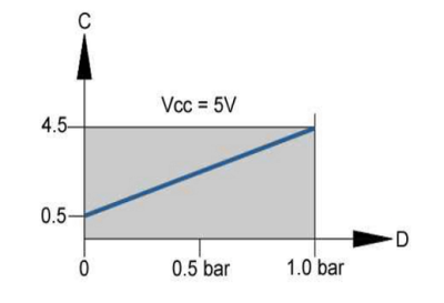

The sensor itself operates as follows:
The sensor consists of the following components:
Voltage supplied for a differential pressure of 0 bar: + 0,5 Volts (engine off).
Voltage supplied for a differential pressure of 0,9 bar: + 4,1 Volts (particle filter clogged).
"C": Sensor output voltage In volts.
"D": Pressure in Bars.
- Electronics to amplify the signal
- A sealed membrane
- The inlet pressure of the particle filter (upstream)
- The outlet pressure of the particle filter (downstream)

Well the voltage range on the sensor is only 0.5 Volts to 5V. You need to divide MBbar by 1000 to get Bar. So anything at 0.5 bar would show the filter 50% blocked for example.
