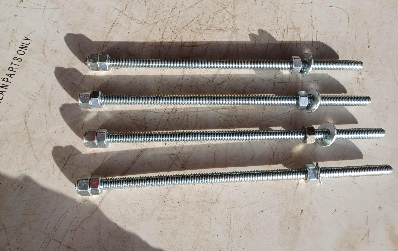

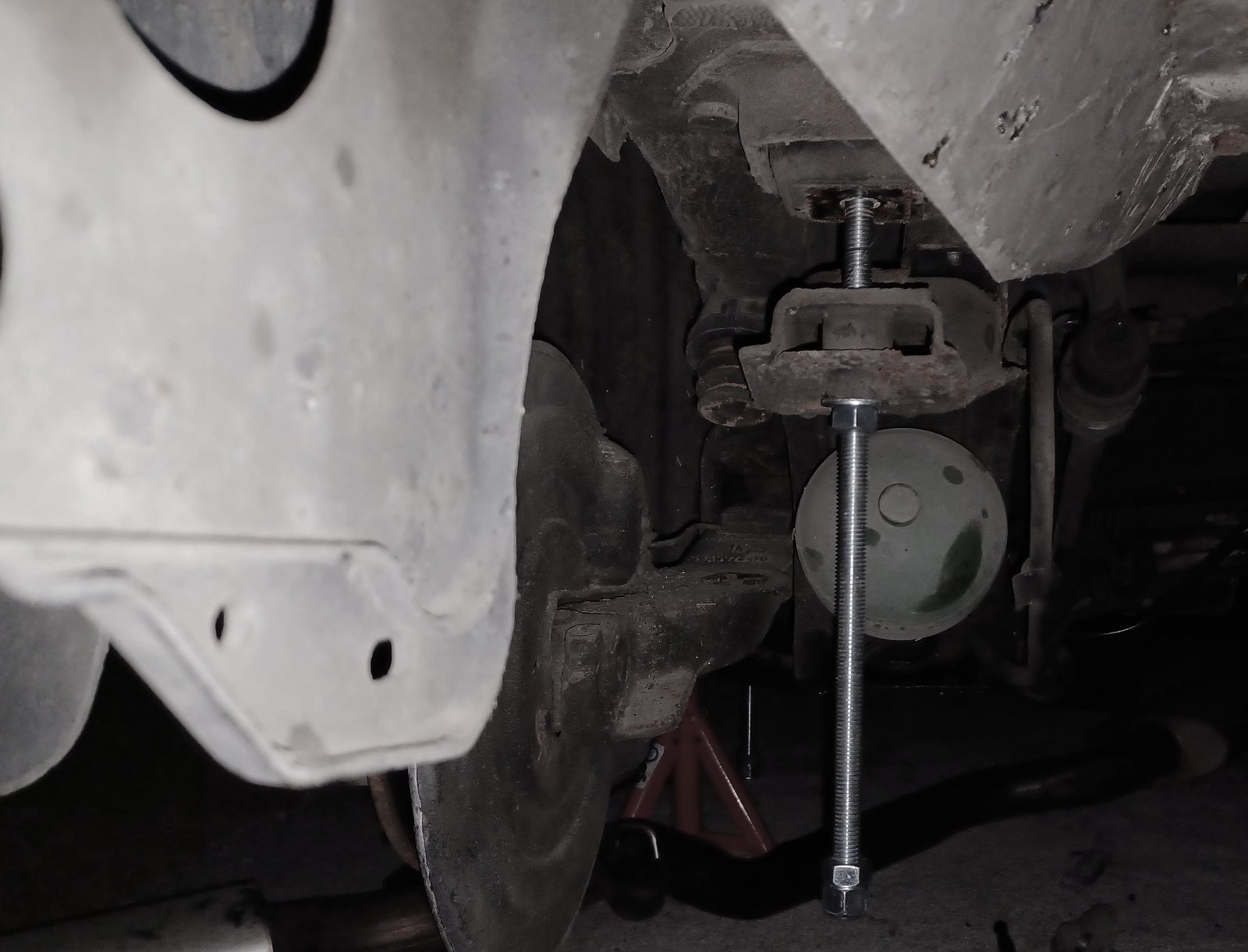

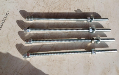

Made the required tools
Controlling the subframe when lowering it to work on the pipes fitted to the top surface (also ideal if you are the only one working on the car)
...SAFETY FIRST chaps

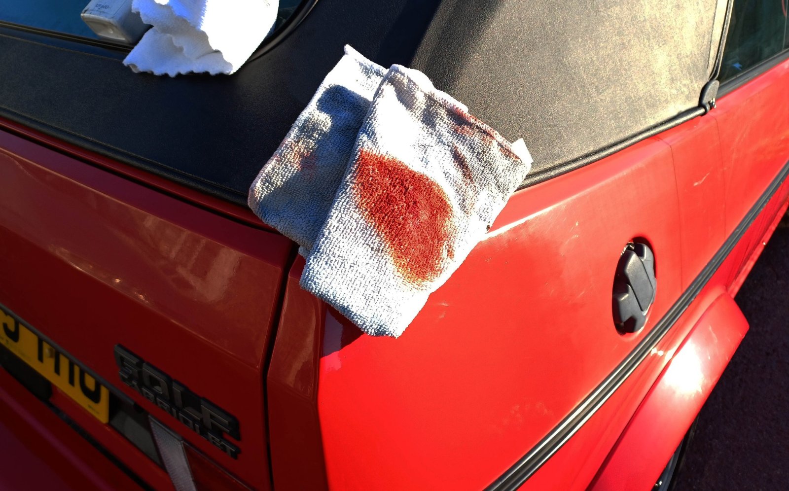

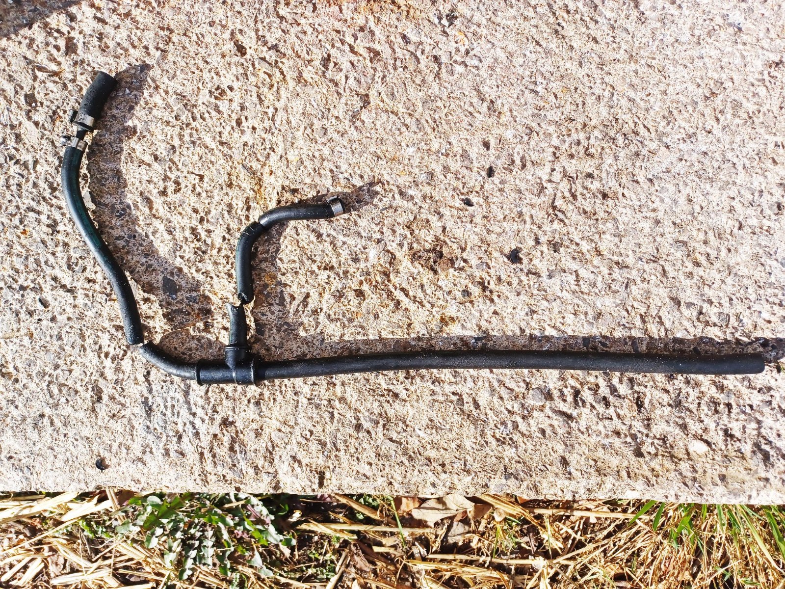

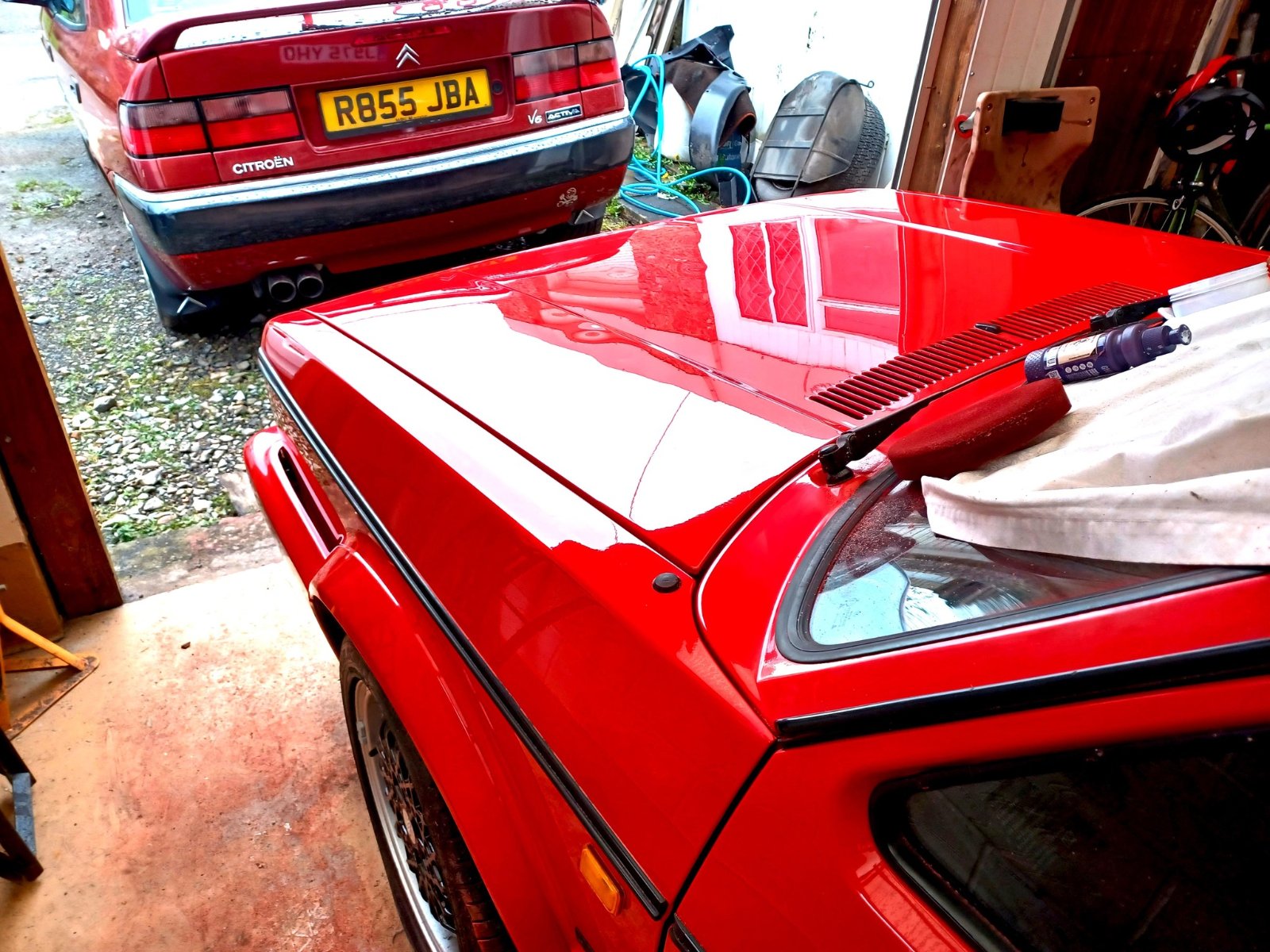

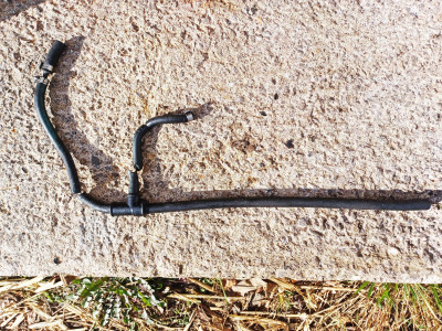

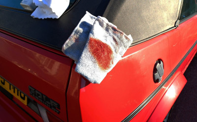

The result of using Bilt & Hamber Auto-Balm....fantastic stuff, especially when used in combination with their Cleanser/Polish.
And on the Activa, I think this might be the problem ...so that was BOTH electro valve returns leaking

Re: I am an Activaist-v6 and a 2.1Estateerr
Daffodil is looking gorgeous Alasdair
You sure that pipe is the cause of the problem
Looks OK to me apart from the air vents

Leak back lines now remade, sub-frame back up.
I took some time to add a thin layer of wax protection (B&H S50) to all body work and seams in those areas exposed by dropping the sub-frame (....just in case)

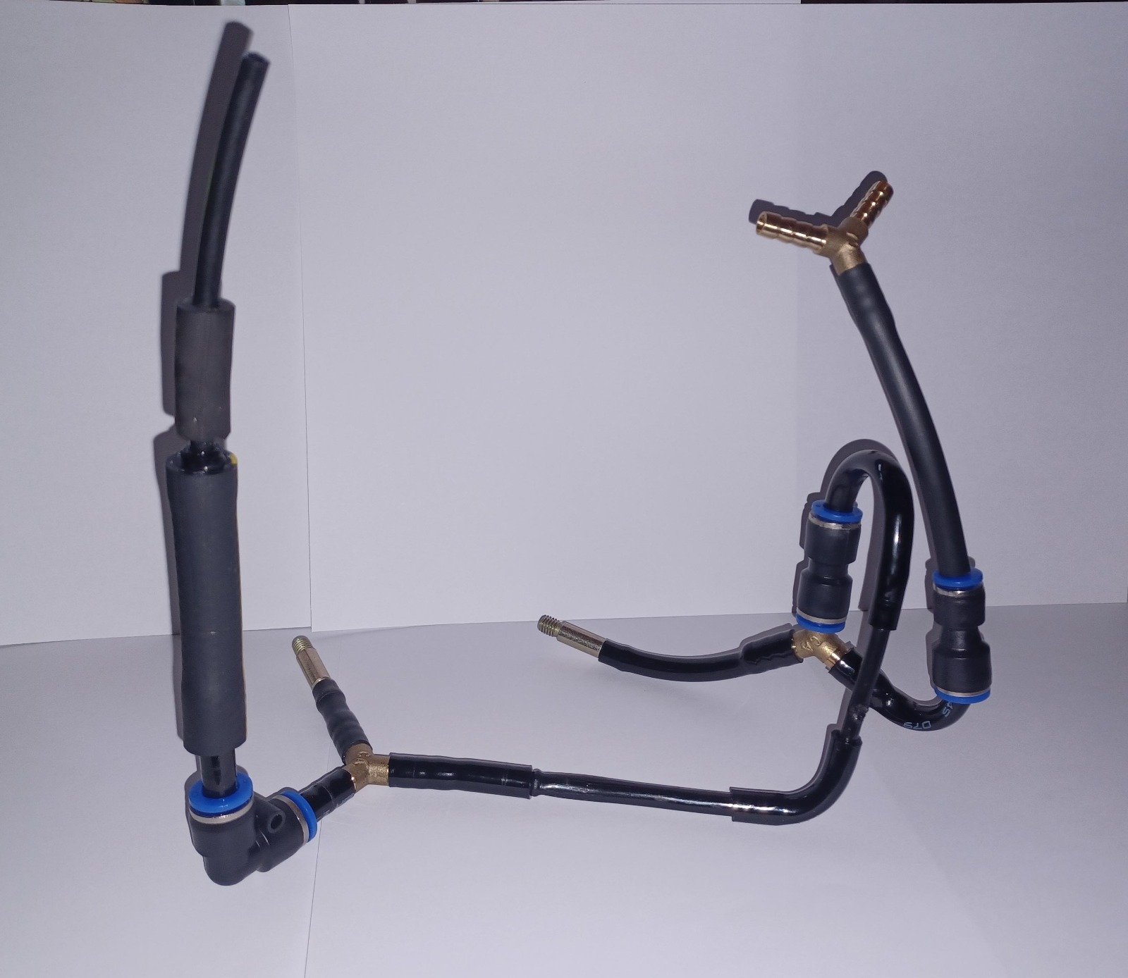

A funny looking pipe/seal/push-fit connector "soak" tester......to be filled with LHM and left.... 5 types of pipe, 4 types of connector and 4 types of seal material
That will probably achieve sentience and either crawl away in the night or attack you viciously when you are least expecting it.
- Posts: 55027
- x 8358
myglaren wrote: 12 Mar 2023, 09:40 That will probably achieve sentience and either crawl away in the night or attack you viciously when you are least expecting it.
Or else some arty-farty avant-garde gallery will snap it up and you'll be rich beyond your wildest dreams

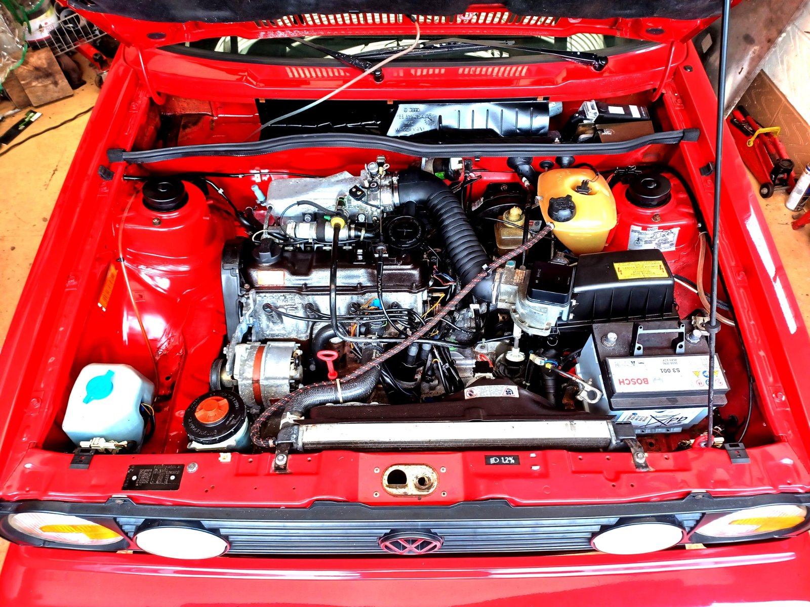

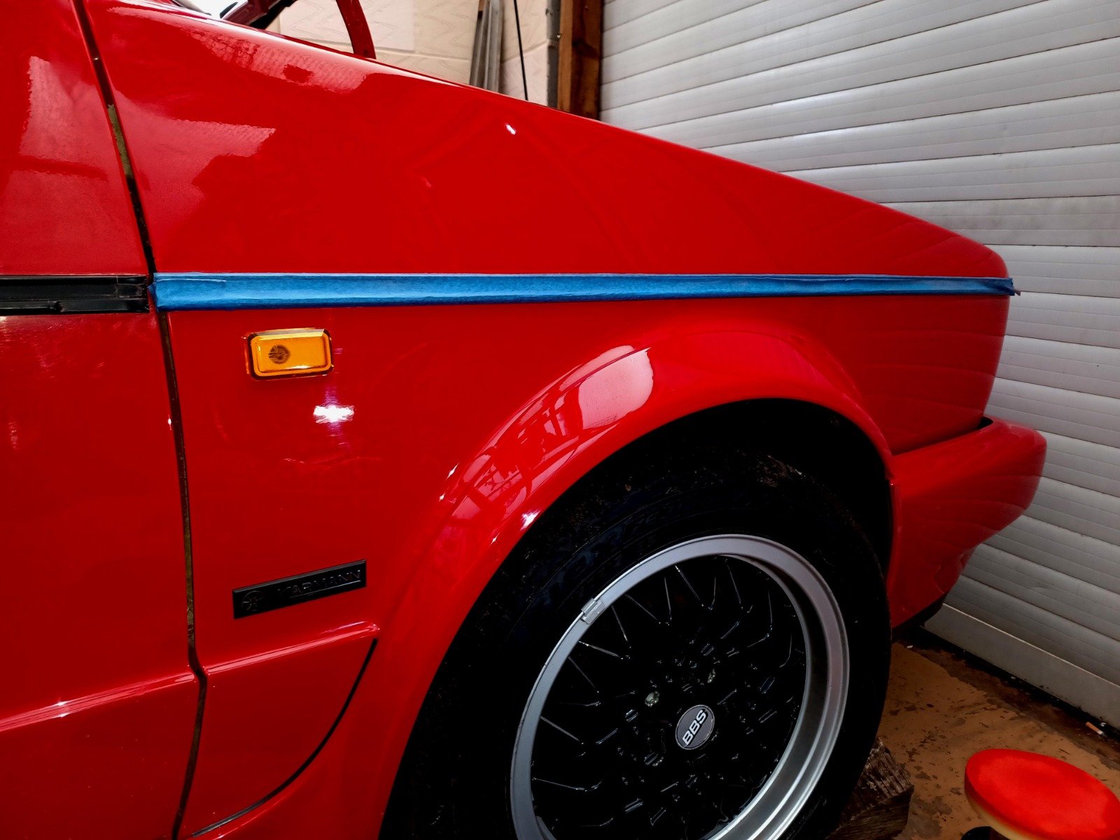

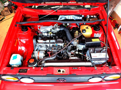

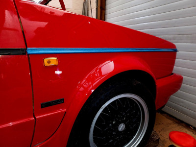

Well, not much to report on my Citroen collection......(Touch Wood, well a bloody big Oak tree) everything seems in order, no leaks, no miss-fires, no squeaks or knocks !
So, I have continued work on the (wash my mouth out !) VW Golf Cab. There is not one replaced nut, bolt or clip, this car is soooo original it is amazing !
The starting point............ . Still a fair way to go ........edges, around fitting, bumpers, some defects/chips to fix, interior to clean etc. Most importantly I am taking care to NOT --over-- clean/polish the paint as I want to keep the quality of the factory finish (not a re-spray type mirror finish)
I saw this Golf yesterday
It is bloody amazing... The photos don't do it justice... One of those rare cars that look better the nearer you get to it and better than any photo of it...
A real time capsule
You're doing a stunning job of it Alasdair
A real time capsule
