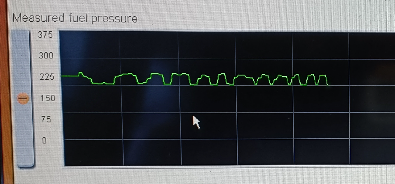

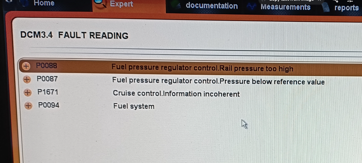

Well... I checked the codes again and no EGR codes have popped up. Instead it's all related to the high pressure fuel system. The fuel filter has been changed recently. Could be the fuel pressure regulator or still the injectors? The car has half a million kilometers under its belt.
P0088
P0087
P1671
P0094
P0088
P0087
P1671
P0094

There’s another possibility in that it may be the high pressure fuel rail sensor. These can fail over time although Citroen recommend not removing the sensor from the rail it can be done, but there can also be issues resulting so Citroen only sell the new rail with sensor already sealed. The best thing to do is to pop your VIN number up and I’ll have look at those fault codes as they relate to your specific engine ECU.

As you appear to have both low and high pressure errors, and the trace shows the pressure wandering about, I would be tending more towards the actual regulator (which is part of the HP pump I think) rather than the sensor.

Here are some pointers based on those codes:
| Fault Code: | P0087 |
| Description of Fault: | High pressure fuel regulation: The measured rail pressure is too low in relation to the set point. The ECU detects a difference of 180 bars to 250 bars for 3 to 6 seconds between the rail pressure set point and the measured rail pressure. |
| Conditions for Fault to clear: | Driving for 5 minutes with several full load accelerations for 10 seconds. |
| Downgrade Modes whilst Fault is active: |
| Symptoms: |
| Suspect Areas: |
| Fault Code: | P0088 |
| Description of Fault: | High pressure fuel regulation : The measured rail pressure is too high in relation to the set point. The ECU detects a difference of 180 bars to 250 bars for 3 to 6 seconds between the rail pressure set point and the measured rail pressure. |
| Symptoms: |
| Suspect Areas: |
| Fault Code: | P0094 |
| Description of Fault: | Fuel system : Incoherence of the fuel pressure measured with the flow regulator too open. Excessive under-capacity of the injection system to provide the pressure for the flow in progress Reduction of the torque necessary for maintaining the pressure above 125 Nm for 2 seconds Conditions of activation of the diagnostics: Engine hot, running between 1750 and 4500 rpm with strong injected flow |
| Conditions for Fault to clear: | Driving with the engine hot for 5 minutes with several accelerations under full load for 10 seconds. |
| Symptoms: |
| Suspect Areas: |
| Fault Code: | P1671 |
| Description of Fault: | Cruise control: Reference speed outside the tolerance. |
| Conditions for Fault to clear: | Ignition on |
| Downgrade Modes whilst Fault is active: | - |
| Symptoms: | - |
| Suspect Areas: | - |

So the next suspect would be the pressure sensor or the injectors. Fuel rail pressure is still fluctuating.
