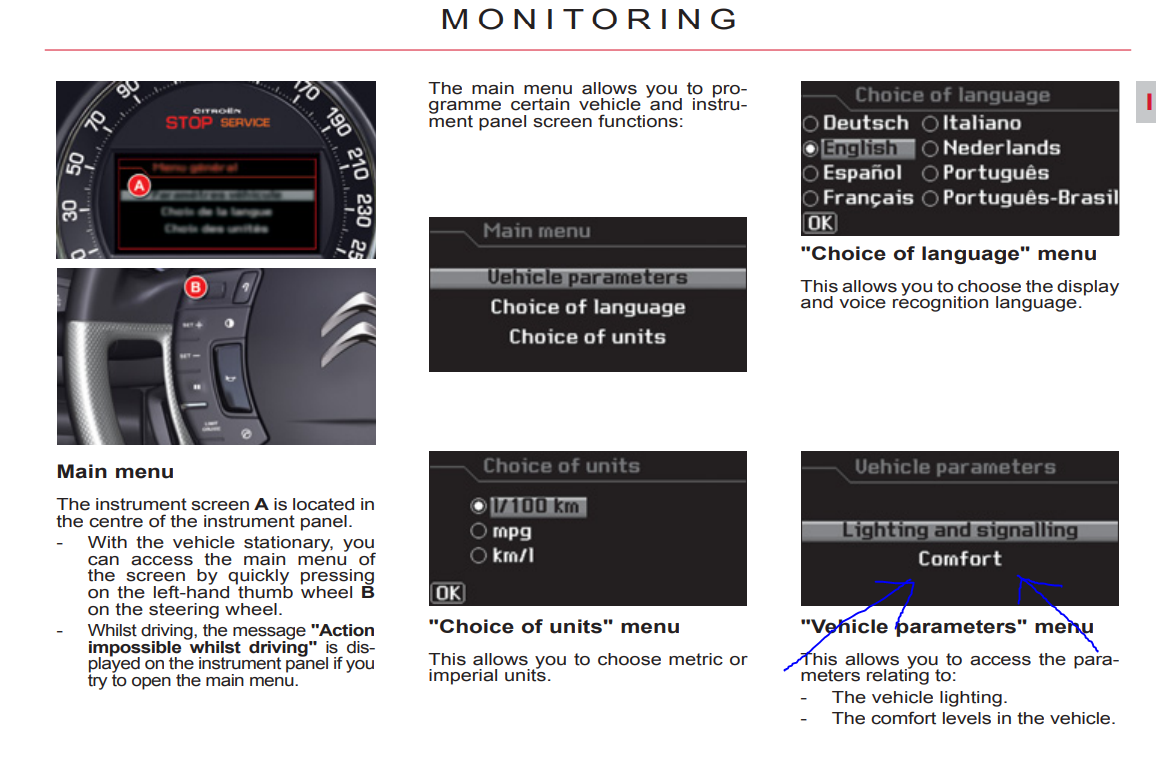

For example. cancel the automatic drivers' seat retraction (the 'Welcome' function), as I often use the vehicle with the rear seats down. There are other irritations, but if I can learn to change mone parameter .....!

Right - forget the Head unit - that is not done from there. It is done as I said from the instrument panel menu behind the steering wheel.
Refer to my previous post above regarding page 27 of the manual. Remember the car must not be moving to do this. Only then can you activate the menu by pressing the left hand button wheel on the steering wheel. Navigate to the COMFORT option shown where I have highlighted in Blue Arrows. Select this option and press the wheel button on COMFORT to get to the options to turn the driver's welcome function on or off.
Click the Image to Magify

Many thanks, Marc - that did indeed crack the problem. I must be getting past it, getting confused between screens, but clear enough on re-reading the instructions!!
