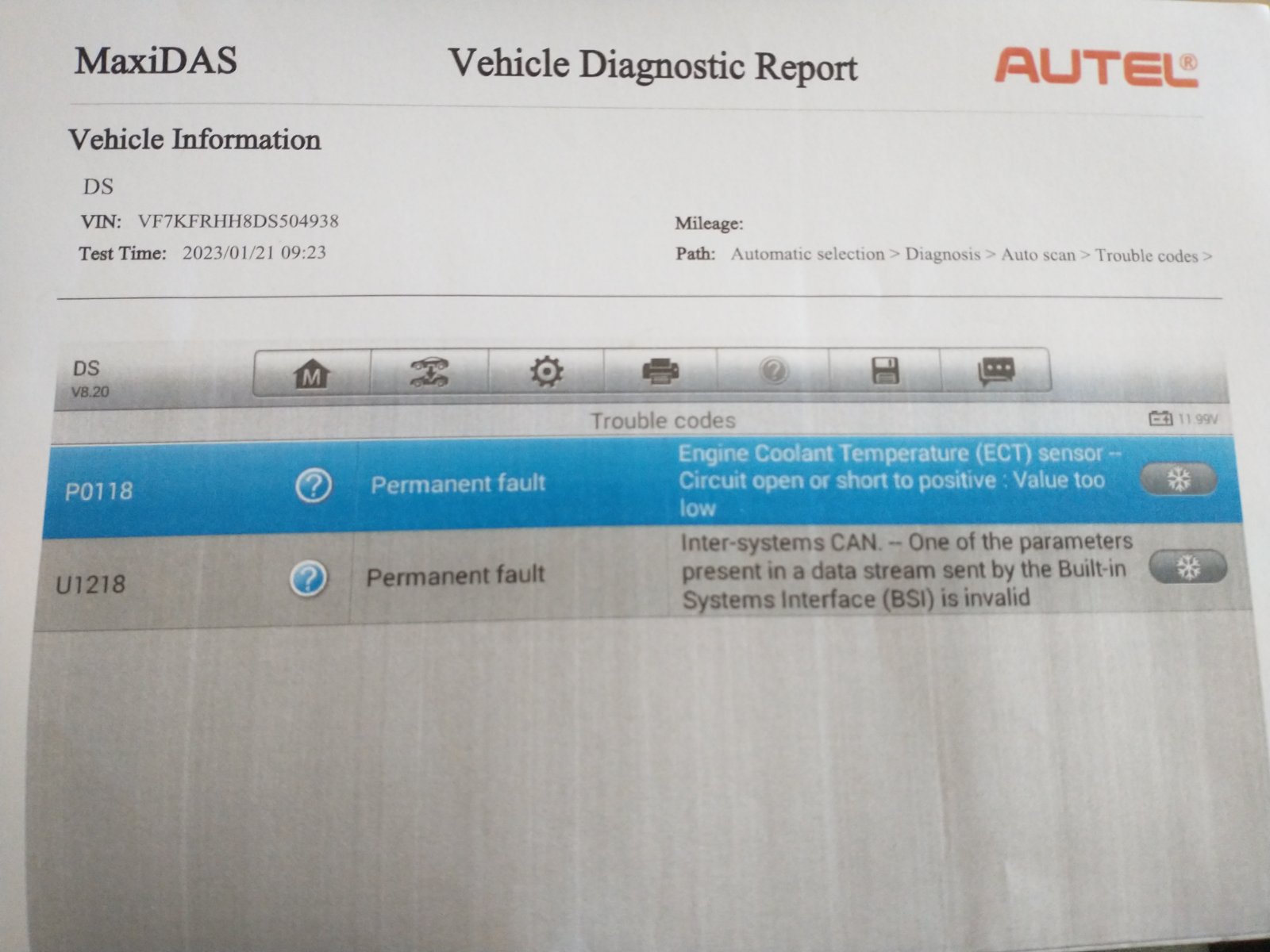

All it says on the report is.
Inter systems CAN-one of the parameters present in a data stream sent by the BSI is invalid.

The P0118 code says-
engine coolant temperature sensor circuit open or short to positive.

Ok, so that's no good to me unfortunately as I can't help you with aftermarket diagnostic tools. If you had used the proprietary diagnostic software like Diagbox, it would provide the context of the fault code, in other words, when conducting a diagnostic scan, the fault code would be shown against the specific ECU that is reporting the fault.
As it stands and as I've said in my previous posts, U1218 is a fault on the data network, but we can't tell which system ECU is reporting it as CAN networks link many ECUs together in the vehicle. So until you resolve this fault, you need to be careful about fixing other faults - as they may a symptom of the U1218 data network / comms fault.
