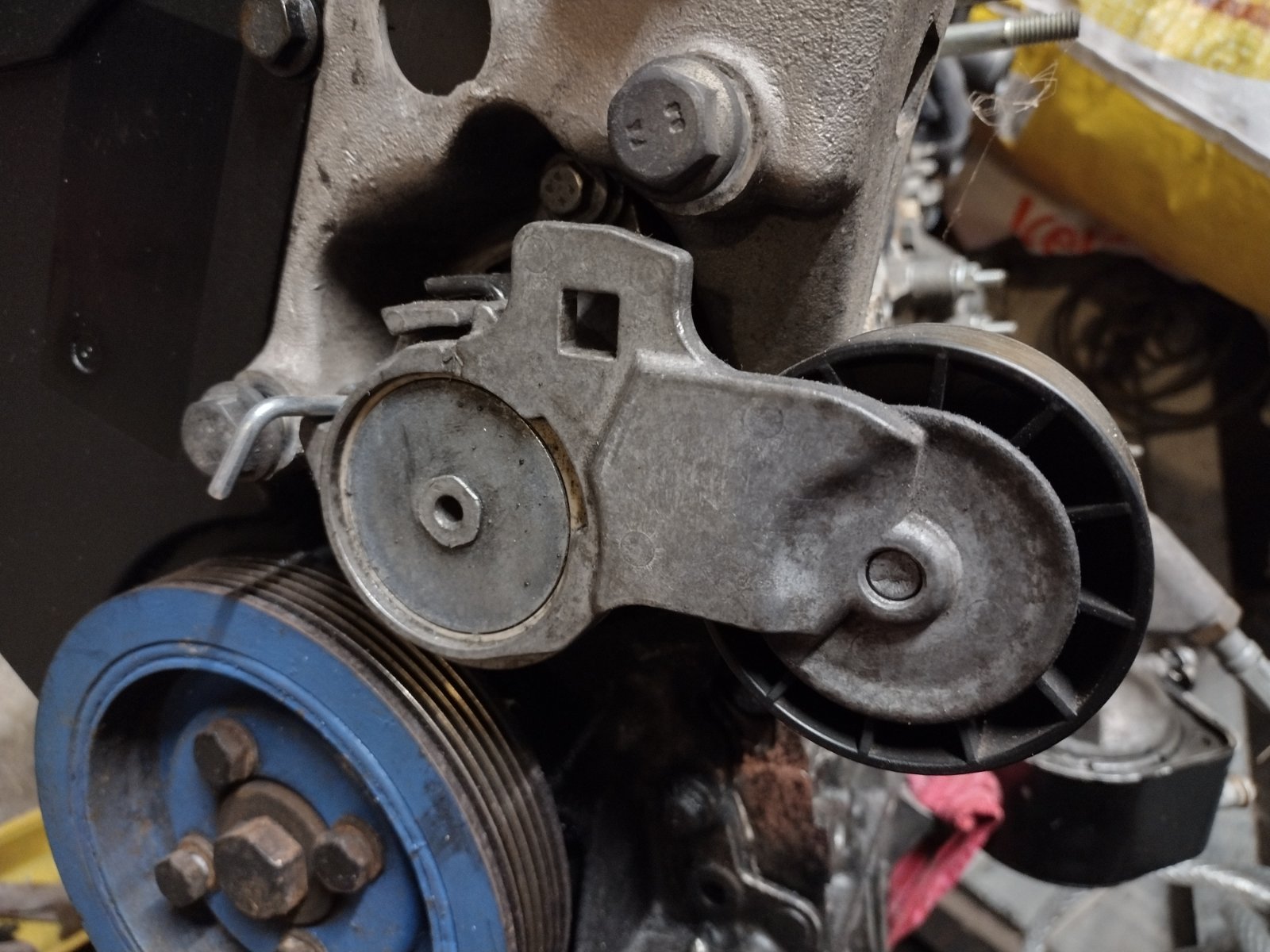

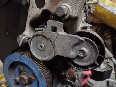

This is the auxiliary belt tensioner on the EW10A (circa 2008, ex-307) the tensioner is moved by use of the square as can be seen. I think it suits a 3/8" square drive (medium sized ratchet) but can double check tomorrow morning for you.

Thanks for reply and that's a great pic.
Working from top of engine will be an easier (hopefully!) repair.

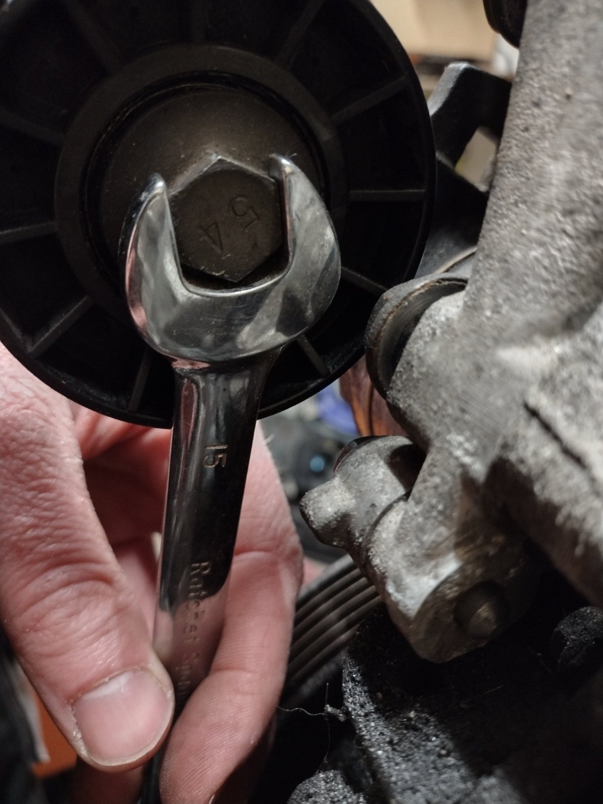

This style of auxiliary belt tensioner:
The bolt in centre of the pulley itself, 15mm head and anticlockwise thread.
Think it will have some Loctite on it - mine does/did

- Posts: 4948
- Joined: 25 Apr 2022, 09:03
- x 2156
Re: Alternator belt, release tension.
Nope, that would be a normal thread.
I mean it's a reverse thread, so you will need to turn it clockwise to loosen
